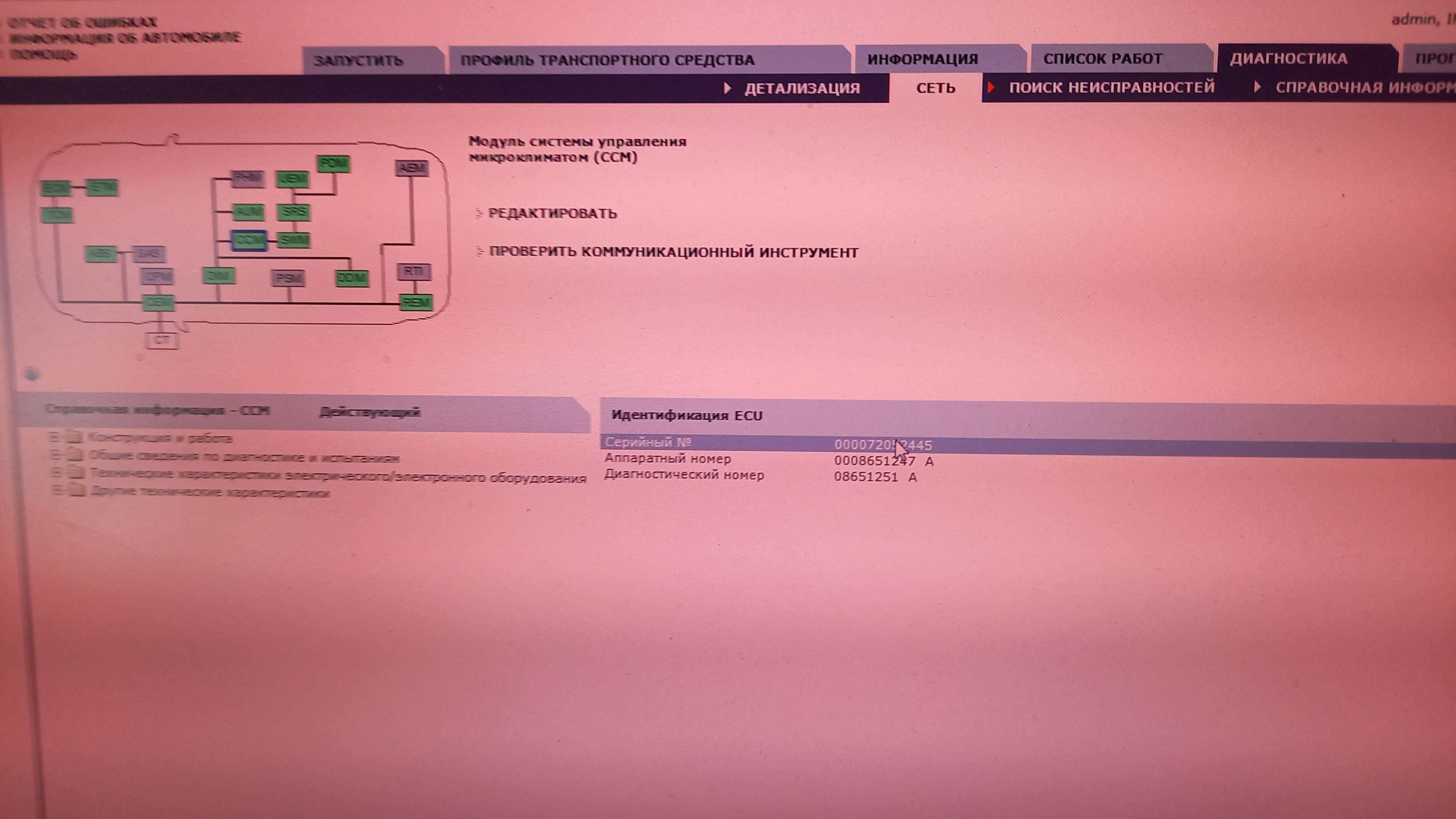

Alucard666
Posts: 5
Joined: 23 May 2021, 13:22
Year and Model: 2001
Location: Russia
Post by Alucard666 »
RickHaleParker wrote: 05 Jul 2021, 14:50
Alucard666 wrote: 05 Jul 2021, 07:28 Should I reprogram CCM?
Not so fast. Go to Diagnostics/Network. Is VIDA showing any communication with the CCM?
I think hardware communication is OK, in VIDA I see green CCM and can read HW, SW numbers. Also I can read FAN speed and internal temperature.

Alucard666 wrote: 12 Jul 2021, 06:46 I think hardware communication is OK, in VIDA I see green CCM and can read HW, SW numbers. Also I can read FAN speed and internal temperature.
What is the Volvo Part Number on the CCM?
Also get the chassis number. Which is the last six digits of the VIN number ( Vehicle Identification Number ).
Post both here.
CCM ( AKA E.C.C. ) Celsius .
VPN 8691950 Chassis -314999
VPN 8691876 Chassis 315000-425139
VPN 30782694 Chassis 425140-
