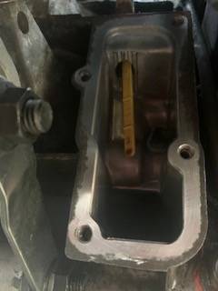

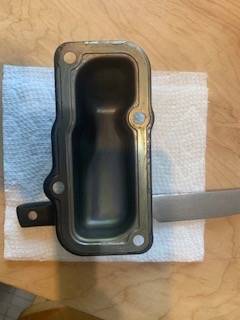

I managed to remove the small metal pocket cover to the transmission that encases the dip stick. It had a leak that I was able to stop with a small dap of solder early this summer, but after doing that another pin-sized hole appeared just below the one I closed up! I was able to find a junkyard replacement that seems in decent shape. With the balmy weather we are having (50 degrees F in mid-Dec!), I thought maybe it's time to replace that cover.
Well, let me tell you...I hope I never have to do something like that again!

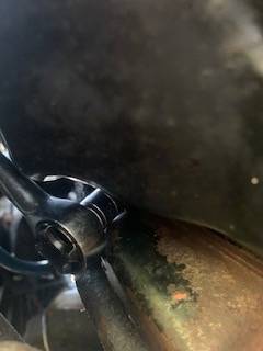

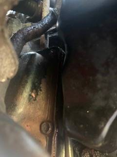

To gain access to the four bolts holding the cover, I had to remove the transmission mount, and remove the bolts holding the transmission oil cooler line that feeds into the transmission adjacent to the cover! Sounds easy enough, but to get to the bolt holding the cooler line about mid-way to the motor, I had to create more access...removed the battery, the battery tray (and all the parts underneath the tray), the bolts holding the dip stick tube in (without removing the entire tube), one of the turbo hoses leading to the bottom of the condenser, and a few other air/vacuum hoses! My goodness, what a project!
I cleaned off the cover's mating surfaces (the replacement cover and the part of the transmission the cover attaches to (reminded me of cleaning the cylinder head before applying new gasket material!!). My primary concern was being able to get the bolts back in once I had the cover in place...a rightly so...it seemed to take forever. Had to use a quarter inch drive with a 10mm socket and concort my arms in front of and between the subframe and other hoses and electrical harnesses so I could actually hold the ratchet, and then hold the socket so it would tighten the bolt, especially the very most top bolt. Without any tension, the socket goes in the same direction as the ratchet - forward and backward without any tightening action! The other three bolts were easily inserted and tightened. What would have helped was a quarter inch wobble extension, but I have never seen one of those:)
So, my question is....how much time should I give the gasket material time to dry...hours or a day(?) before adding fresh transmission fluid?
Pics below: dip stick Here is the position of the ratchet!!
In the above pic, the top most bolt can hardly be seen, but it's there, dark, oily covered, just below the dirty looking oil cooler line!
Very tough to reach, remove and/or install!!

For gasket material, I used Permatex anaerobic gasket maker - kind of reddish - pink in color.

What does the sealer recommend? I'd go by that. Some anerobic products never actually harden fully so they can fill any slight surface imperfections. Without knowing the sealer you have used, I know some here have used the Permatex product so I will leave any shortening of time to recommended to them.
Good luck and well done tackling this one! I did not envy you having to tackle this one!
