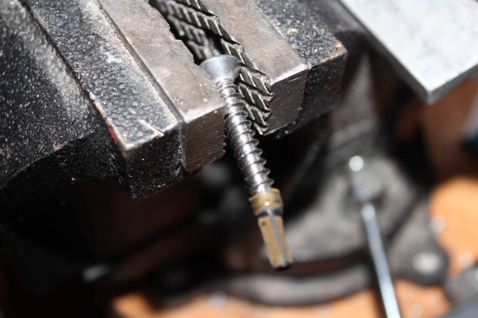

The fuel injector kit (o-rings, filters, pintle caps) I purchased came with the right size screw to remove the little filters. It worked well.packetfire wrote: 16 May 2022, 06:04 I have seen several mentions of this tool, but no photos, and no idea if a generic tool like this one:

That is how mine were done as well. Worked with no difficulty on 3 sets I have done.

Do you have a hole-size gauge to say what size wood screw that is?
