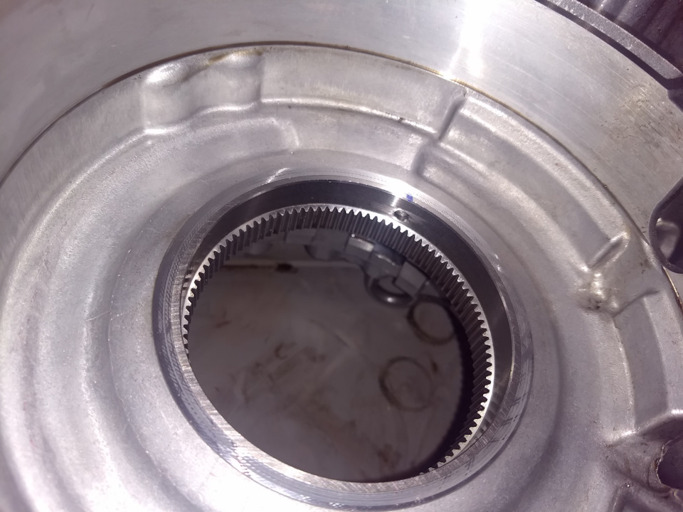

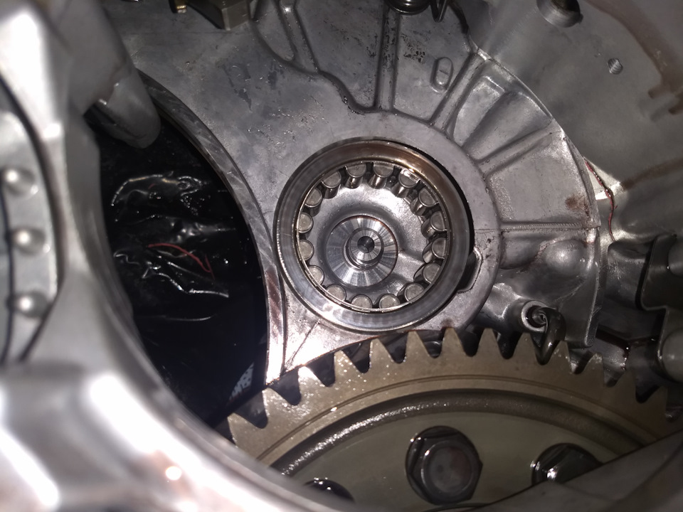

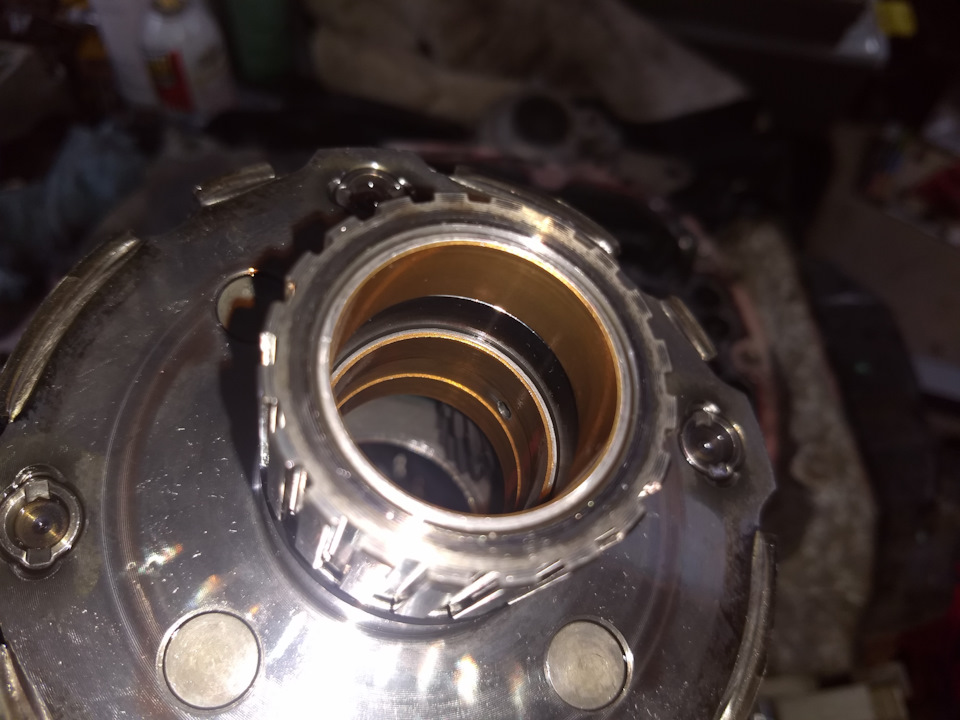

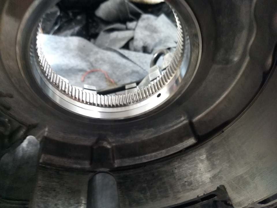

Lubegard has friction modifier, which eventually wears out. Keep adding it or flush the transmission with ATF. Volvo ATF is richer in modifiers than most of compatible aftermarket ATFs.
R-D, D-R bangs are most commonly a wear in shaft splines and differential satellites.
Engaging and disengaging coast clutch can be both valve body and mechanical wear in transmission casing.
This worn leap is responsible for the bang when transmission's torque sign is changed (coast/no coast, R/D):
If left untreated, it causes this bushing spun out (still good on the picture):
And this:
The cure is sleeving the casing:
The mechanical part has a few more common wear places.
tl;dr: while a new valve body will fix a lot of issues, a proper transmission rebuild is necessary to cure most of everything.
