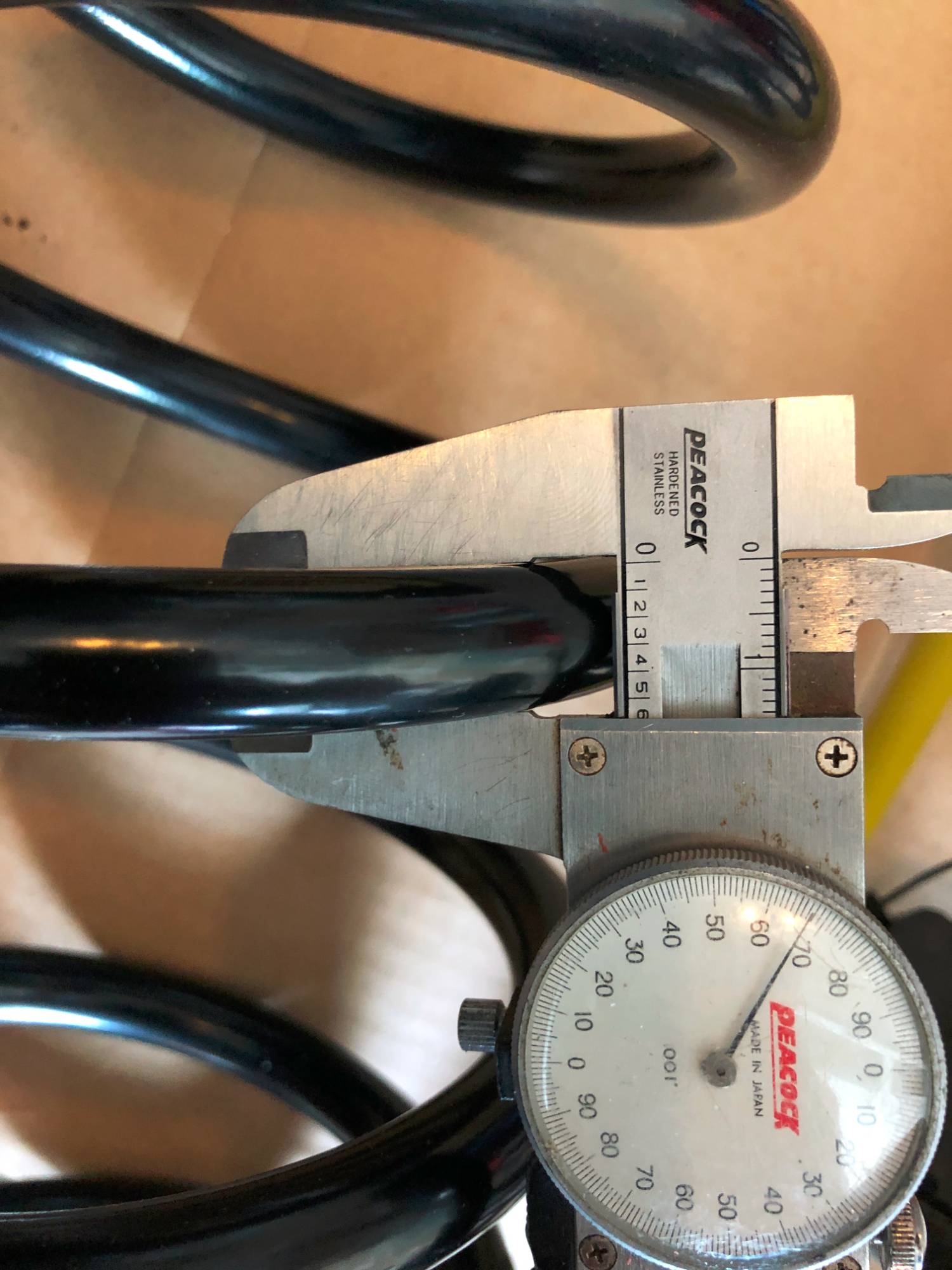

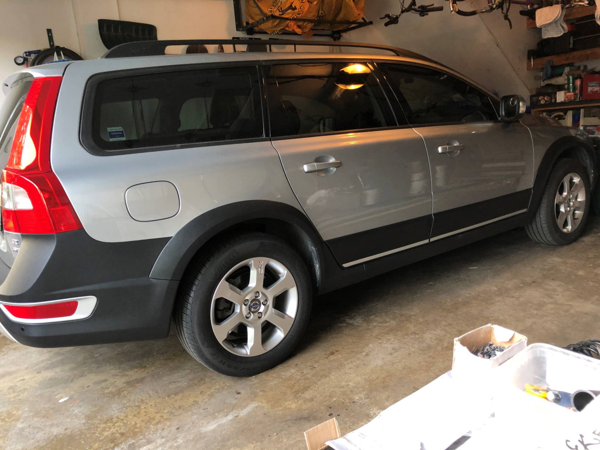

After driving the car with reverse rake look for sometime, I finally decided to re-install both rear springs this summer with aftermarket springs from Lesjofors, and sure enough, the aftermarket springs are about 1 inch taller than the OEM springs I replaced earlier and it made the car look level again. Now, did the rear OEM springs sag or was Volvo’s database wrong? It is no longer relevant in my case, the only thing that matters is my 2011 3.2 XC70 is now level again. It spears the correct rear spring dimension for MY2011 3.2 XC70 is 14 inches tall and coil thickness of 14 mm (0.55 inches). The oem spring I replaced was 31300140 and it measured just over 13 inches tall.

thickness of new aftermarket spring which is the same as oem spring
side view of the car with aftermarket spring installed
