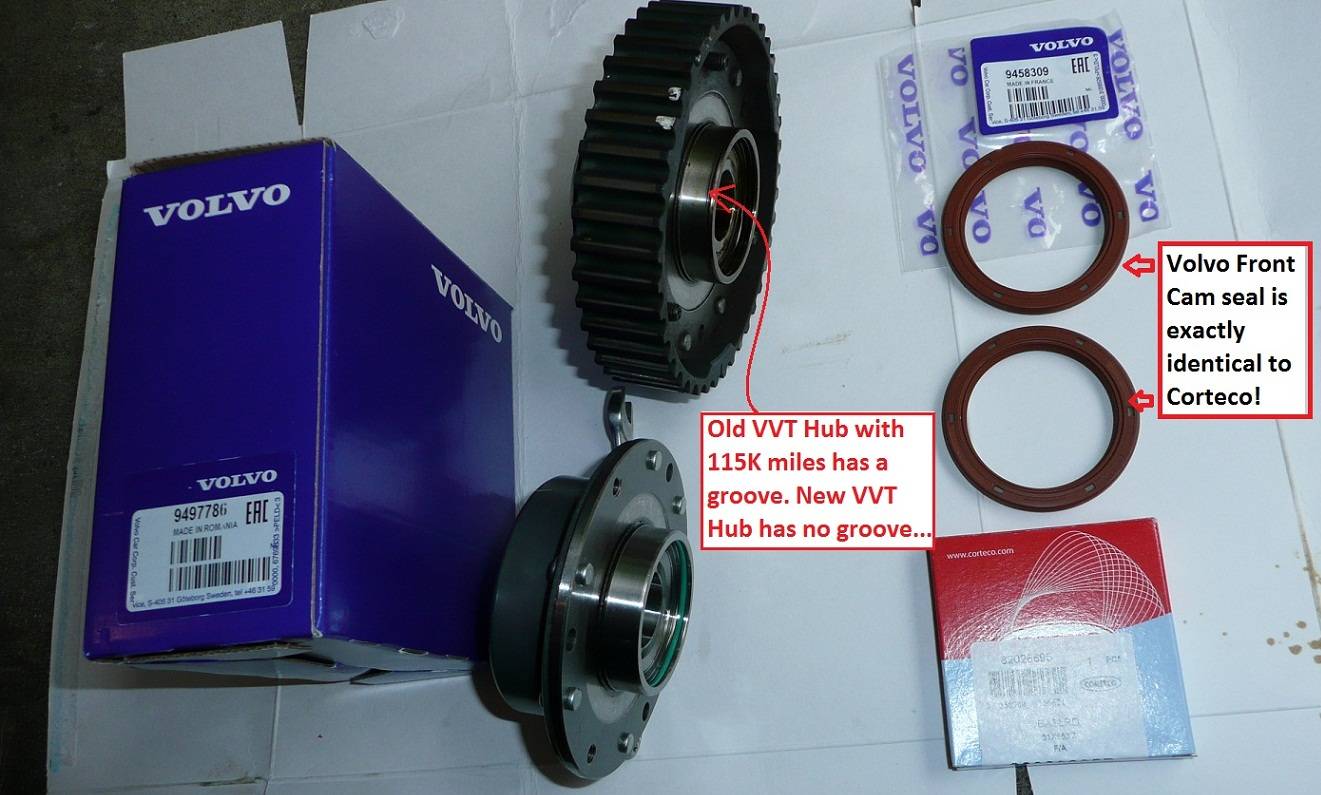

- Good source is FCPEuro etc. I bought most of my parts from FCP. The Exhaust VVT Hub was on sale Ft Washington, PA Volvo dealer for $215 with free shipping.
- Cam seals: the FRONT cam seal is definitely Corteco. When placed side by side, the Volvo factory seal is identical to the Corteco (Corteco ground off some numbering system on the seal surface to avoid issues with Volvo). The REAR cam seal: I do not know who made it for Volvo, but my experience using Corteco for the rear cam seals has been excellent.

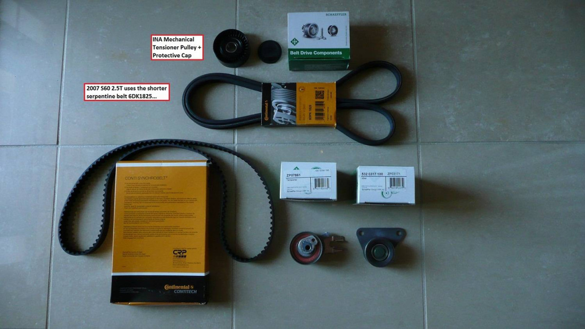

- TB Kit: I have been using Continental for yrs. Conti is the orig mfg for Volvo TB. Inside the Conti TB kit is INA pulleys.
- Serpentine belt: I use INA pulley and Conti belt. The 2007 S60 uses a shorter belt than let’s say 2004 model (smaller PS Pump pulley diameter in the 2007 S60).
- At 115K, the Intake VVT is still good with minimal play. The Exhaust VVT was still OK with about 1.7 mm radial play (no oil leak at 115K yet) but since this is such a big job with tons of potential issues, I elected to install a new VVT Hub bc I don’t want to do this job again.

2. PVC Couplers etc. with Cam Seal. Note old hub with 115K (no oil leak) has a groove from millions of rotations with the sealing edge of the seal creating a groove. If you re-use the old hub (i.e. budget issue), then make absolutely sure the new seal sits exactly as factory, more later.

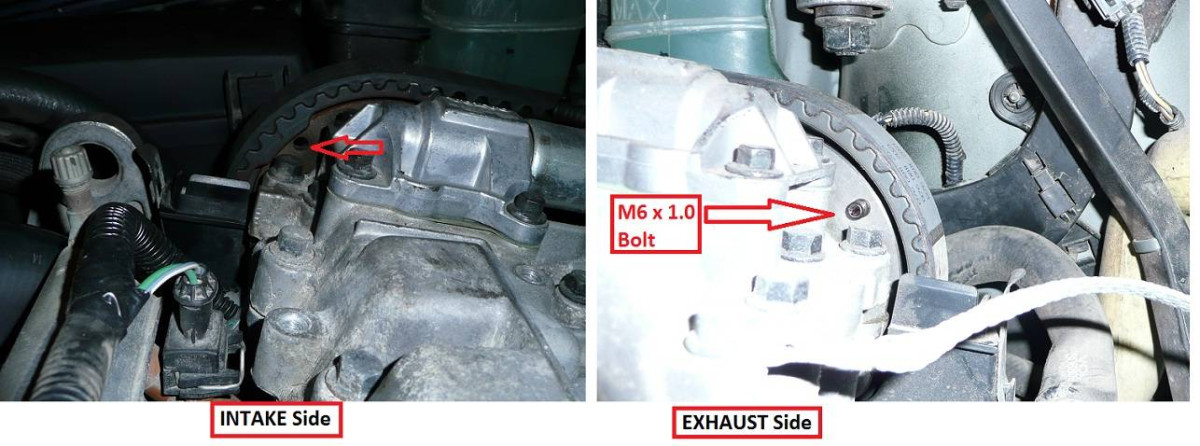

4. The VVT Hub 8-mm bolts is M6 x 1.0 type. Torque is 8 ft*lb. I use Red Loctite. When transferring the
Tooth Sprocket to the new VVT Hub, just use the factory setting to start where to place the 8-mm bolts.
If you ever strip the threads, either on the bolt or the VVT Hub, do not panic, just get a small M6 x 1.0 nut and install it with Red Loctite. I did not touch the Intake VVT but no idea why Volvo designates a different torque for Intake VVT (maybe 10-12 ft*lb).

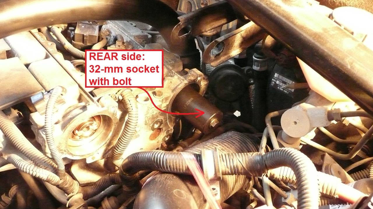

- CTA tool came with no washers, I used some washers on the bolts. TRICK: when rotating crank to get to timing mark, stop the crank about 1 inch before the timing mark, then moved it very very slowly 1-2 mm at a time while checking the rear to see if the Locking Tool fits, just snug them loose and slowly tighten them.
Only when you are happy with the setup, then tighten the bolts, I just snug them then tighten a bit, no need for excessive force, I am guessing 12-14 ft*lb.

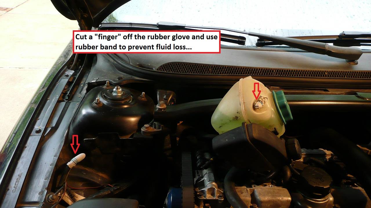

9. To disconnect the coolant level sensor connector, there is a tiny tab, use the small flat screwdriver to gently loosen it. To prevent fluid loss, cut a “finger” off the rubber glove + rubber band as shown. I also used some cardboard as cushion to prevent the Sprocket from rubbing the hoses (coolant and PS hoses).

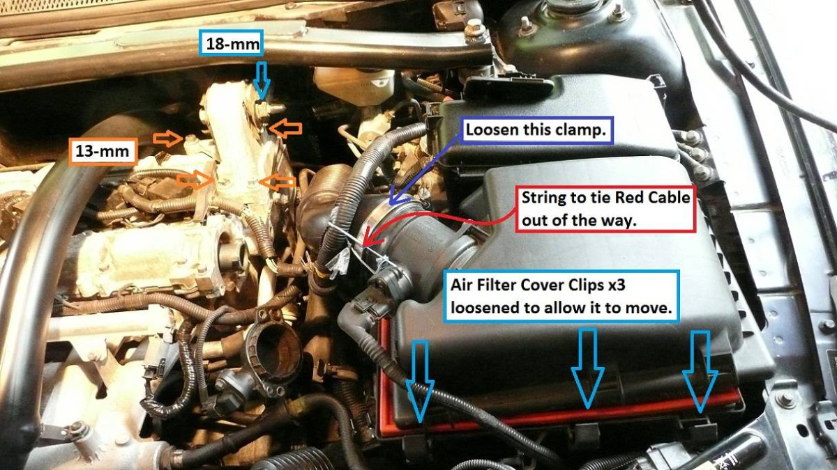

10. Space was tight, so a 10-mm wrench may help. Or use serp belt tool. Since I did not have the 3/8” T55 socket, I had to use this setup lol… In retrospect, I should have bought the 3/8” T55 socket.
TRICK: use a zip loc bag underneath to catch the oil leaking out.
11. Tie the coolant reservoir away. Note I had to use an iron pipe to undo the T55 bolt. This is when you will likely break the small little tab on the end of the camshaft on the rear side. See note above.

- Intake VVT play: 0.7 mm ---> re-used without issue.
4. The Front cam seal: after making the installation tool using wood, installation is 5 seconds.
The Corteco seal simply pushes in, no hammer needed!
This is why I used black RTV just to be sure and let it sit for 24h.
5. REAR cam seal: the 32-mm socket + bolt makes it very very easy, just go slow and check to be sure the seal just sits
at the chamfered edge.
Do one seal at a time so you can use the other seal as a reference to see how deep you should install the new seal.

This oil leak: I have been watching it for 4-5 years.
Finally had a nice weekend to replace the Exhaust VVT Hub.
The procedure is virtually identical as the S60.
1. The usual places of oil leak:
2. The idea of Woodruff key or wooden chopstick is fine but the small little tab on the cam still broke later.
So, no need to protect this little tab. It is inconsequential.
3. Exhaust vs Intake VVT at 132K miles.
- Exhaust VVT play: 3.0 mm ---> replaced with new INA unit.
PS: If you don't have VIDA or a code reader and don't want to see the code P0026 (Intake Solenoid)?
The book says after timing belt job, turn the crank 2 full 360-degree revolutions. Well, if you turn it 6-8 revolutions, it should be enough to prime the VVT Hub with engine oil: this was what I did this time: no CEL at all.
