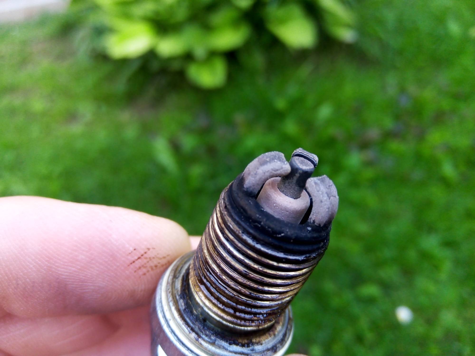

Be careful running the engine too lean or you could burn your valves. As you have done a long run, it may be worth removing some spark plugs and see how they look. It will give you an idea if it is running rich or lean.

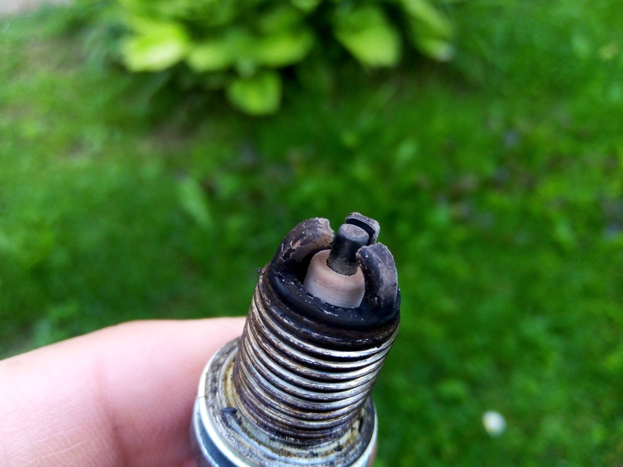

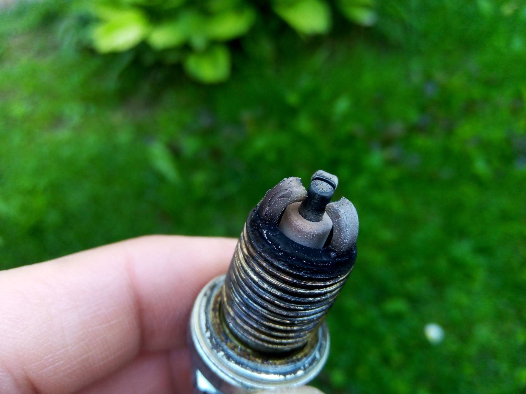

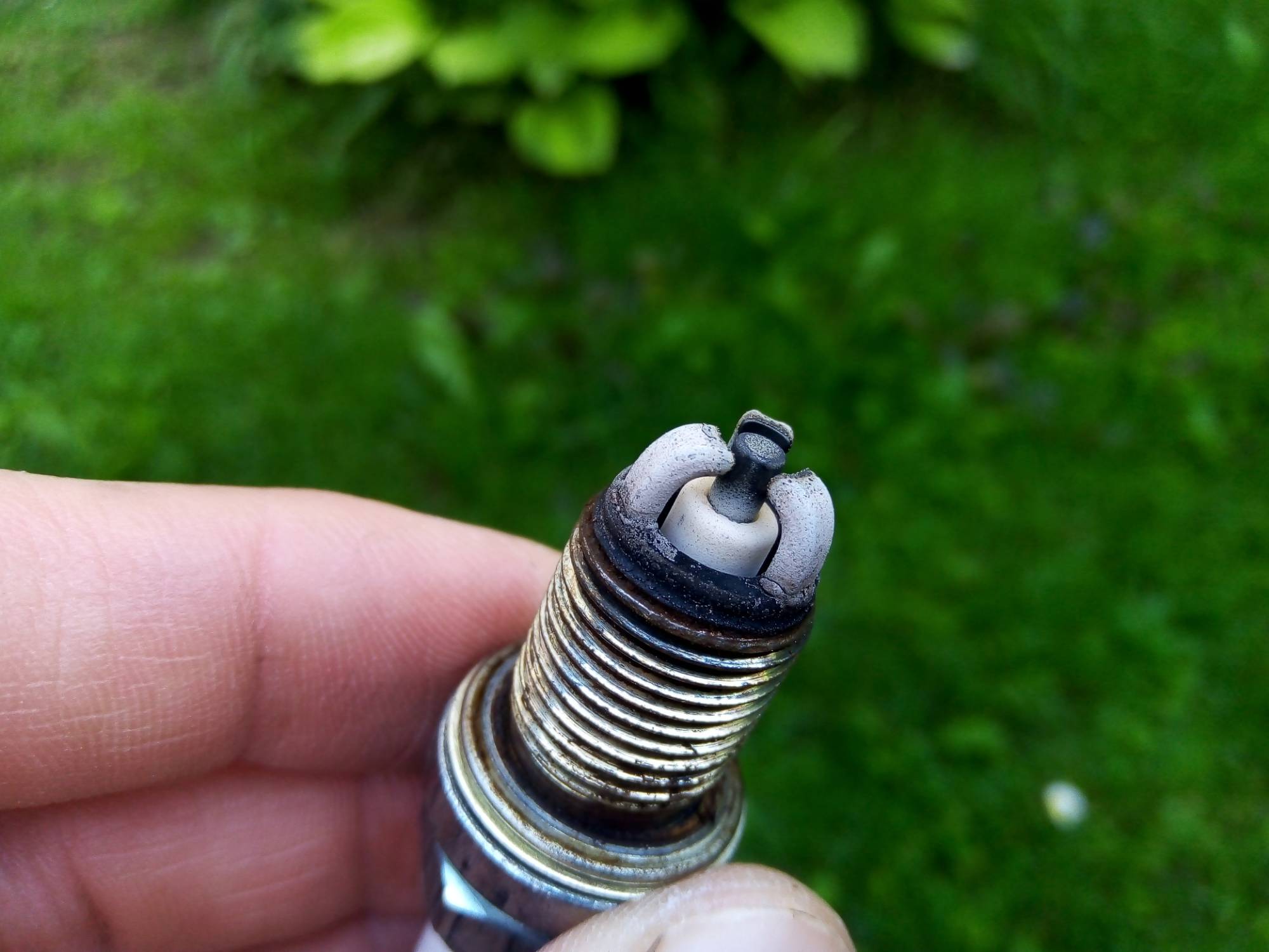

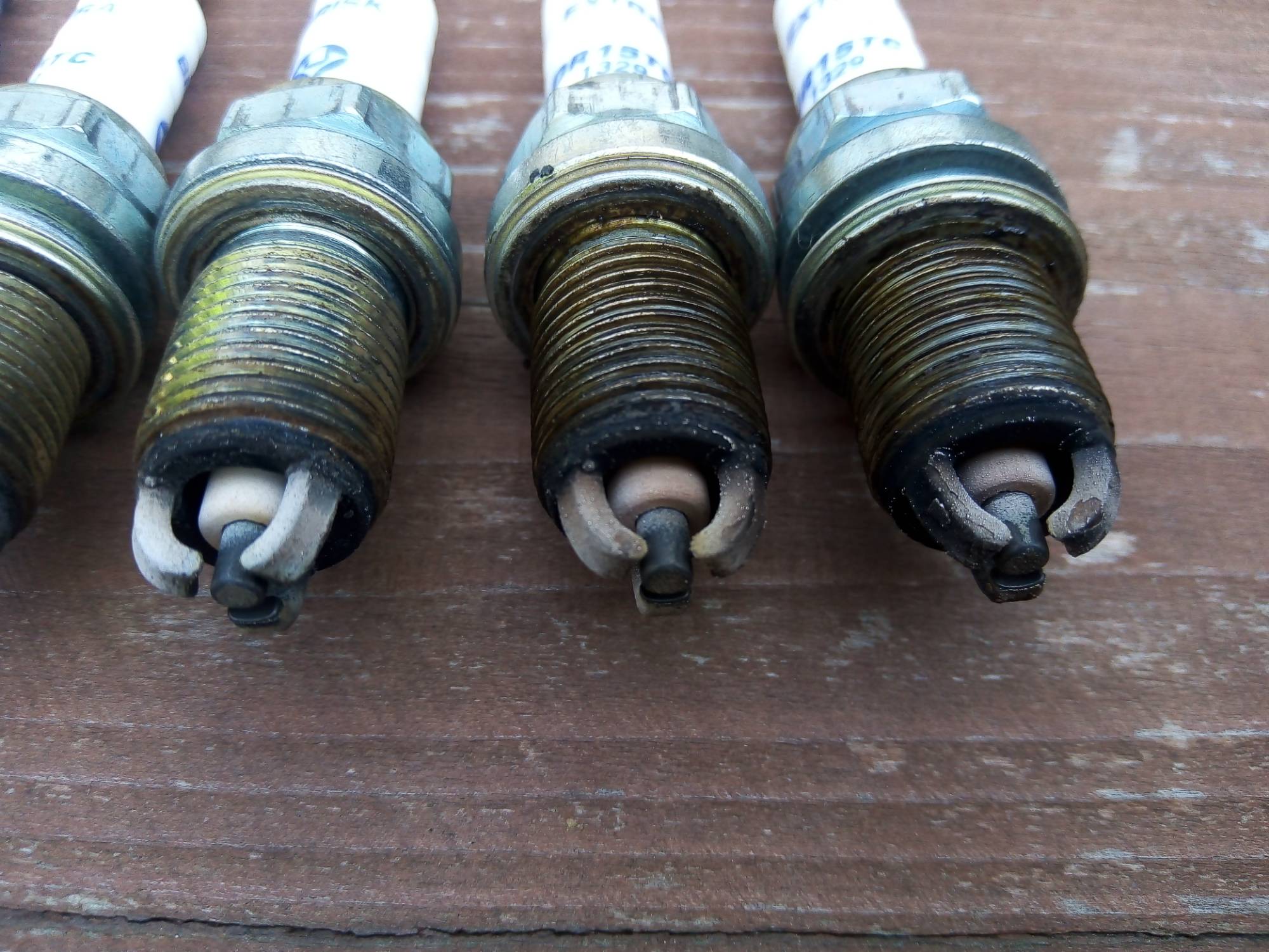

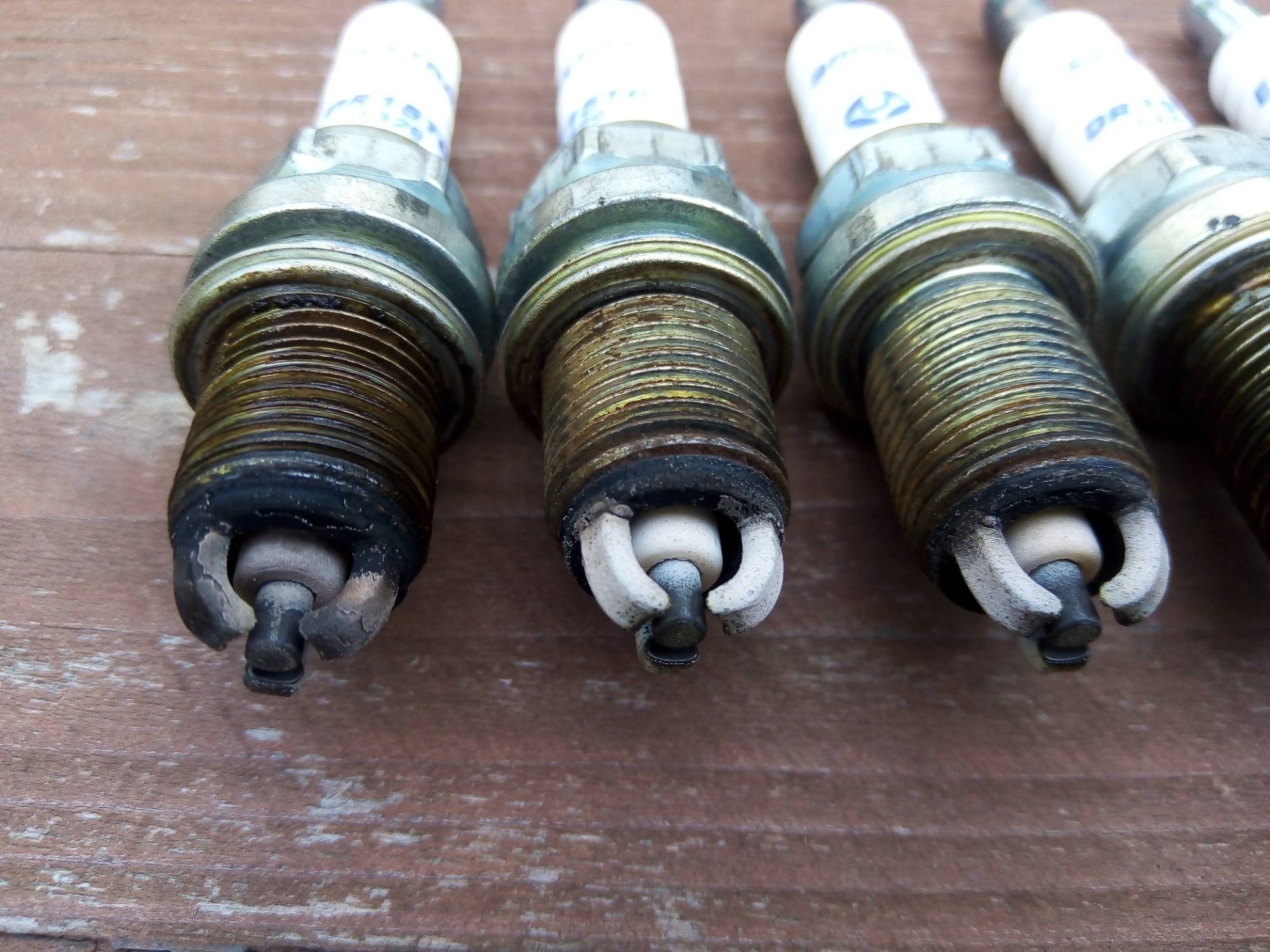

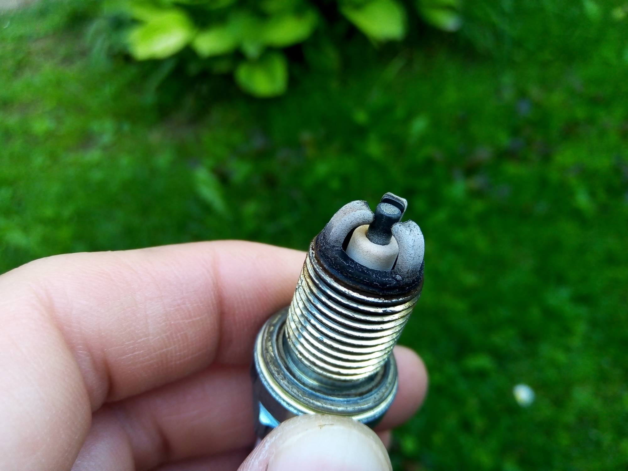

Today a make factory timing alligment with factory tool. Engine run better, before alligment i put out sparks, two of then seems running lean, one normal and two rich. Injectors problem ? Will check sparks again after next trip, maybe new timing brings some difference...
