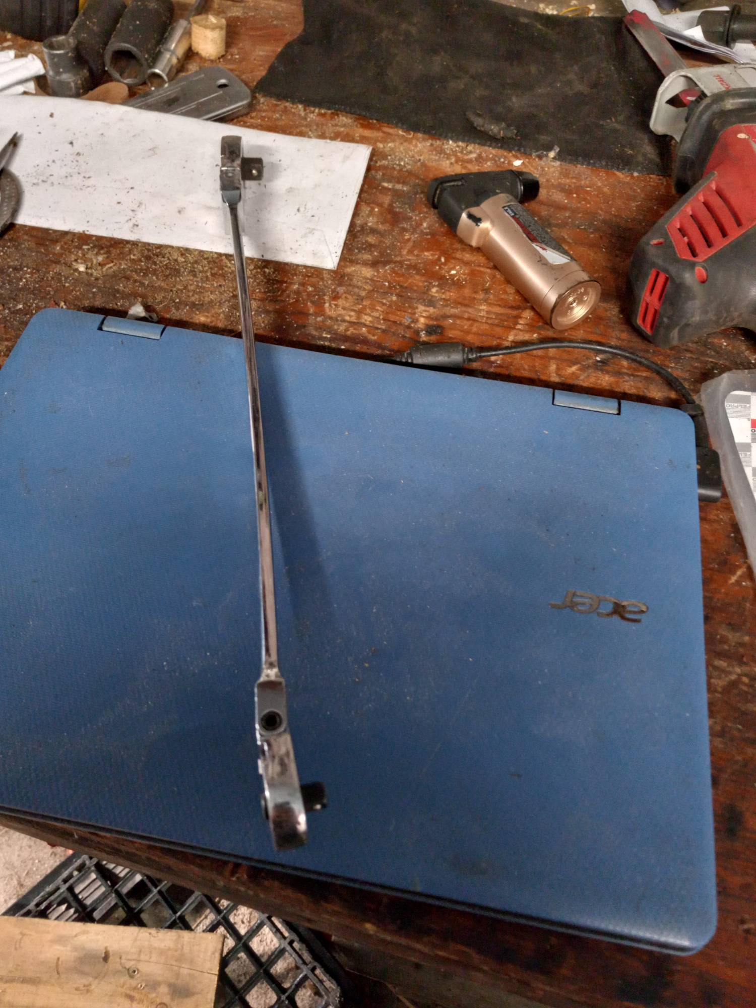

This low profile ratchet wrench helps loosening the lower banjo bolts, there's not much room for regular ratchet.
Harbor freight.
Order new copper washers, 2 for each bolt.
