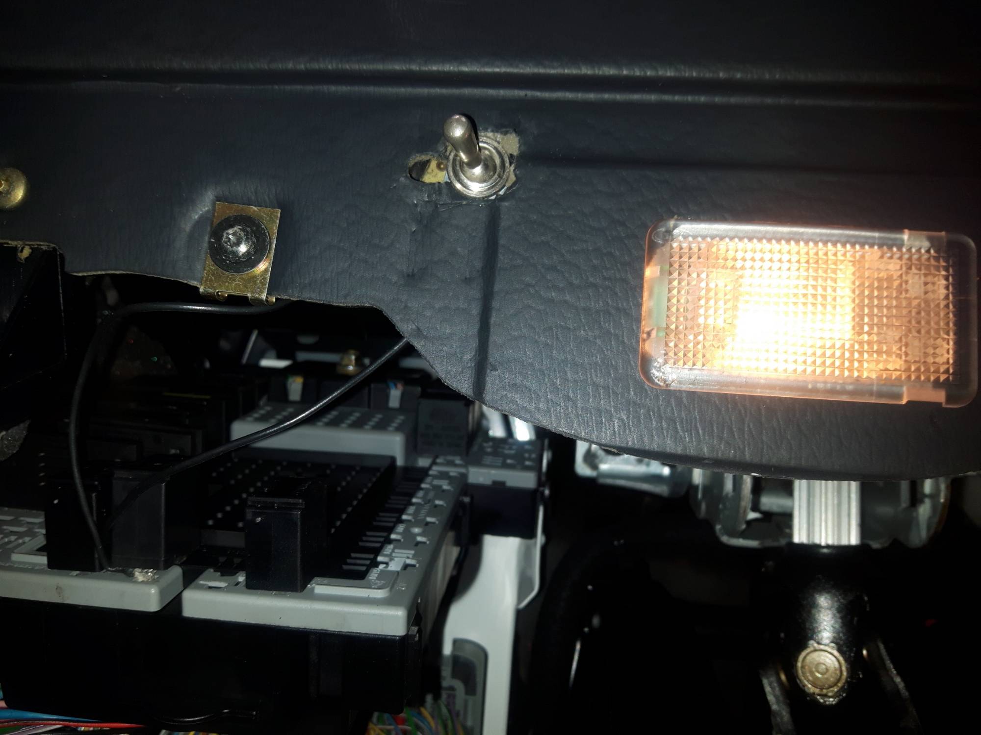

But just for a back up plan I located the fuel pump relay and soldered in jumper switch just in case everything goes wrong.

After about a month of driving, so approximately 1000 miles,, the dreaded hot no restart returned. I guess removing and cleaning CEM module pins was just a band aid solution.
But just going to say lucky thing I put in the jumper on the relay for the fuel pump circuit because this time when I felt the car wanted to stall from lack of fuel pressure after restart I just reached down a hit the toggle and ShaZam! engine came back to life. Fuel pump was back in the game.
And funny enough I was able to return the switch back to the off position once the circuit was complete?? Explain that one.
Seems the CEM is definitely weak but once circuit is complete then all is good because I've never experienced a stall situation while driving. It's either the fuel pump is engaged or it's not during the engine start up routine.

Yeah you're right Brody, I'm sure the CEM will need a re build if things get any worse and I totally expect it will but til then I'll be using the 'ole toggle switch when needed.
Like today, I made a stop after work and sure enough it happened again but just did the toggle trick and I get home on time. Not sure how long this luck is gonna last but just so people know to keep a jumper wire in your glove box in case.
Yes you should be familiar with relay location.

The ole CEM did it's little trick again today on a 300 mile journey back from my parent's place. Was getting hungry so i figured I better stop for a little PopEye's and I knew conditions were ripe for a no start.
So all finished I jumped back in the car, twisted the key and it always fires but then it continued to stumble and stall. Okay some what prepared for this situation I toggled the fuel pump and tried again and away she went. Happy trails for me
I'll continue to update this until I have a complete failure I guess.
