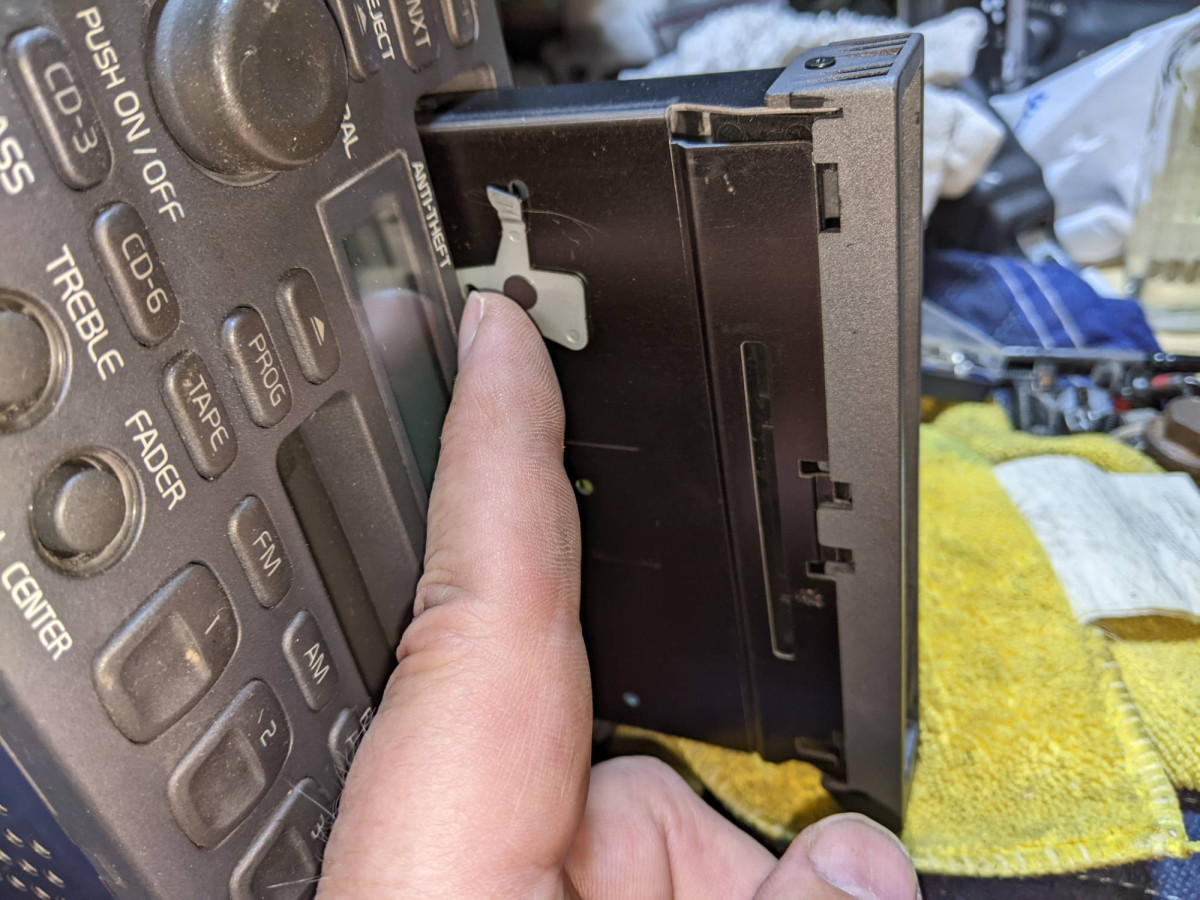

2) With the lid off, use a flat blade screw driver to gently move the black plastic cog wheel counter clockwise (toward the front of the unit) or as in the picture below, you are pushing the cog toward the top of the picture.
You need to keep doing this until you have the drawer with the CD cassette about an inch (25mm) or so out from the front. With steady pressure you can then pull the drawer forward until it stops:
3) Once the drawer is fully out, you still cannot remove the CD cassette. Under the drawer there is a spring latch you have to move and you will hear a click and the cassette will pop free. Voila!

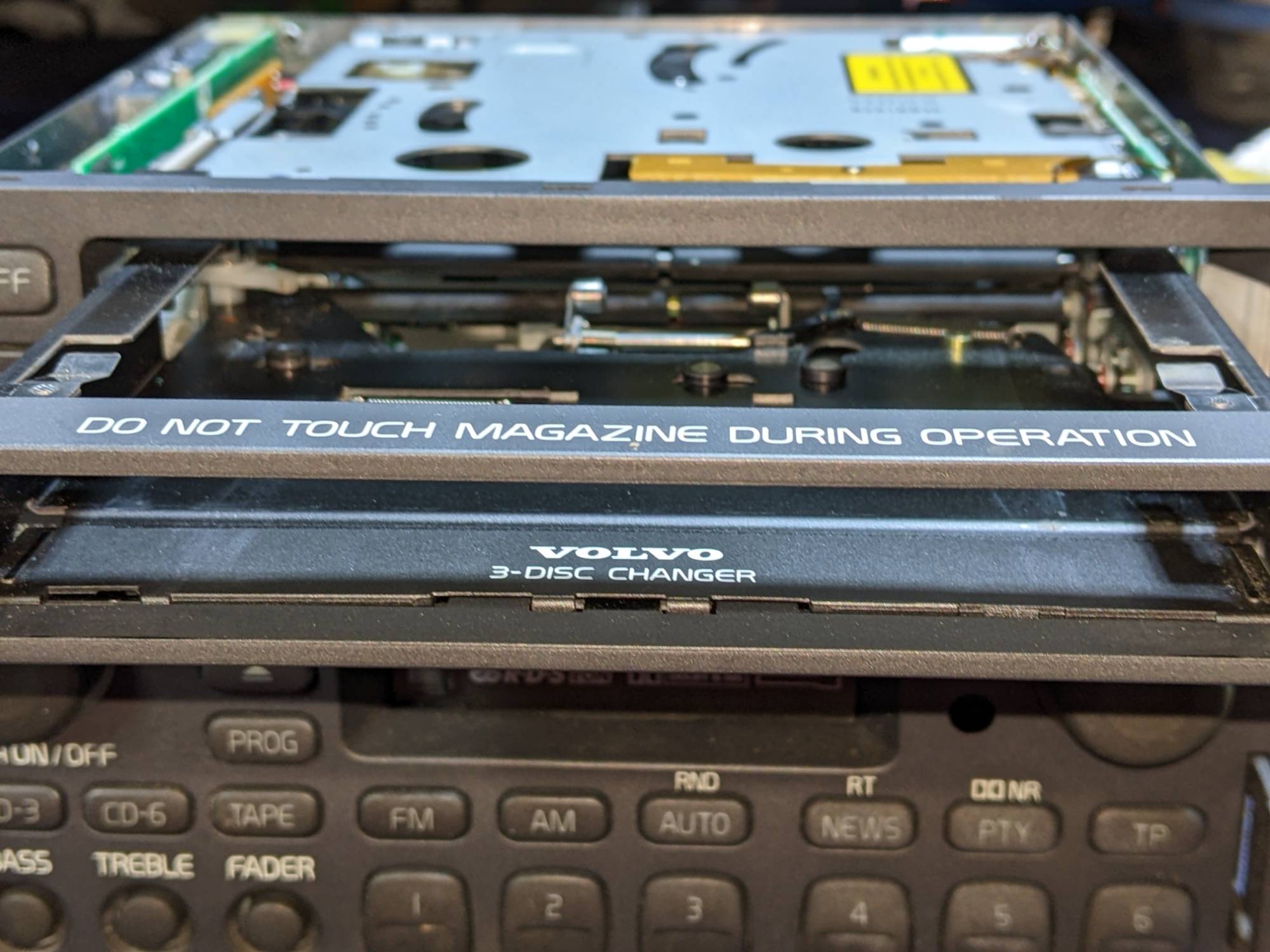

What I don't recall in the original lens cleaning process is to clean the rubber grab rollers that pull the CD's in and out from the CD cassette.
With the CD cassette out and the drawer fully forward you can now see these rubber rollers. I tied 2 cotton buds together with tape to make a longer cotton bud. This allowed me to be able to reach in far enough to get to the rollers and wipe them with IPA on the buds.
You may be surprised how much grim comes off them!
These head units get a bad rap mostly due to poor maintenance and lack of cleaning. With the unit removed it only takes about 10 minutes to clean the lens and the rollers. Not doing this and the CS's may not be ejected fully or get stuck when being drawn in.
