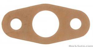

No, you shouldn't have to fool with angle gear, you'll need this gasket I think.. if it's where I think it is oil return tube into oil pan. rockauto.. 2.37 $... MDK

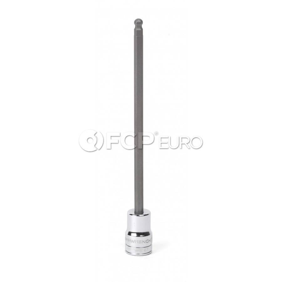

I think the stock bolts are H5 hex internal head on m6 threads. A bit odd ball. A ball H5 head makes this easier

get the gasket and bottom green O ring for the pipe, extended drive allen hex head to get up there.
I paid $7 at the dealership for the parts. Its awkward getting the bolts started.
Remove the drain pipe, clean the top, let dry and stick the gasket in place with gasket shellac.
Try FCP for the extended hex socket driver.
