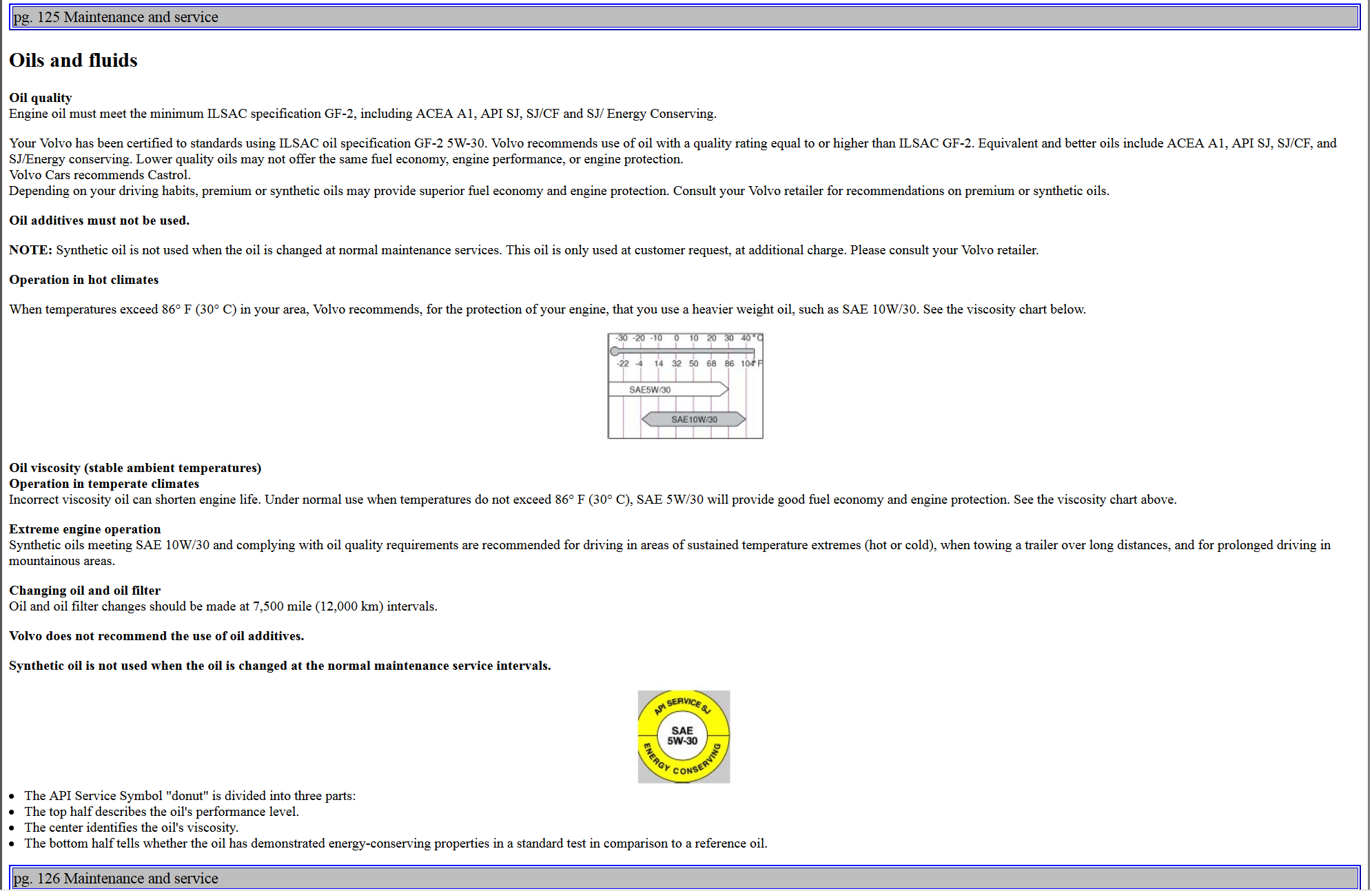

I'm sure summers exceed 86 F and there are extreme winters in Ohio. Every manufacturer has to take into consideration EPA, Break In Period and potentially how well the engine is worn at 100, 200K etc. The 5W30 is a good balance but they also tell you to use a heavier weight after 86 F.
One chart is for an 04 S60 & S60R the other for a 2009 C30 T5. Oil does improve over the years and engineers make changes. It's up to 40W for the 5 cylinder. The manual covers the manufacturer from liability as they make recommendations and let the consumer decide on what oil to use. The 5W40 and 0W40 provides better overall protection and one oil for the entire fleet regardless of climate in both extremes.
Hot &Temperate Climate, Best Fuel Economy and Extreme Operating Conditions in Hot & Cold are all listed for the consumer to decide what to use for the C30. The lawyers have to work at Volvo to limit their liabilities. They know about people exercising their turbos
