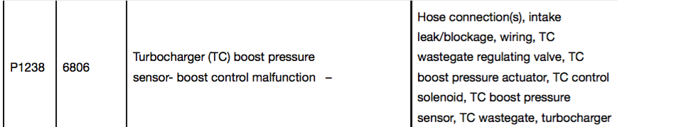

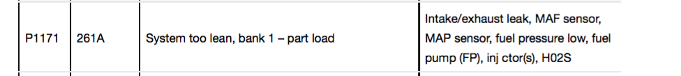

Back from getting the codes read - I got a P1238 - Turbo Control Valve. Does this mean what it says, or is it indicating some thing like an air leak? - I looked for that, already..
Also got a P1171 Fuel Adapters bank?
I need a new code list - mine doesn't show either of these codes...

so taken together, it could be an air leak? Time to take a closer look. The turbo spins up, partially, which is odd, since last night.

It could easily be a simple induction path leak. Once the ECU detects that it will inhibit boost so that’s your. ‘ turbo failure’

Thanks - Rule 1 - make sure the clamps are tight.
After a bit of reading, I realized both codes could be caused by an air leak. I checked the cross over to Air cooler line and found a loose clamp at the air cooler end, and evidence of blow by. Since the hoses are old, they didn't fit tightly. So, I replaced the clamp. I am going to clear codes and see if that solved the problem. If it does, time to order a new set of intake hoses..
