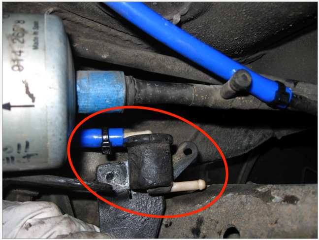

I had this problem a couple of times too a while back and in my cases it turned out to be (1) plugged vacuum line and (2) plugged evap vent canister line.
write-up: viewtopic.php?t=70426
video: viewtopic.php?t=71484

The plugged line was at the roll-over valve underneath the car, near the fuel filter. The roll over valve is circled in red below:
I replaced the lines and that fixed the "can't fill up with gas" problem at the time. Good luck!
