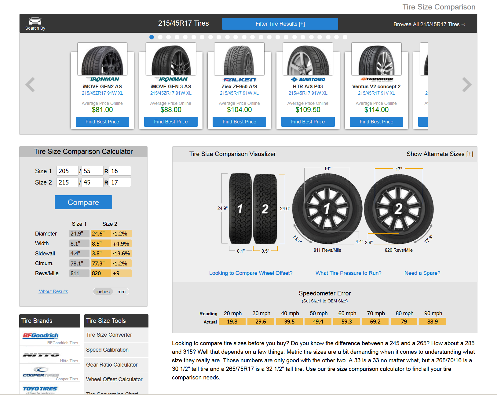

MDK wrote: 14 Jan 2023, 19:04 Well, I took a set of the 2003 AWD wheels from an S60 and put them on a 1998 XC70 , cleared everything.. 215-45-r17.. for every tire size you go up or down it changes the speedometer by 1.5 miles an hour.. give or take.. but so what.. my XC70 looked awesome! MDK
Wondering if the XC70 is taller up front as the THOR is compatible with the S70's. The 215 though wider is not as tall as the 205/55/16. Regardless the OP is good with his current 15". From other online post 215/45/17 should be the largest before a little rubbing takes place especially if the springs are worn.
https://volvo-wheels.com/product/volvo- ... -thor-rim/
https://tiresize.com/comparison/
Volvo Thor.png (617.9 KiB) Viewed 1027 times
Volvo 16 vs 17 Tires.png (546.13 KiB) Viewed 1027 times

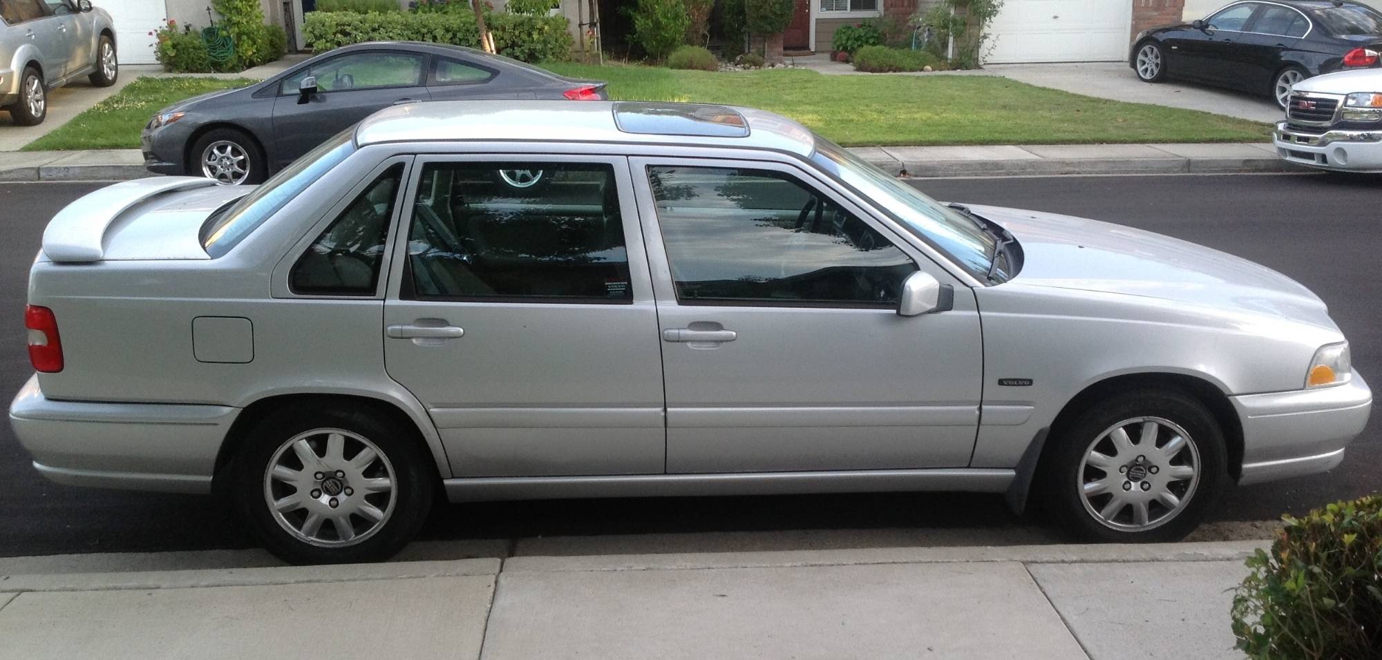

My 98 S70 T5 came with 16" and I went with 01 V70 15" for a softer ride. Best to throw them on and spin the wheel. Most 15" have less positive offset so less likely to rub the calipers.
98 S70 T5.jpeg (216.68 KiB) Viewed 970 times
