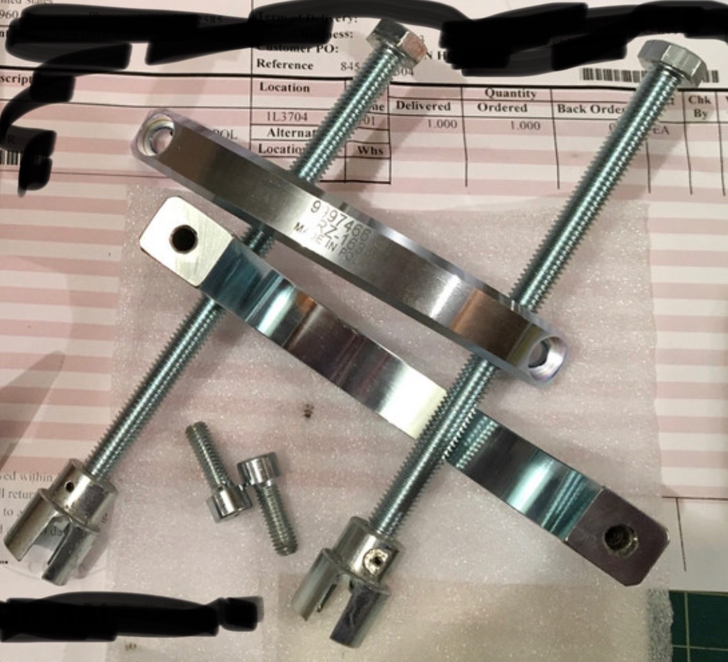

I can only speak for the M66 transmission, but the axle spline is in direct contact with the transmission fluid. I used Volvo tool 9997466 from https://www.volvospecialtools.com. It was super easy. The axles is recessed in the transmission and it is very hard to get a pry bar behind the axle unlike the automatic transmission.
The tool push bolt are resting on the outer ribs of the transmission and put grease on the clamping and push bolts.
Picture borrowed from c30crew website.

Thanks for the information. The official Volvo CV axle removal tool 9995681 might be available at volvospecialtools.com. I wonder if it has any advantages over chisels or a generic axle popper ? I need to look under the car and see what the clearances look like for a chisel or other prying tool. On P2 V70, the CV axle for M56 manual trans is about 1/2 inch longer than the axle for automatic transmission. I think that means the back of the inner CV joint will be1/2 inch further in from the wheel hub. I dont know if the back surface of the inner CV will be harder to reach with a prying tool compared to an auto trans car.
