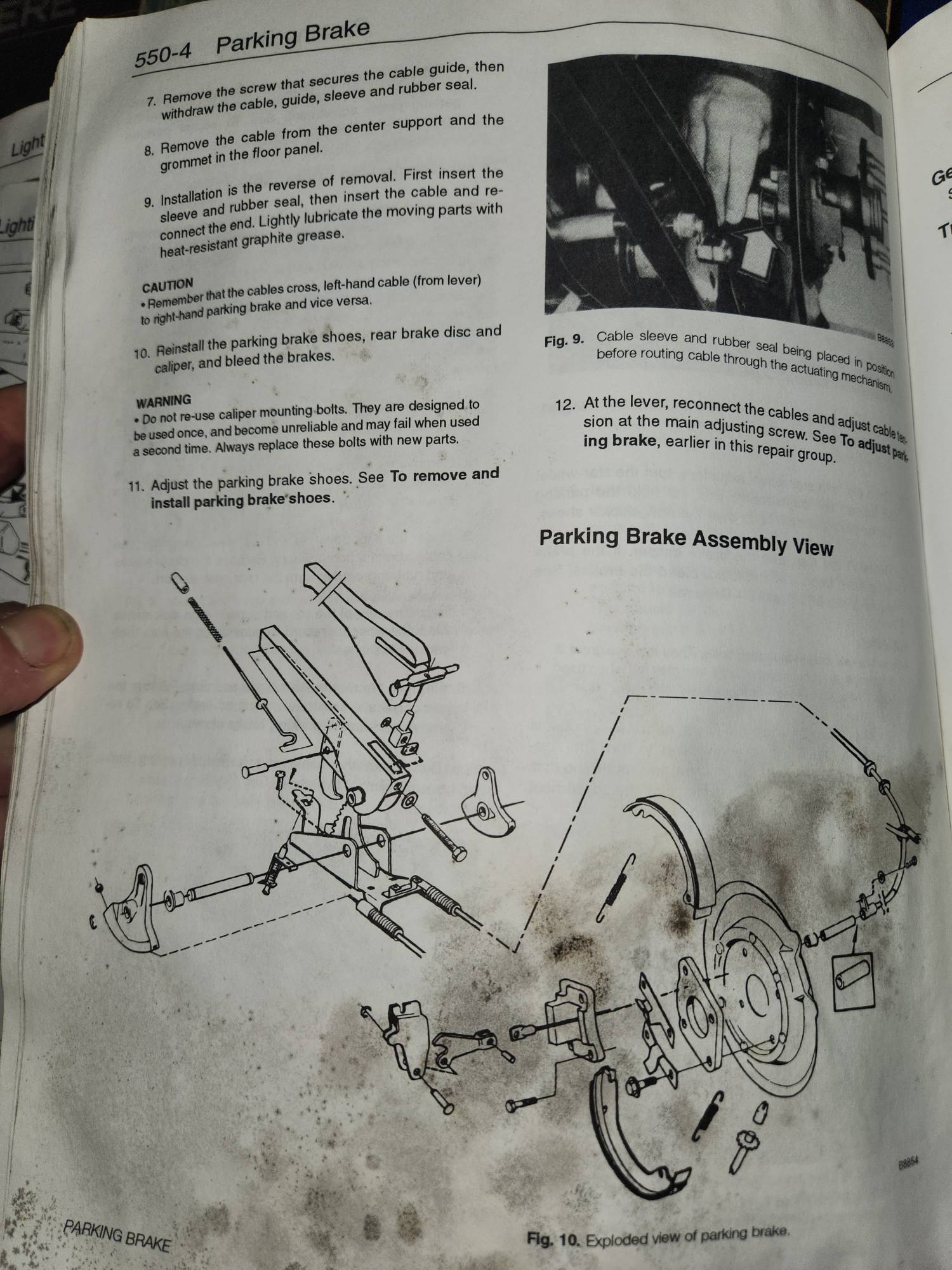

Hey everyone - I recently had my front park brake cable taken out by a volvo mechanic as it was no longer working (assuming from old age) and I found the replacement part on ebay. I would like to install it on my own instead paying $300 at the mechanic unless it is very complicated.
Looking for some instructional video or general help in this matter.

Attaching pics from Bentley manual on replacing the cable (and adjusting the brake).
