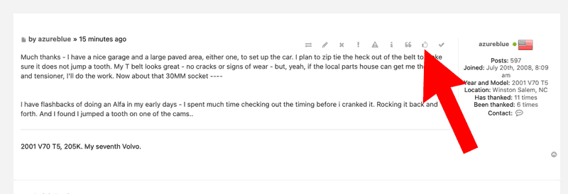

(azureblue, please "Thank" the users in this post you feel have helped you. Below is where you find it on a desktop, in mobile, it's in the dropdown menu in the same location. Sorry for the interruption, please continue... )
