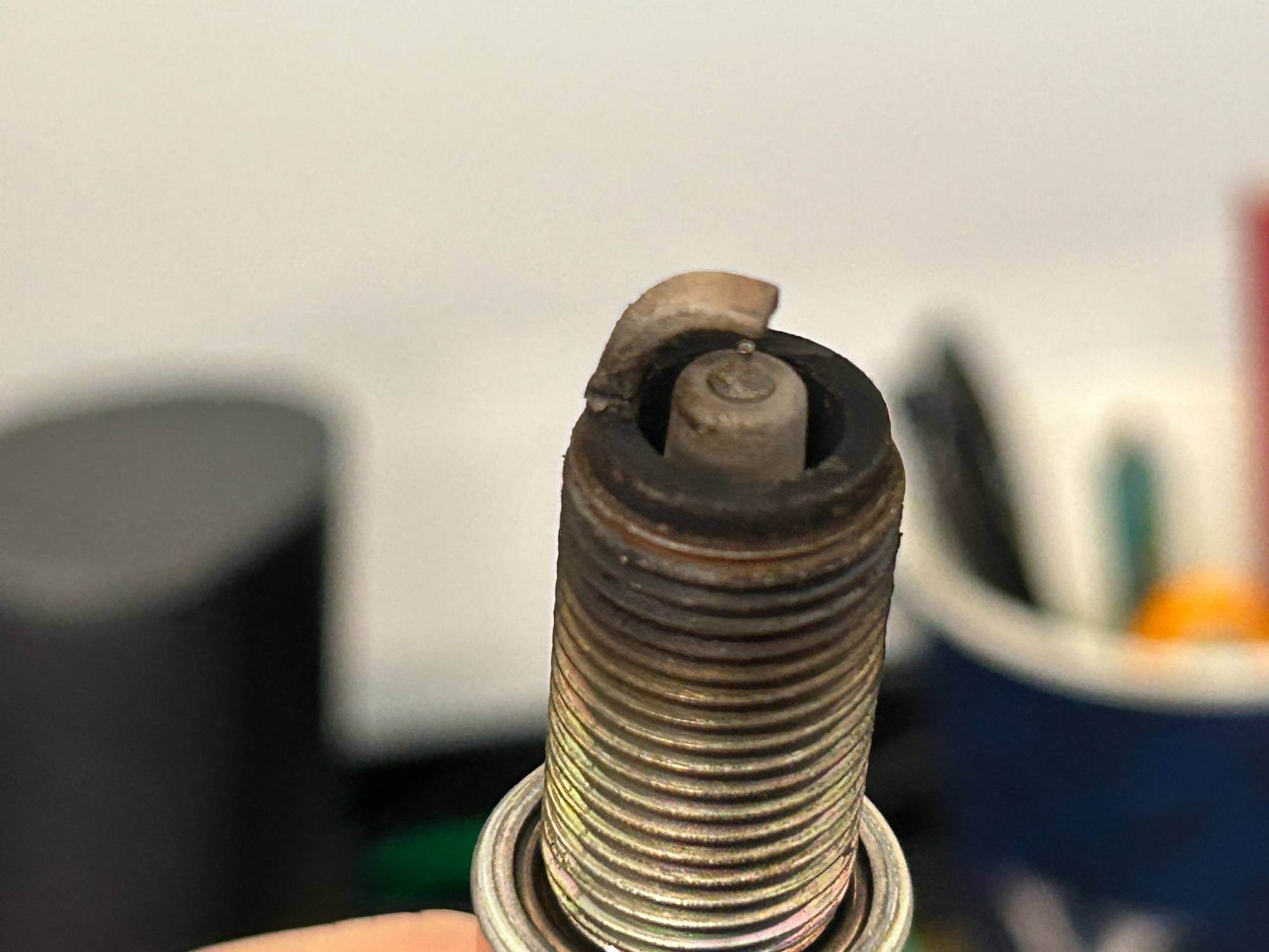

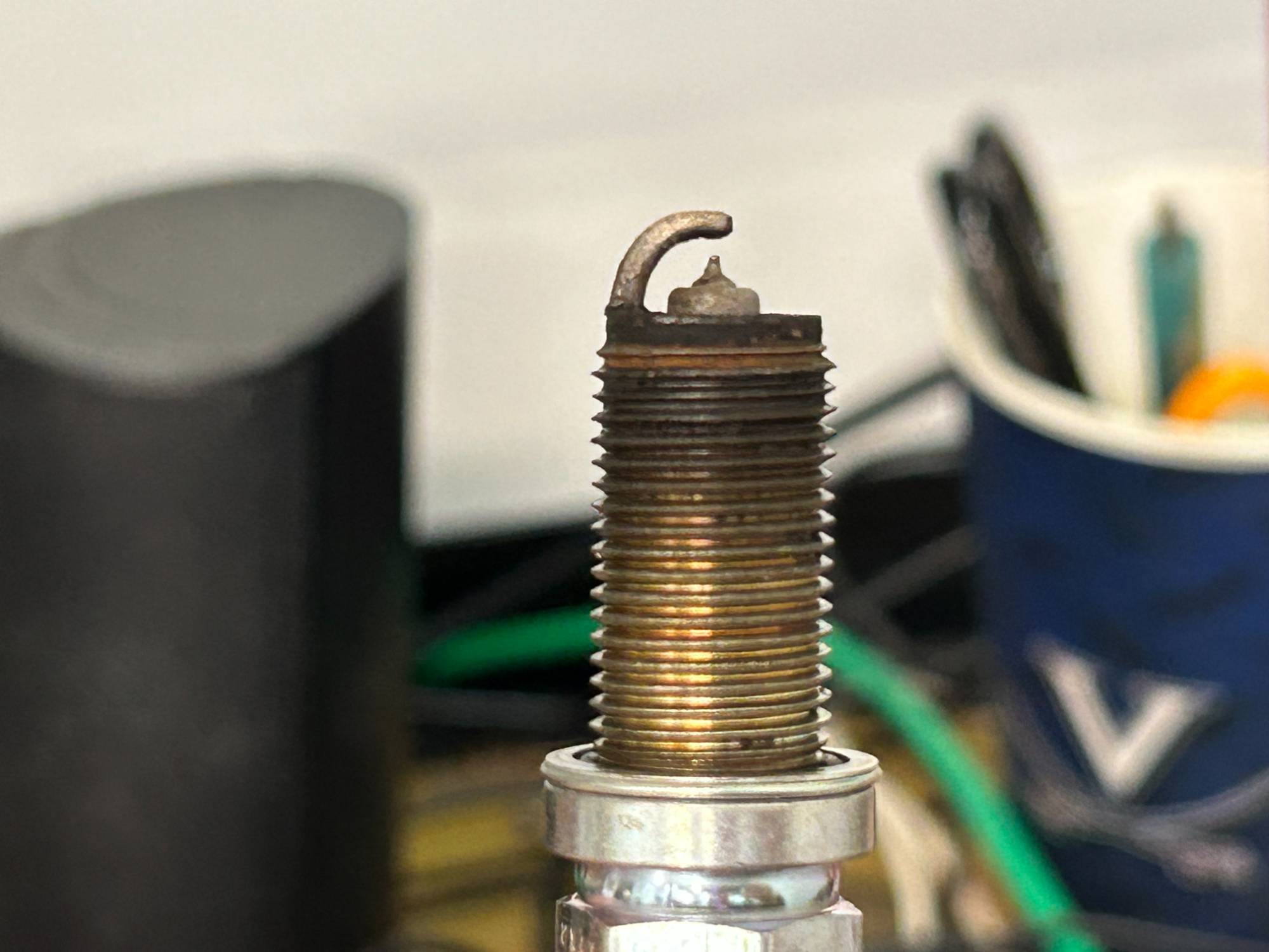

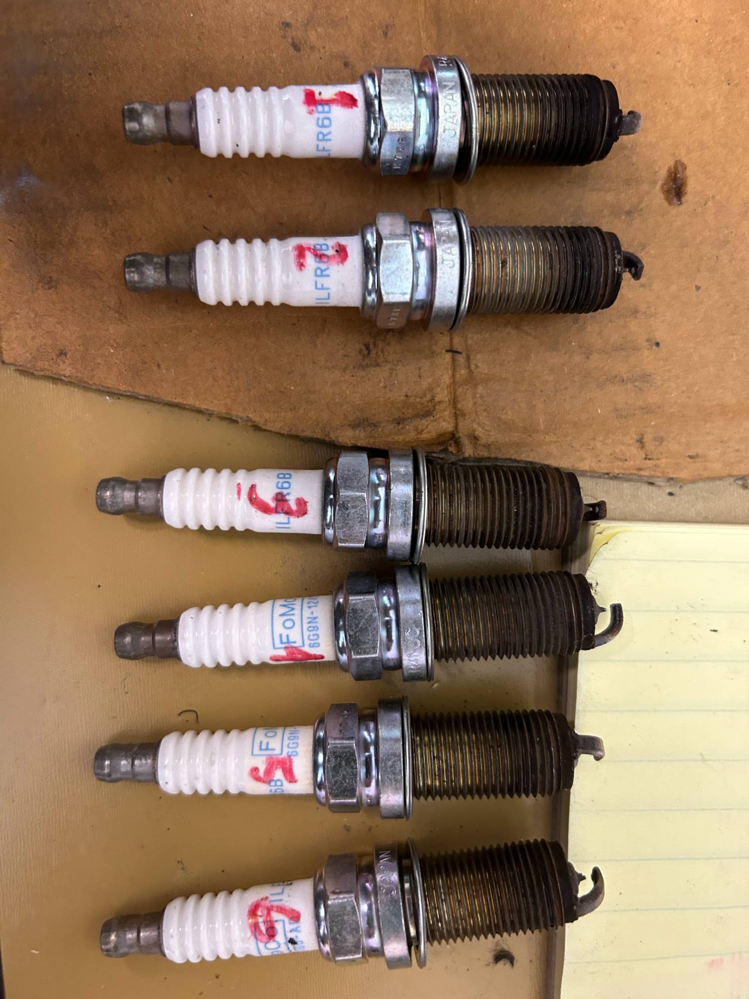

XC90 3.2 2008 150K miles. I decided to change the spark plugs given the mileage. To my surprise, I found ford spark plugs. So previous owner must have had the spark plugs replaced. That was at least 80k miles ago. Car was running fine. Replaced with Densco. Here are the old ones. Not sure how to diagnose them. How do that look?

1) The sparkplugs look original
2) No indication of arcing on the ceramic (this is good)
3) Carbon buildup is a bit more than I would like but very even across all 6 (I would just replace with new Denso Iridium TT)
4) The even Carbon Build up indicates that the PCV is functioning well (a failed PCV will affect 6,5,4,3,2,1 in that order and it will foul the sparkplugs)
5) I change my Sparkplugs every 50,000 miles - you may want to consider reducing the interval

ChitownV makes a very good point.
The original Sparkplugs were likely sourced from more than one vendor.
Looking at the pictures above you have the following information on your old sparkplugs
- Made in Japan
- ILFR6B
Those are NGK Sparkplugs
I prefer the Denso Iridium TT but I don't have any data that shows NGK or BOSCH would be a problem.
My only recommendation is to use a fine tip iridium sparkplug with the correct heat range.
- Made in Japan
- ILFR6B
