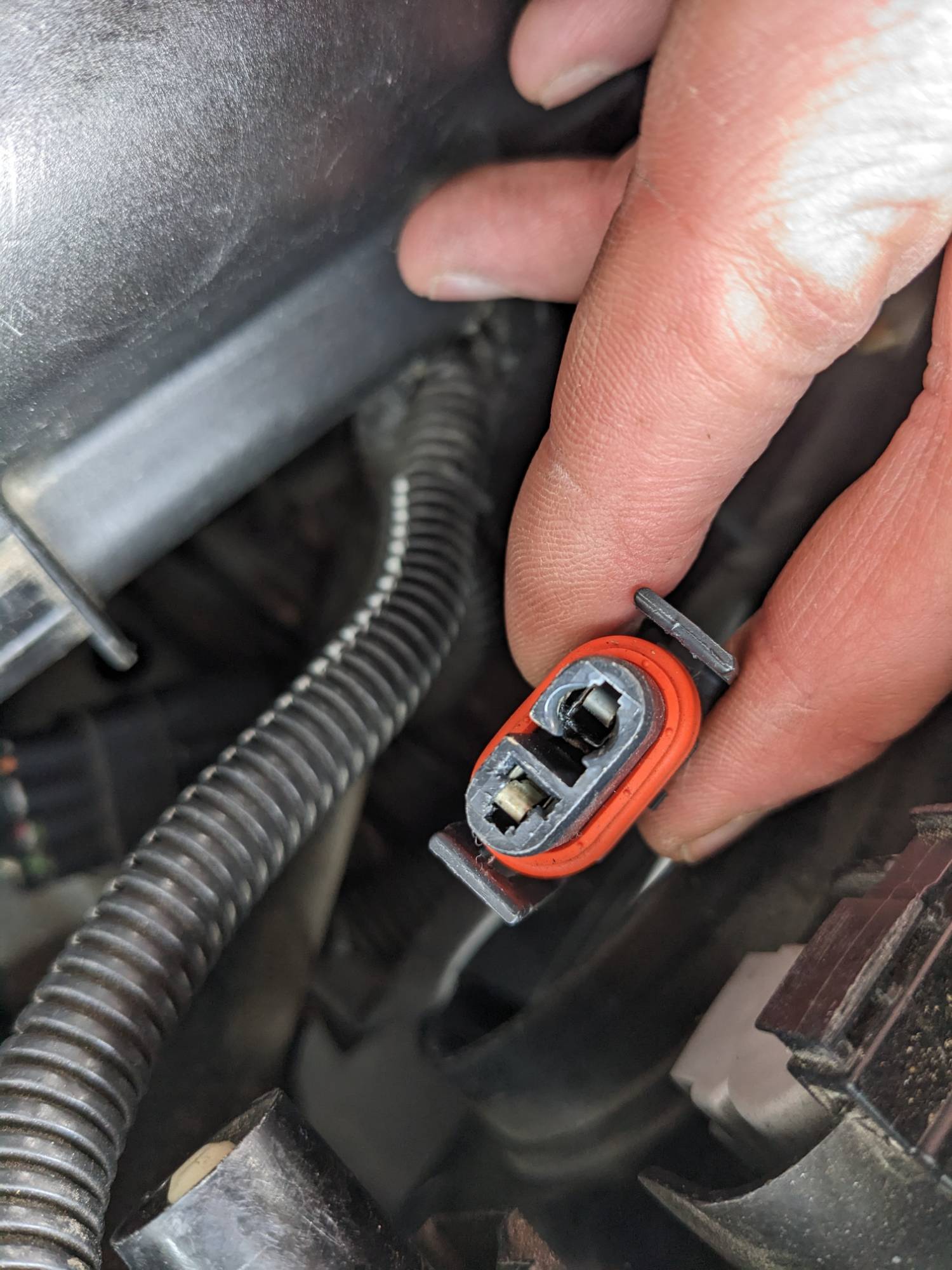

Post by hughiescho »
So after noting low beam bulb is indeed not lighting, I pulled out the air box to access the bulb from rear of headlight assembly. It appears one of the two female receptacles that the bulb plugs into is broken. See image. I am going to try source a new "plug" locally tomorrow. Hopefully it is just from age.
