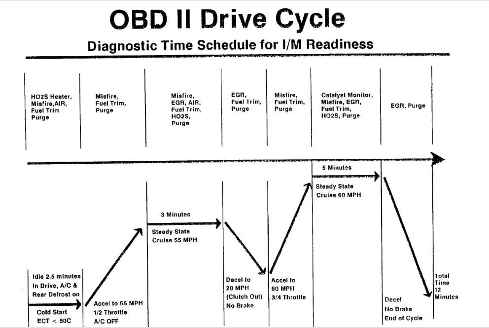

The Chart shows what is needed
- The Engine is cold
- Turn it on and run at idle with defroster and AC on for 2.5 minutes
- Accelerate using 1/2 throttle to 55 mph
- maintain 55 mph for 3 minutes
- Slow to 20 mph (do not brake!!!)
- accelerate to 60 mph using 3/4 throttle
- maintain 60 mph for 5 minutes
- Slow to 0 mph (do not brake!!!)
- turn off the engine
The brakes are not used any any point in the cycle
I drove my Audi for over a year and my monitors would not show ready until I did the cycle exactly as I wrote above
It never happened by accident in over a year.
Good luck
