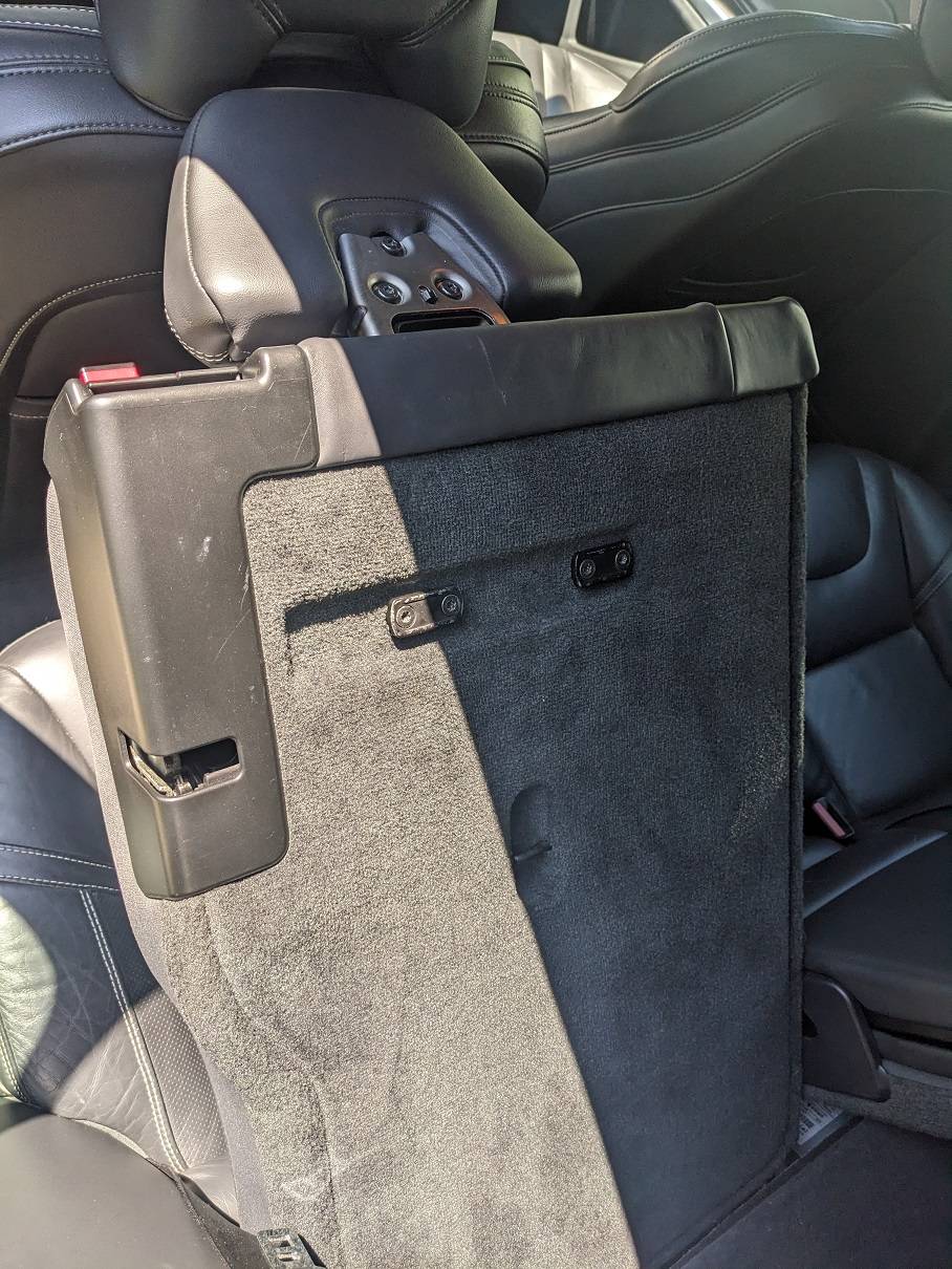

Here is a follow-up if anyone else needs to replace the rear headrest mechanism.
Photo shows plastic/nylon release tape that was broken causing the head restraint to lock in place and not be released, this required replacemnt of the complete head restraint mechanism.
Step 1. Remove Lower Back Seat using flat head screw driver to depress black plastic tabs between carpet and bottom of lower back seat.
Youtube video here:
Step 2. Remove Rear side bolster, firm yank on top of bolster held in by plastic clip.
Step 3. Unbolt rear back seat pivot bracket from floor (one bolt and alignment pin) and rear back seat pivot nut.
Step 4. Disconnect head rest drop wire connector.
Seat back can now be removed from car and disassembly can be done on bench/table/floor.
Step 5. Remove head restraint trim cover (clips), head restraint (three bolts) and plastic trim piece (clips).
Step 6. Remove Manual seat release cover (plastic clips) and manual seat release mechanism (torx screws).
Youtube video here:
Step 7. Remove Back carpet (torx screws and metal plates) and leather seat cover (various plastic trim hooks).
Step 8. Disconnect manual release cable form release lever.
Step 9. Disconnect electrical connection for electric release signal wire.
Step 10. Unbolt head restraint mechanism from seat back (two torx bolts either side of mech).
Finally reverse steps to install replacement head restraint mech.
Youtube video here:
Youtube video here:
