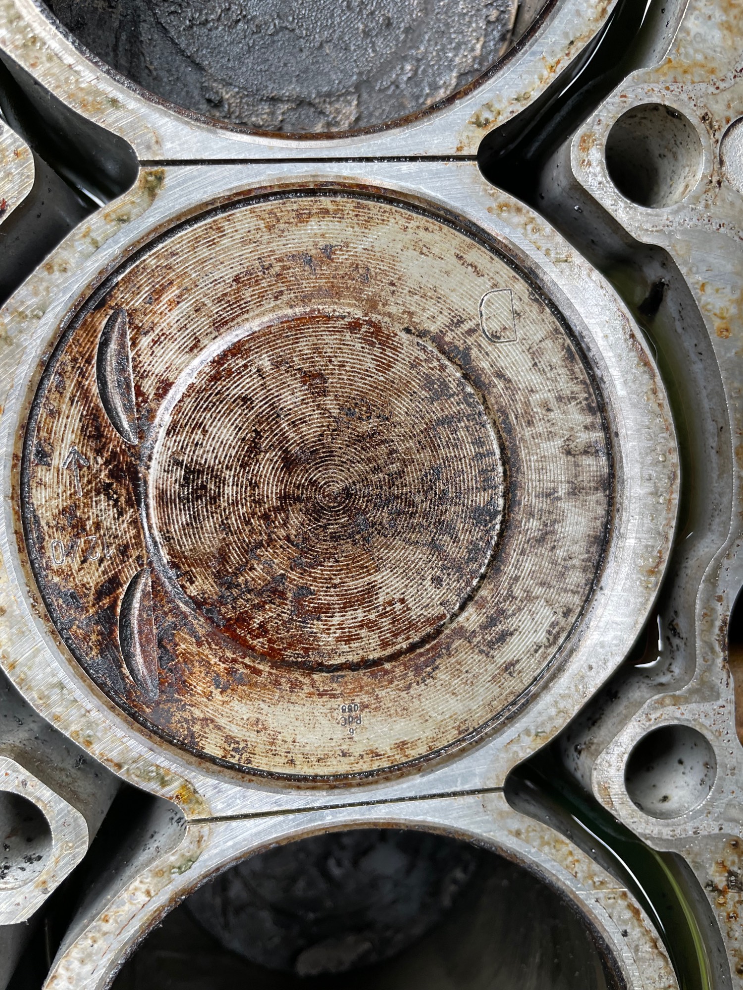

Never noticed this before. Piston size for each cylinder stamped into block
All size D on Shagg.
P80 engine cylinder bore marking

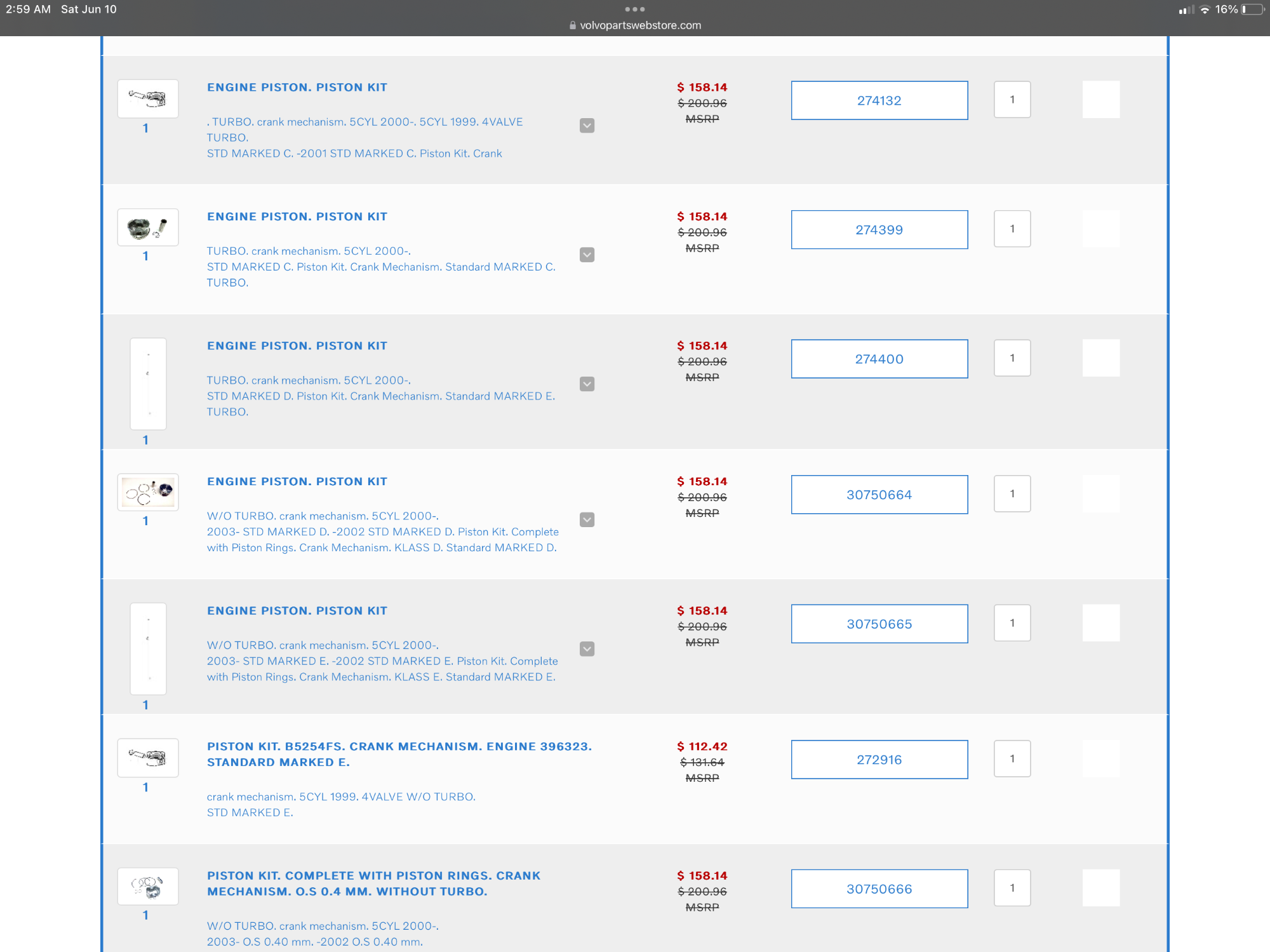

It looks like the 1 denotes the passenger side and then each piston size is denoted by a letter for each of the 5 cylinders.
In Shaggs case, D D D D D
Piston size info here…you can order them in size C D. E to match original, or oversize pistons if you have bored out your block

From Swedespeed, unverified
Corrected below post by jreed
Measure 12mm from bottom of piston skirt.
C=82.950-82.960
D=82.960-82.970
E= 82.970-82.980
0.01mm translates to 0.0004 inch or 0.4 thou in machine talk, so these are small differences in piston diameter to match variations in engine bore size
They all use the same piston rings as you would have to set piston ring end gap to spec on a rebuild to fit parts
C=82.950-82.960
D=82.960-82.970
E= 82.970-82.980
