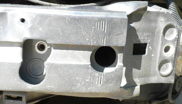

Kiddo ran into someone else's car last week, so I'm doing repairs. I have VIDA, but for the life of me can't find anything about getting the steel bumper bar off. I took out the four bolts that hold it to the frame, but there seem to be some welds (I've read hints that they need to be drilled out).
Can anyone confirm? How big a hole do I need to make, and do I need to drill all six circular areas?

I had a chance to go at it with the drill today. To answer my own questions: yes, all six areas need to be drilled out in their centers. I started with a small bit and worked up to 3/8 in, which was enough to separate the four welds on the ends. The two inner circular areas needed a slightly larger hole but I got them apart with a pry bar.
Two screws at the top of the bumper bar attached it to the so-called "front section" (30655380) which is the stamped sheet metal that goes over the radiator/condenser.
