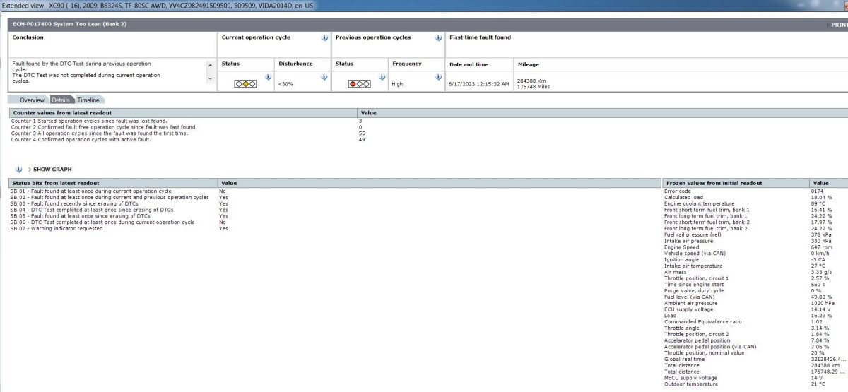

Did you open the listed code in VIDA and see what the other info was at the time the lean code triggered? Then try to figure out what is wrong with the given info? In VIDA you can trigger the intake manifold flaps to check they are working.

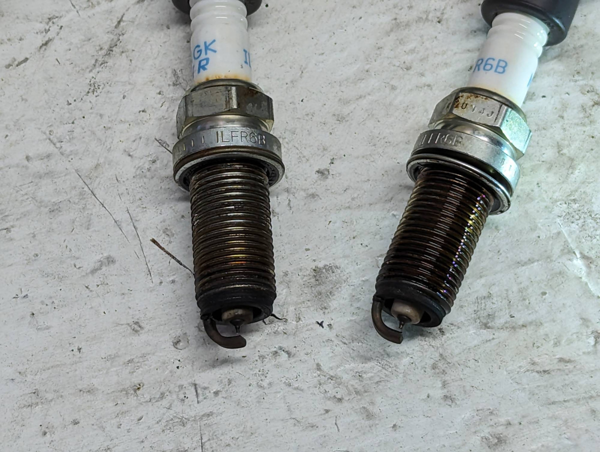

About a year ago I did the spark plugs as well, used NGK-6481 plugs. Please see below for the pictures how they came out today.

Clicking on the VIDA error message’s both of them capture lean during idle

The pics of your spark plugs are oily. Why do you have oily threads? Is it leaking oil from up top?
Is your oil cap leaking from its o-ring/gasket? A new filler cap gasket is a few bucks at FCP.
Oily plugs could indicate the PCV. If the plugs are only about a year or so old, they look worse and the ceramic looks like it overheated or ran hot, like you are running lean. I would have assumed those plugs were 30k-50k miles old. Those need to be replaced. If you were running lean and hot, the plug tips should be more whitish, but I’m guessing a bad PCV was dumping oil into the cylinders.

No leaky oil cap, don't know why the plugs look a bit oily. No oil around the spark plug area, maybe leftover fuel from running it cold (only ran it cold for 1 minute from my driveway to my garage).

Fuel should not have gotten on the spark plug threads like that. Some of the fuel should have also evaporated. Get new plugs with the other parts then reassess.

Guys, lot of helpful comments.
Some additional work I did tonight
- Put premium Shell fuel in the tank (was almost empty), no difference
- Did the glove test and it tried to suck in the glove a bit, but it did not pull it in completely. I feel like it's working properly, no whistle or anything.
- Did an A-B comparison with the old and new MAF - LTFT still the same behavior and lean codes
- Pulled the MAF completely, instant idle problems and bunch of MAF errors- LTFT still the same.
- Pulled the timing solenoids , intake manifold actuators -again a bunch of errors but no difference in LTFT
Two weeks ago i rented a smoke machine for the intake, found a small leak on the plastic tube that goes from the MAF to the intake throttle body. Fixed it by re tightening that clamp (no significant difference on LTFT) . I connected the smoke machine before and after the throttle body. When removing the oil filler cap or dip stick there was smoke coming out so I think it went through the whole intake - please correct me if I am wrong-
I am fine with getting new spark plugs but would the engine give me a rich or lean value when there is un-ignited fuel in the exhaust?
The engine sounds fine but I will try to remove more exhaust heat shields. There is not a lot of exhaust between the cylinder head and O2 sensors so if there would be a leak it needs to be around that area. Also, both LTFT's are the same so it would be coincidence both of them leak exactly the same amount. I did not do the exhaust smoke test because it sounds fine, maybe I should've done that as well.
I also tried activating the intake manifolds actuators while the engine was running but I think I am not not allowed because it did not do anything. I activated them with the engine off and both work and sound the same.
Is there anywhere else there could be vacuum leak I missed? The vacuum pump for the brake system could not leak internally or so ?
