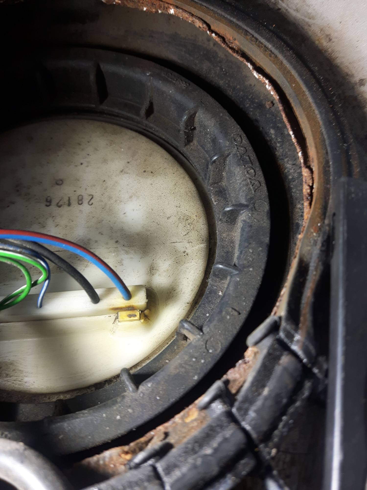

deano1
Posts: 134
Joined: 12 November 2017
Year and Model: 2001 s60 1999 awd
Location: cambridge
Has thanked: 13 times
Been thanked: 16 times
Post by deano1 »
This might be it!
S60 WIRE.jpg (245.41 KiB) Viewed 1280 times
Posts: 35321
Has thanked: 1507 times
Been thanked: 3825 times
Oh yeah! Nice visual clue. Inspecting wiring is one of those tasks no one wants to do when troubleshooting
