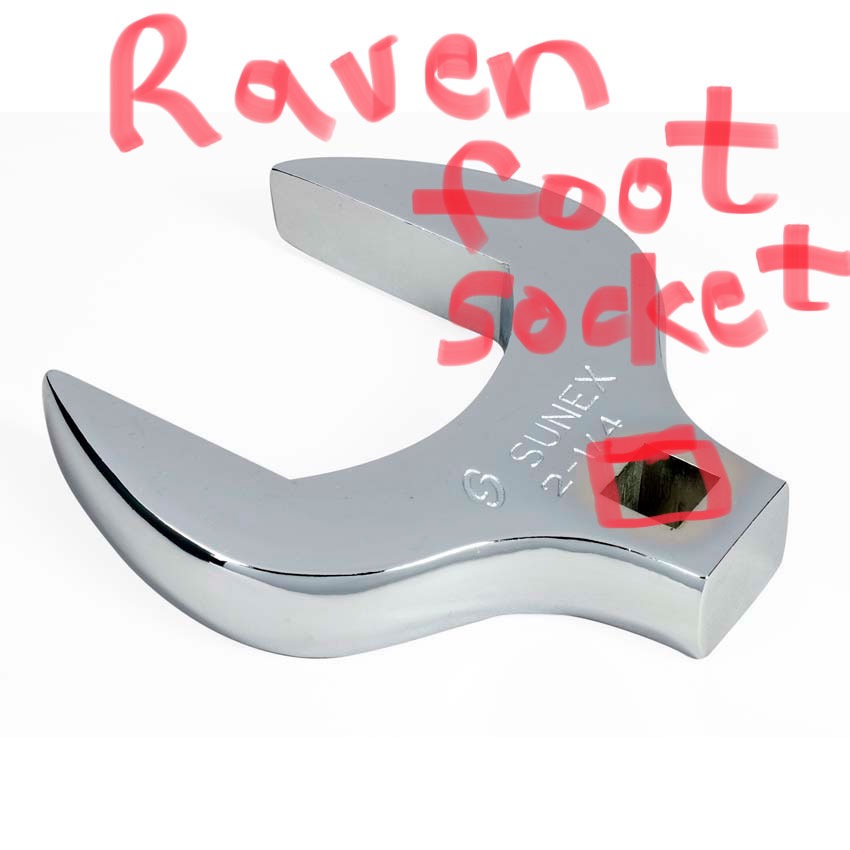

When will toolmakers figure out that if you offset the square drive relative to the hex bit asymmetrically you get a more useful tool? This lets you have applied positions in tight corners where you can’t swing the wrench for example, with out the weakness of a small geared ratchet
OXS sensor socket is a prime example

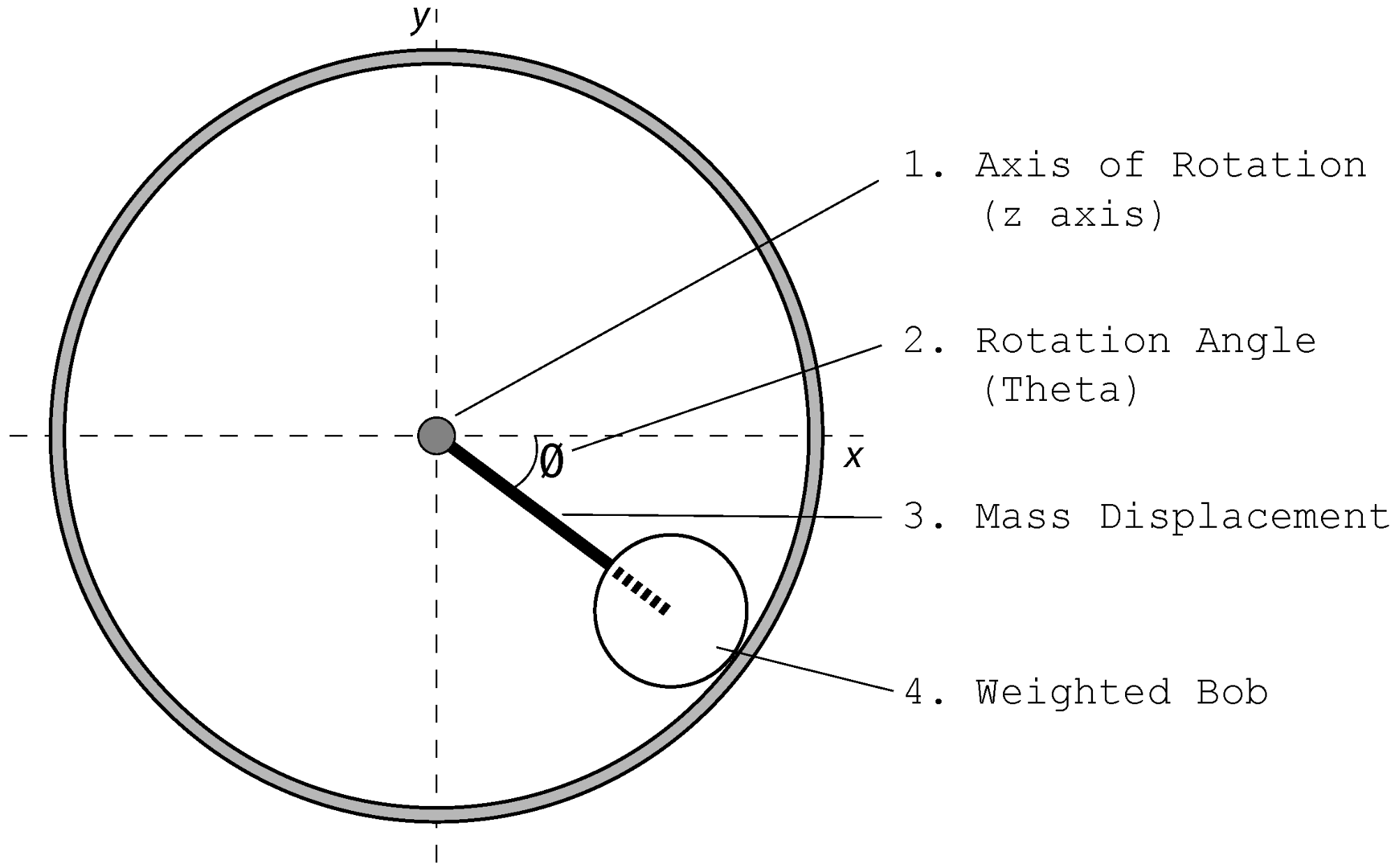

Can you explain this further? I don't follow, but I know there's wisdom in here I can use.abscate wrote: 23 Oct 2023, 03:41 When will toolmakers figure out that if you offset the square drive relative to the hex bit asymmetrically you get a more useful tool?
For instance, do you mean a wrench angle off the flat plane (ecliptic)?
Or maybe I'm reading too much into it, and you mean an actual offset between the force center and the hex bit? i.e.: force at X=0, Y=0, but bit not at X=0 and Y=0 in this:

Those Harbor Fright ones are great because the have off set the drive , just like I mentioned above. In tight corners , this gives you a way to make small turns to get something off…I’m thinking of you, power steering rack line flares ( actually oring fittings)
Picture if the offset concept, hereafter called raven foot sockets
- IMG_1029.jpeg (58.78 KiB) Viewed 739 times

+ 1abscate wrote: 13 Nov 2023, 03:04 Those Harbor Fright ones are great because the have off set the drive , just like I mentioned above. In tight corners , this gives you a way to make small turns to get something off…I’m thinking of you, power steering rack line flares ( actually oring fittings)

Corvidae wrenches?abscate wrote: 13 Nov 2023, 03:04 Those Harbor Fright ones are great because the have off set the drive , just like I mentioned above. In tight corners , this gives you a way to make small turns to get something off…I’m thinking of you, power steering rack line flares ( actually oring fittings)
