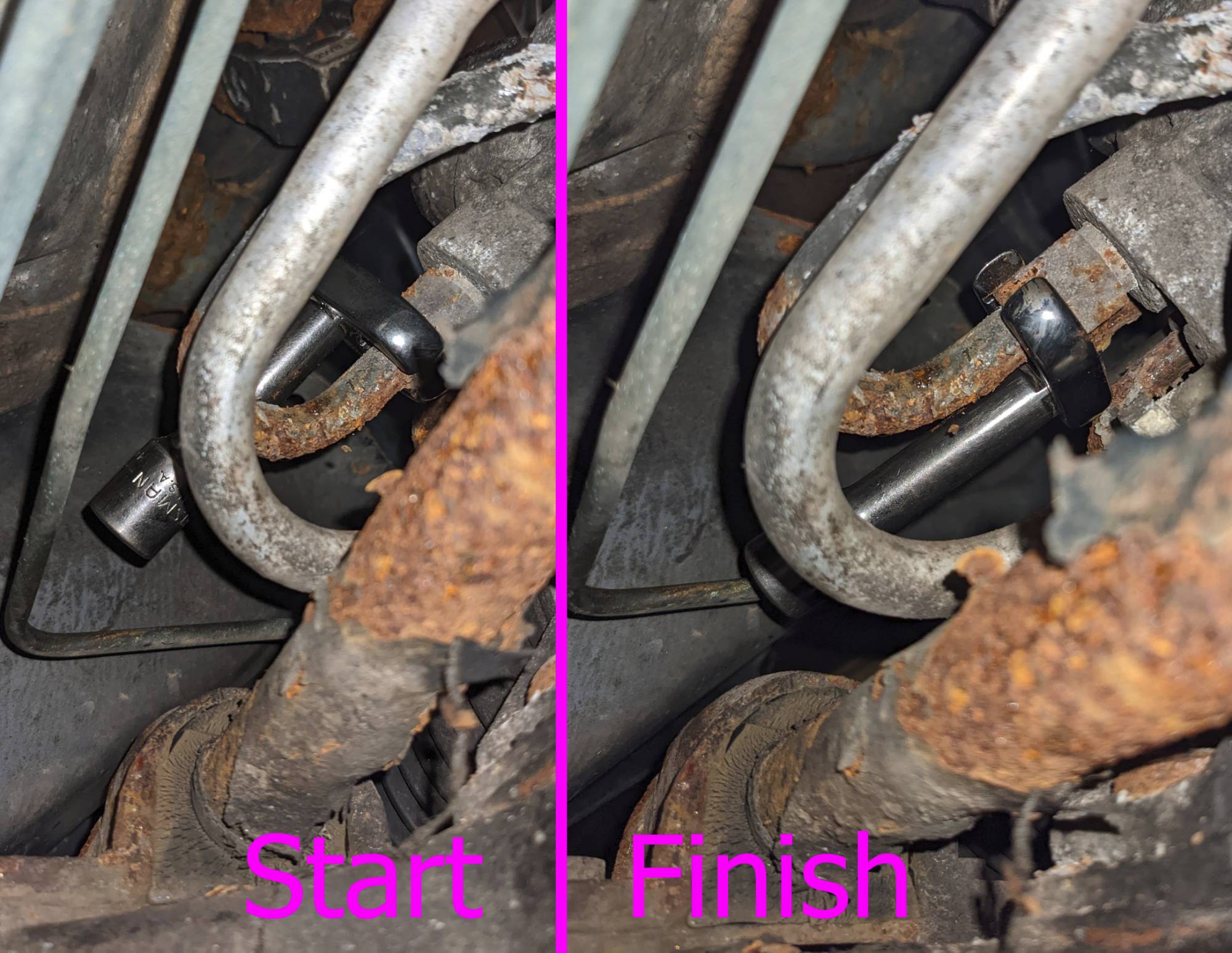

Replacement is the only real solution for this line. With a good flare nut crowsfoot wrench, it seems like a straightforward job. I'll reply here once I do it.
I bought a quality MAC Tools flare nut crowfoot wrench set used on eBay. I'll think it's reasonable to replace the line with the rack entirely in place. Remember to get a new green o-ring for the line.
Edit 11/10/23 - Don't try to flare a new section on to this line. The original is 10 mm and the only reasonably accessible replacements are 3/8". You'd have to shave down a 10 mm line to 3/8" to match which would decrease the metal wall thickness, weakening the line. Assuming it's already rusty, it's weakened, so shouldn't be weakened further.

On rusty and neglected Geronimo, I removed the power steering fluid input line rather easily. It was slow work turning a crows foot 1/4 turn before removing and resetting it, but it came off.abscate wrote: 07 Oct 2022, 05:29 Crows foot on the 16mm hex fitting with rack installed?
Maybe on an 850min a pristine CA car but in the northeast on a V70 that is not happening in my humble experience in 2021
Before installing a new line, ensure that it is bent exactly the same as the old line. Every angle must match for it to both feed in under the rack properly and seat properly into the rack. The U shape right at the rack is critical to match the old or it won't seat and its fitting threads will not catch.
I replaced the line with a used one from abscate. I don't detect any leaks in the system and my steering is restored. Well, almost. When making a turn from a stop, the steering is hard until the car starts moving. I hope that's just air in the lines and not a ruined pump from driving without fluid.
Moral of the story: With a steering fluid input line leak, don't drive the car and replace that line immediately. It's expensive and awkward, but possible and will truly solve the problem.

An heroic effort, well done. That quality crows foot money was well spent.FireFox31 wrote: 02 Dec 2022, 22:39On rusty and neglected Geronimo, I removed the power steering fluid input line rather easily. It was slow work turning a crows foot 1/4 turn before removing and resetting it, but it came off.abscate wrote: 07 Oct 2022, 05:29 Crows foot on the 16mm hex fitting with rack installed?
You New Englanders have epic issues with rust. So far all my rack round trips have been with the subframe on the floor. Thinking about it makes my head hurt.

Your thoughts on air in the lines may be correct; try jacking the front off the ground and turning the wheel lock-to-lock ten-12 times (I did it engine off). Dunno what the book says about it, but cured mine. I thought I was in for a fourth round trip on the subframe.

I missed that those were flare crow feet. I wonder if that’s the difference
