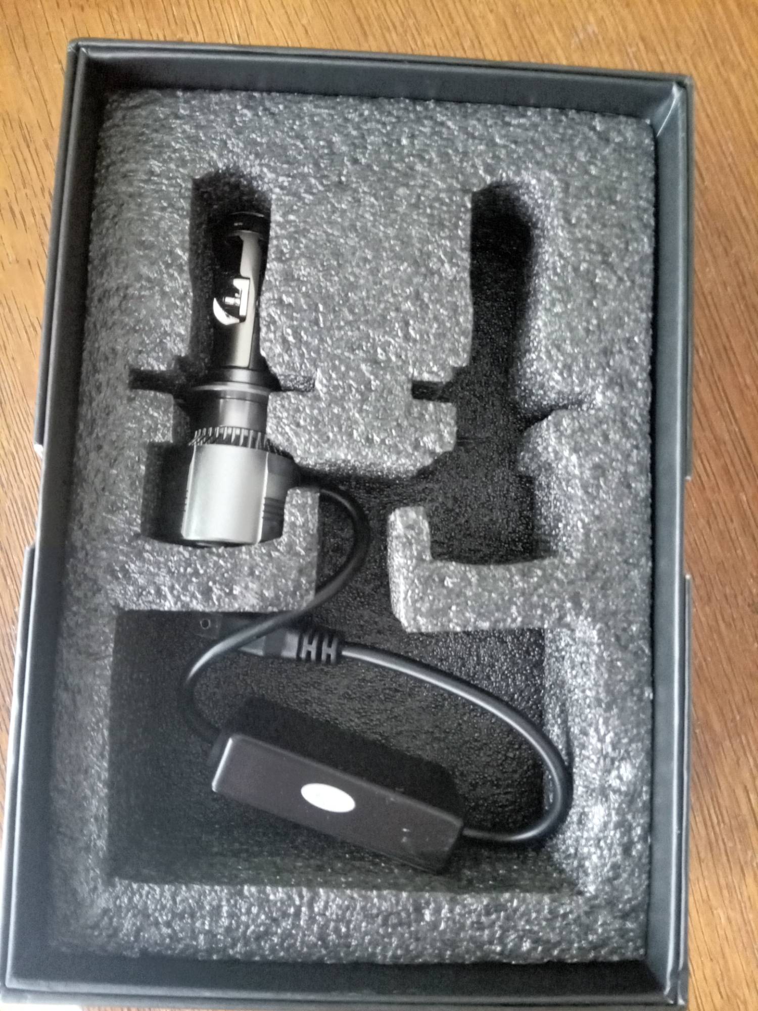

A pair of mini bi-led projectors ($40) are available on eBay. They are also on Amazon but my order was never delivered on my first order and was cancelled on the second ... I don't know why.
I installed one in just a few minutes, didn't even remove headlight cover. I did bend an internal bulb shroud out of the way with a screw driver through bulb opening and I can't put on rear cover anymore. Also only one side of the bulb retaining lever snapped in place during initial install. I'll try to resolve that later.
I bought the one with the least amount of lumens as I didn't want to blind incoming drivers. I took a quick drive last night and worked great ... I can see now!! I haven't even replaced the 2nd bulb yet.

This is different than the LED you chose. It is a mini led projector. It has a small lense on it with a cutoff line. However, once installed the headlight cover blurs the cutoff line. I figured I'd consider sanding/polishing cover if it was too blinding. However, upon further inspection, the headlight cover/lenses fluting appears to be inside not outside. So, I still have to take the lense off if I want to do that ... Bummer.MoVolvos wrote: 22 Oct 2023, 19:07 .
