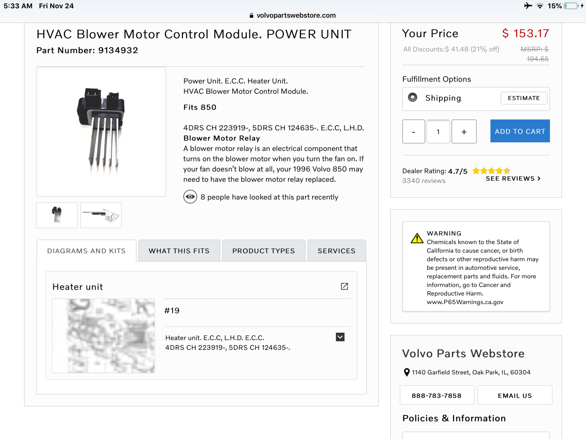

The blower speed is controlled by modulated current from the transistor pack that lives down in the climate unit. It’s either that or the ECC control unit that has shuffled off its mortal coil, to quote Shakespeare.
You can look for codes on ECC with the Underhood portal and the LED tool, too.
For the resistor or transistor pack ...
9134932 if you have Manual climate control
9137937 if you have Electronic climate control

!1 with Abscate on the single speed points to the control what has become known as the 'resistor pack', in the pipe from the cabin fan motor to the rest of the heating system.
