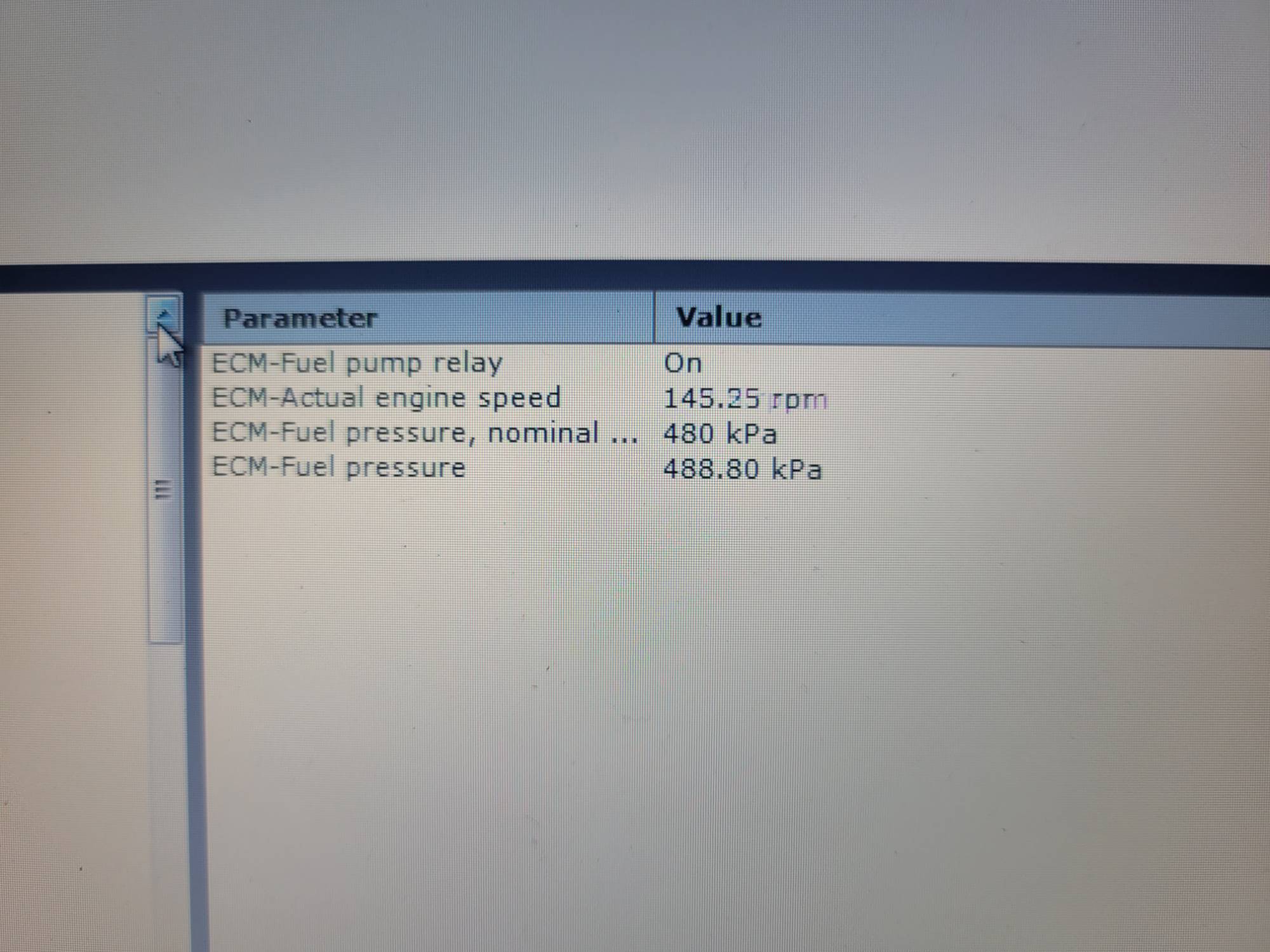

Wondering if anyone has any ideas...Have a 2006 V70 that wouldn't start today and has had no recent problems, tach doesn't move at all while cranking and there's pressurized fuel in the rail.

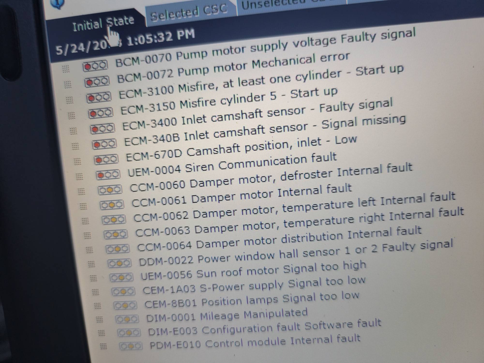

I hooked up my OBD tool and it has no codes stored and VIDA/DICE is showing 3400 and 3400B, Camshaft sensor signal intake missing. I pulled off the cover and there are no broken parts and the rotating part seems tight and is spinning while cranking.
I'm kind of at a stopping point now.
I have a 2003 xc70 (parts car) I swapped the sensor with and it still doesn't start and the code is still there in VIDA/DICE but I'm very much a beginner to that software so not sure if I cleared it first. I guess it could be either a wiring problem or that sensor is not compatible, is there a way to pin out the sensor to see if it's shorted or open? Thanks

3400b doesn't bring anything up in google.

jonesg wrote: 25 Nov 2023, 14:26 3400b doesn't bring anything up in google.
Think it was ecm 3400 and 3400b, it was in VIDA/DICE, not from a generic OBD scanner.

ecm3400 is the knock sensor
ecm3400B doesn't seem to exist.

Looks like the codes I'm concerned with are ecm-3400 and 340B, think the misfire on cyl 5 is just an anomaly.
Second pic is as the car is cranking so it's getting fuel, checked at the schrader valve.

I am showing rpm on vida/dice while cranking and saw somewhere that it means the intake cam sensor is reading, the tachometer doesn't move while cranking, though.

SVO LOU wrote: 27 Nov 2023, 05:08 I am showing rpm on vida/dice while cranking and saw somewhere that it means the intake cam sensor is reading, the tachometer doesn't move while cranking, though.
vida might be getting rpm data from the crankshaft sensor because its indicating the cam signal is missing.
cranking speed before the engine fires up doesn't show on the tachometer.
