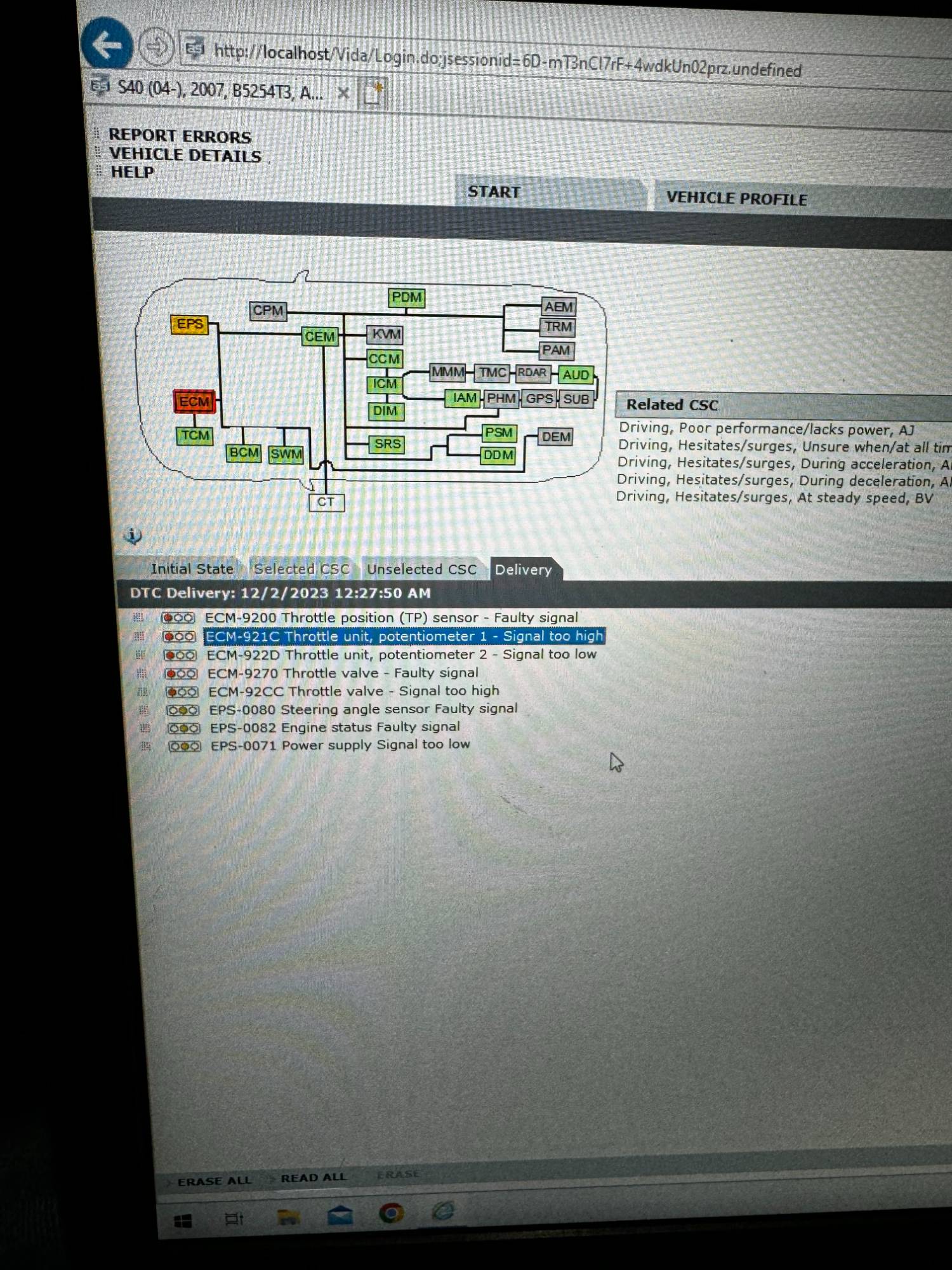

Currently VIDA shows 4 errors related to Throttle Body Unit:
ECM 9200 TP sensor faulty signal
ECM 921C Throttle unit potentiometer 1 signal too high
ECM 922D Throttle unit potentiometer 2 signal too low
ECM 9270 Throttle valve - Faulty signal
ECM 92CC throttle unit signal too high

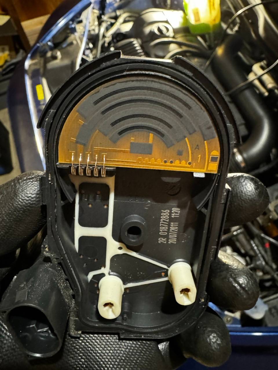

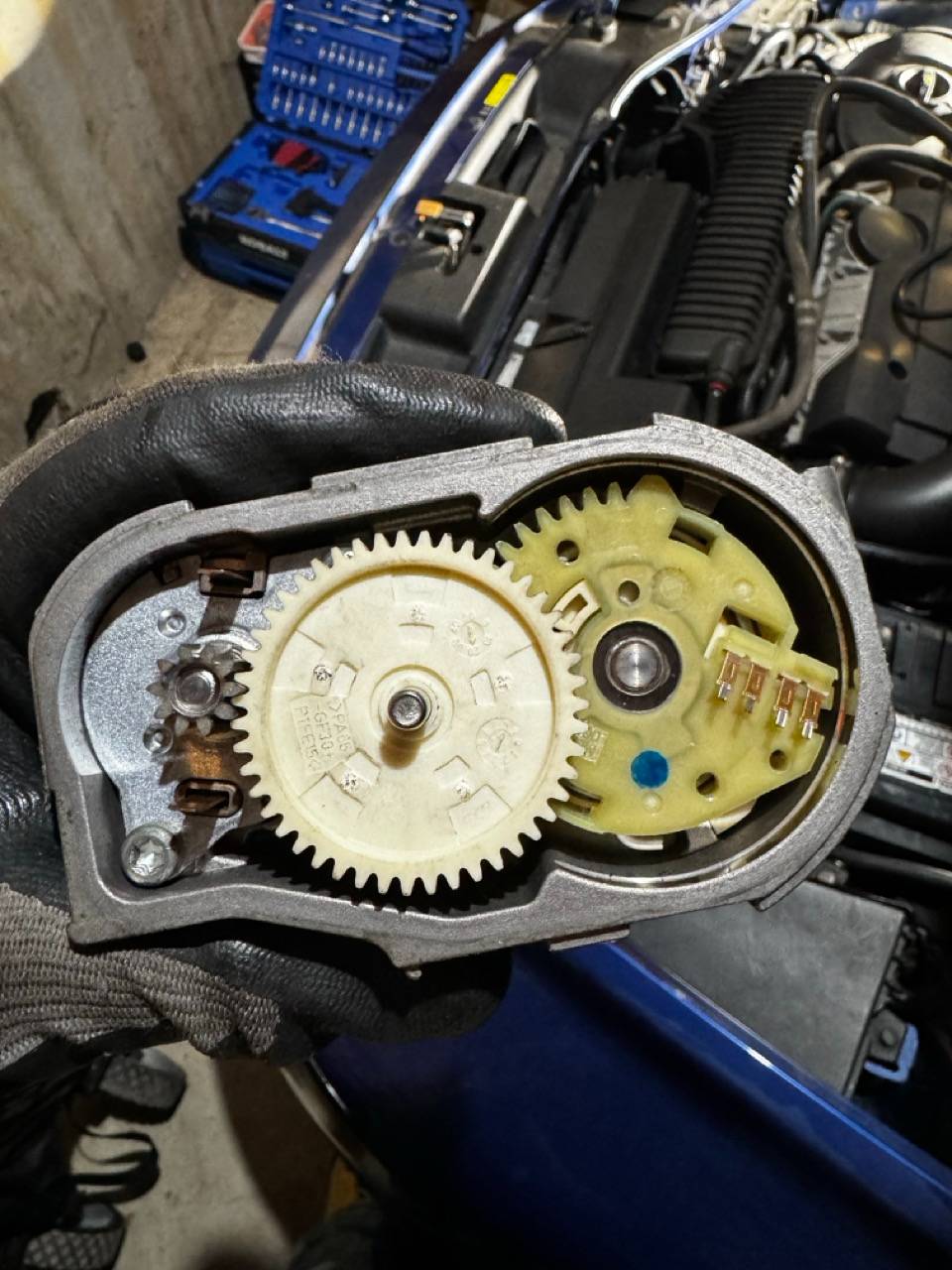

I disassembled the unit and noticed that tracks were too bad but it worked so I bought another one used. Installed it but nothing has changed. The new unit inside looks good (see pics).

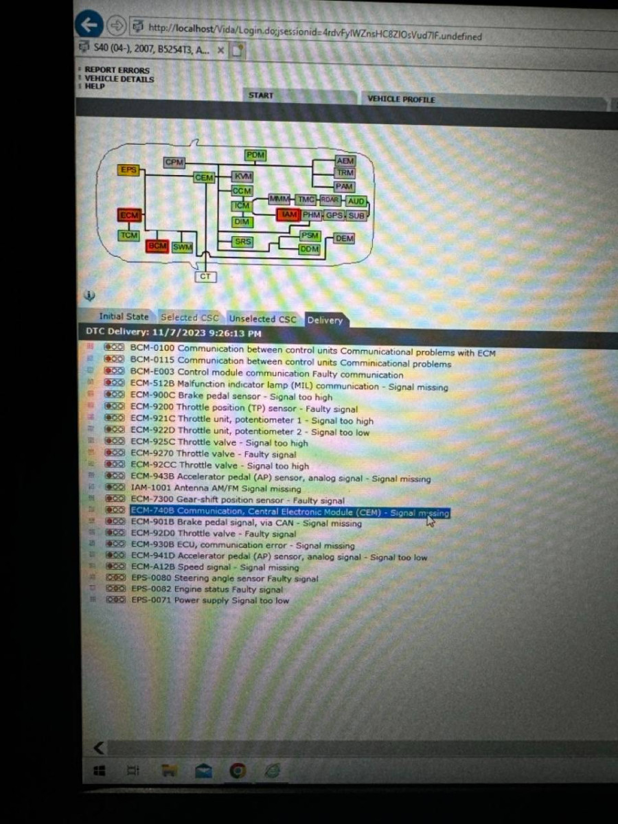

My last theory is that CEM is dying or dead, because when I read car with Vida and ignition ON everything is OK, but if launch a car 3/4 of a car's modules turn in red, dozens of DTCs, car behaves like crazy -wipers ON/Off, dashboard shuts off, ABS, SRS, Immo, Brake failure, doesn't give the key - all of these pops up but never re-appear after erase. Only if I read a idling car with VIDA.

I bought used TBU on eBay but it also turned out bad. Then I just part out both units and assembled 1 with the best looking parts.
