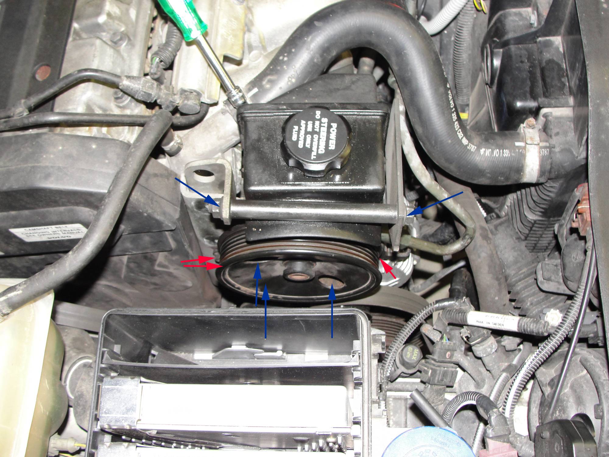

- Red arrows are heads of three long bolts to be removed from passenger side. Blue arrows show bolts to be loosened. Electronics box lid and hose removed.
- PS Pump bolts and three long bolts.jpg (349.07 KiB) Viewed 448 times

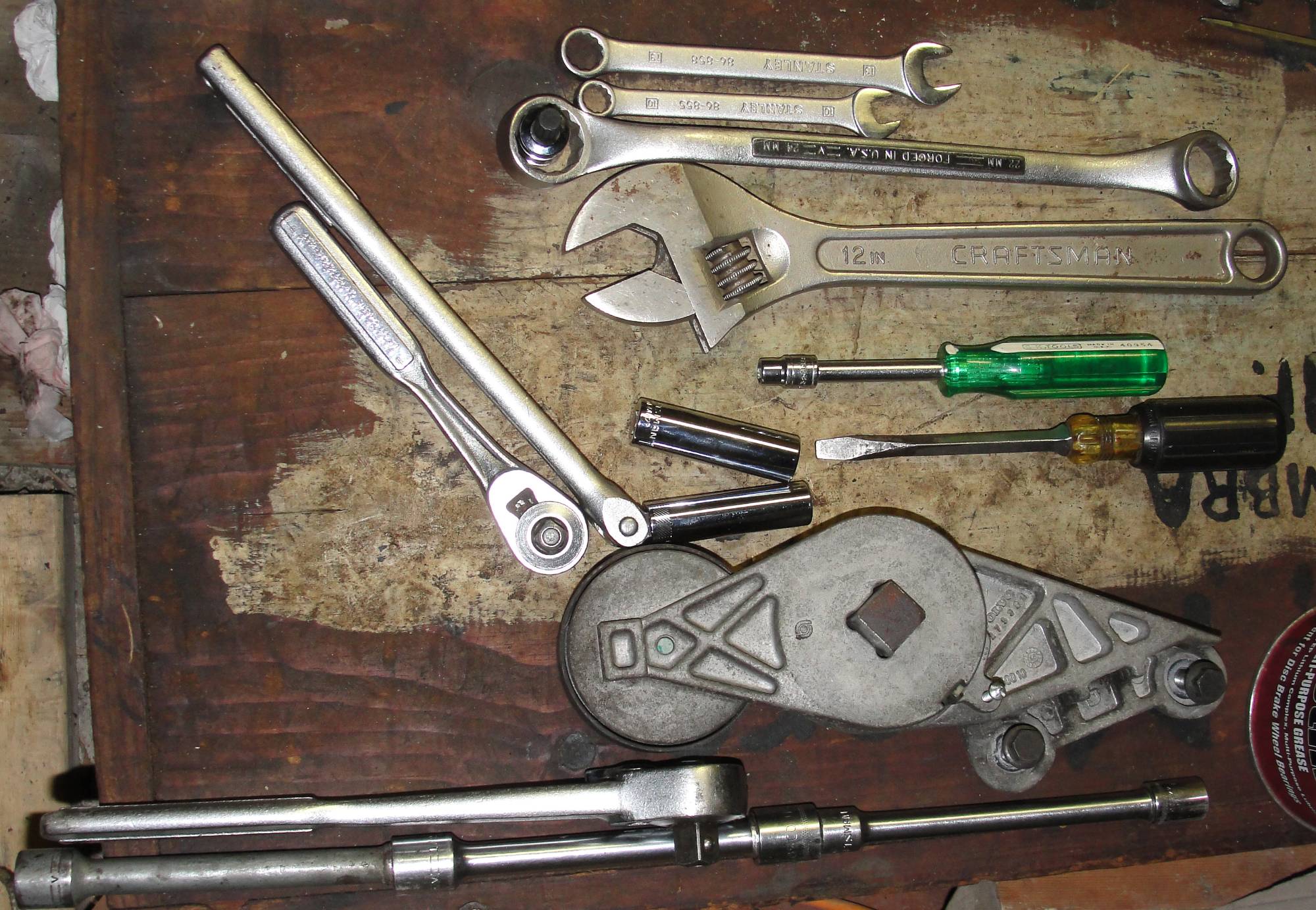

- Tools used. Note 19 mm steel in tensioner. 24 mm box and 10m tri-box spline are for alternator nut removal. Impact is better.
- Tools.jpg (412.65 KiB) Viewed 448 times

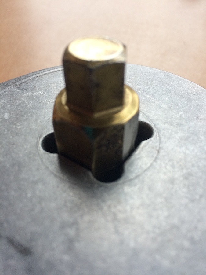

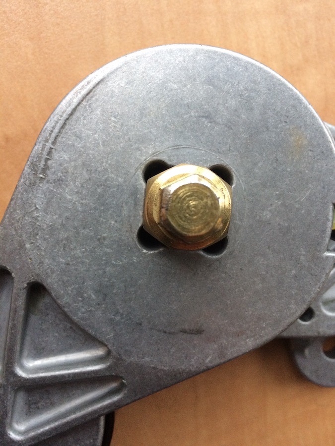

I've read somewhere that the tensioner is designed to take a standard 3/4ths socket. I haven't tried it myself but this may improve the guide. I'm invested as I may need to pull mine out if my low voltage isn't just wiring related.

I read the opposite comment somewhere that a 3/4 drive tool would not fit. Since I do not have a 3/4" drive bar or ratchet, I could not test this. I did not want to take any chances since there was no way to do a precision trial fit. I ground a few thousandths in each direction off 3/4" square steel stock I happened to have on hand, until a caliper showed 19mm. Then I hacksawed it off to roughly 1-1/8" length.RedBrickCollector wrote: ↑02 Jan 2024, 12:19 I've read somewhere that the tensioner is designed to take a standard 3/4ths socket. I haven't tried it myself but this may improve the guide. I'm invested as I may need to pull mine out if my low voltage isn't just wiring related.
People use all kinds of solutions - I was about to try: square nut with a bolt and second nut to lock the bolt with the square nut. Mine is good old fashioned solid steel, with a large crescent wrench to torque it.
Regarding your low voltage, mine was really low - under 12 V. New alternator is 13.7 at idle.
The only thing my post adds to the posts and videos I have seen is, releasing the sides of the PS Pump cage by loosening the three bolts that attach the pump to the cage plate, and the top long bolt perpendicular to those, is critical, so that it lifts right off and can be placed back on the alternator.

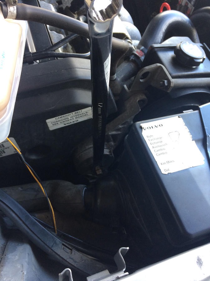

- Posts: 35298
- Has thanked: 1505 times
- Been thanked: 3817 times
I once spent a good hour trying to figure out how that cage went back on a 1998, just staring at the pieces. I, too, struggled to find good documentation on it.

3/4" square will fit into the tensioner aperture, unfortunately there is not enough clearance to get it in when the tensioner is fitted to the car as it fouls on the ECU box. My work-around was to take a sump drain plug which has a 19mm body and file two corners off to make a hexagon fit into a square hole. 19mm long reach spanner and it works a treat
