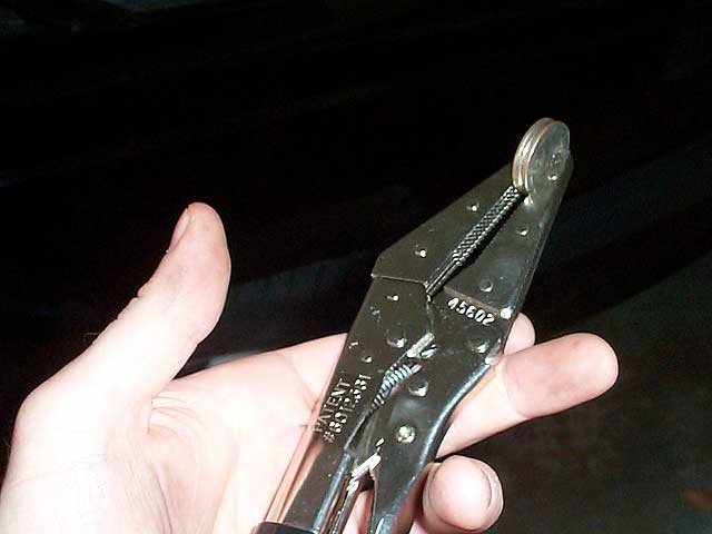

Yes,you need a special tool...but good news is that you can make your own :) .
Here are the pictures of "do it youself" serpentine belt tensioner tool:

The hole in the tensioner is designed to accept a standard 3/4" drive breaker bar. There's not enough clearance to use adaptors.

Could not find the parts to make a nice tool so I just used 2 quarters and an adjustable wrench. With some fooling around worked fine but bent the heck out of t he quarters. Thanks for the help.
