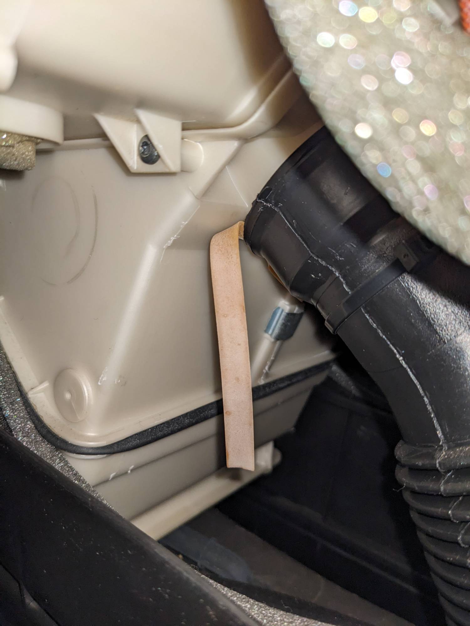

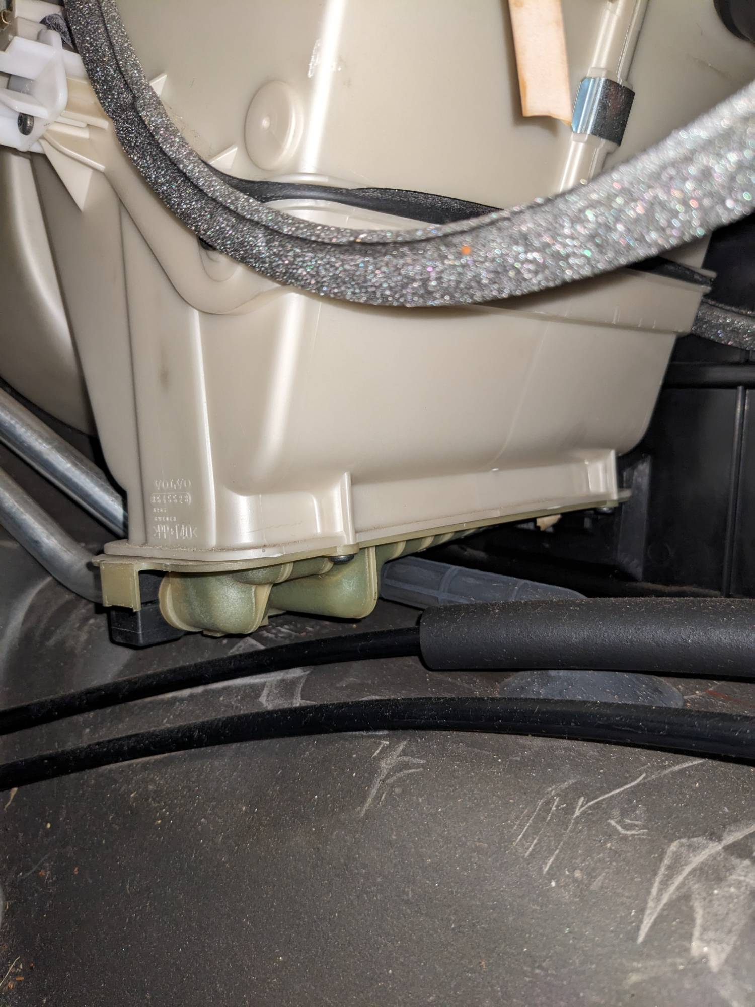

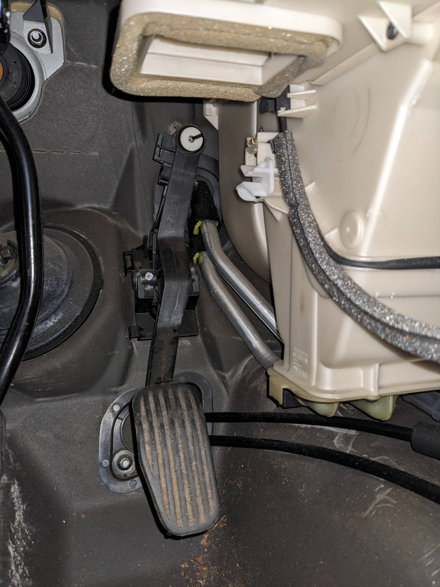

I haven't noticed any moisture around the windshield vents but pulled the carpet back anyway after reading heater core is a common point of failure.
Everything looked clean and I couldn't find any fluid or coolant smell so imagine that the heater core is still good? Maybe it's worth running the car until it's up to temp and see if anything comes out.

There can still be coolant leaking out of the core and remaining inside the plastic box, which then evaporates and gets sent into the cabin through the vents. If it smells like coolant in the cabin, the core must be leaking.
It sounds like there are two problems here, one in the cabin (the core) and one in the engine bay (the thermostat and/or ECT).
