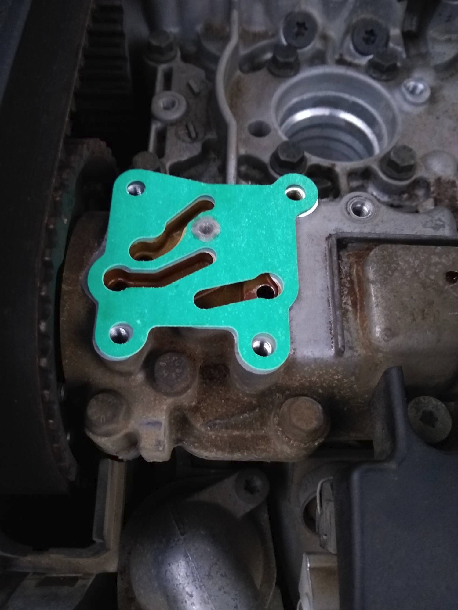

I bought a non-running S70 at auction. It has the 56 code B5254T engine (verified by engine serial number. But - it has provisions for an intake VVT. (That isn’t there) It’s my understanding the ‘99 T only had VVT on the exhaust. Has someone replaced the head at some point? It’s a California car if that makes a difference.

They use the same casting for both NA and turbo heads, thus why the (unfinished) provision for the intake VVT is there. It is not open/functional.

From what I have worked on the 99-00 P80 cars have a VVT solenoid on the intake only on NA engines and exhaust only on turbos.

.scot850 wrote: 18 Mar 2024, 22:07 From what I have worked on the 99-00 P80 cars have a VVT solenoid on the intake only on NA engines and exhaust only on turbos.
Good luck with your new challenge!
+1. NA is on intake side only. Already stamped / cast except holes are drilled.

99 NA…no VVT
99 Turbos Exhaust VVT
2000 NA intake VVT
2000 turbos Exhaust VVT
ECUS dOnt swap, which is moot as they are pinned to VIN anyhow.
The two solenoids are unique
Definitely search by engine number as there may be a engine number break on these changes, not a VIN BREAK
On top of this , there is a transition from 7mm to 6mm valve stems as well as hydraulic to mechanical lifters in the head in 1999
