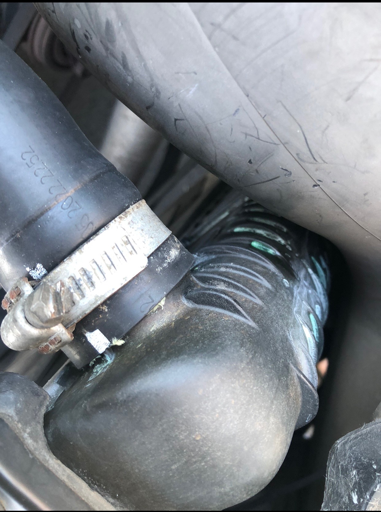

In the meantime though, I was able to quickly take a pic before heading off to work today which shows coolant on the fins. Maybe this picture could be of help?

I see you have the plastic top tank on the radiator. I think we both assumed you had the metal tank. The plastic tank necks are prone to cracking over time. Inspect for cracks and confirm there is a metal ring inside the neck to support the clamping squeeze.
Looking again, that may be a side, not top, tank. Same things to check.

OH, plastic! Disregard my advice.

Okay so I was finally able to check. I do not see any cracks around the side tank and the neck, and I think I do feel a nice metal support piece inside.
Also I took it for a drive today and no leaks, even stood around for a bit with the car idling and then with it off, no visible leaks anywhere. Previously when it had leaked, the expansion tank was filled all the way up to the max line, this time it's still in between min and max, maybe that could have something to with it?....idk, all I know is that the plot thickens.

Consider it may be fixed - but watch closely!
