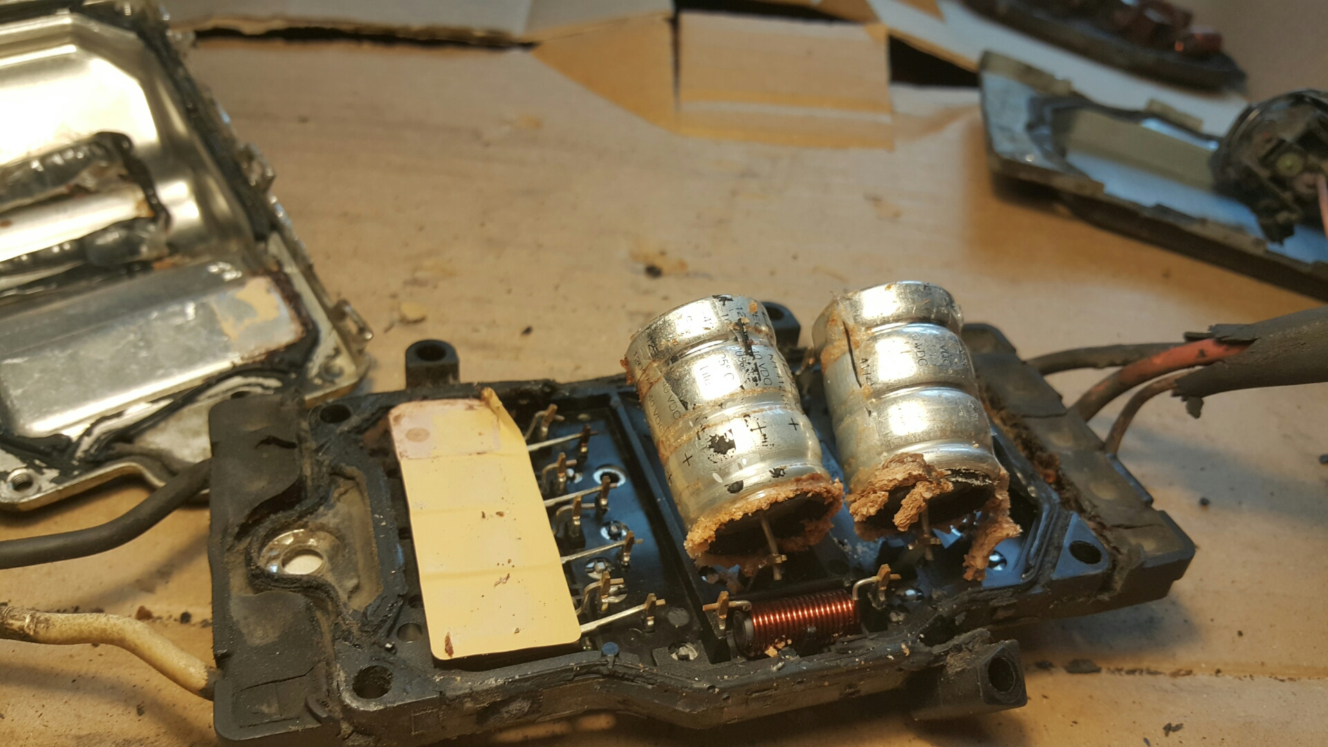

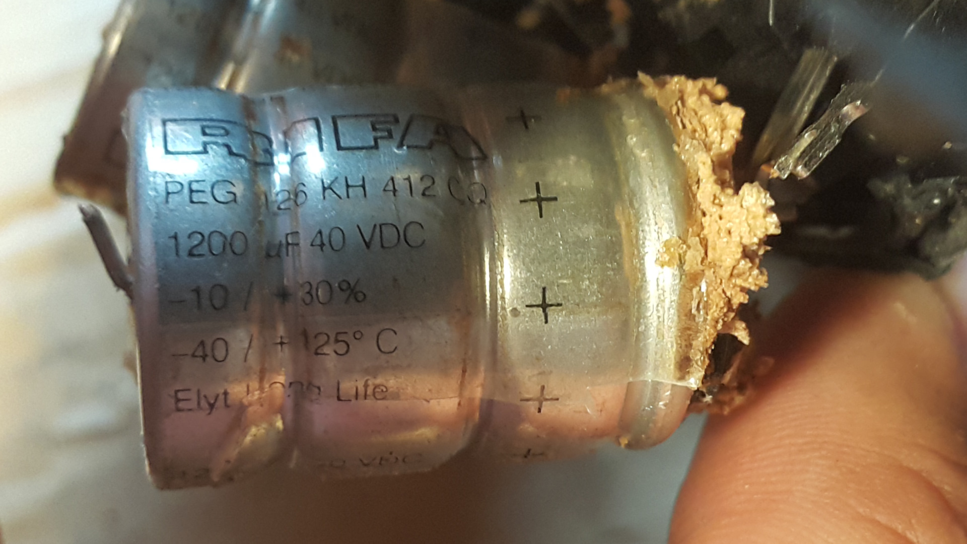

The control module has internal failure - there are capacitors that die throug time and needs replacement
Sometimes the electrolytes runs out and destroys the main board and it's elements.
The fan cold be replaced for the restyle one
You will have an error ECM-6110 in case of replacing fan-module for the restyle one, high efficiency type - it has twice much blades on it, and integrated with motor control unit
People say the configuration should be changed at dealer of elsewhere for ECM to realize that new unit type was installed. Unfortunately its not "plug and play"
Have same issue by now. Fan is working fine and correct, only the error in Vida is an issue.
That's the comparison pics
