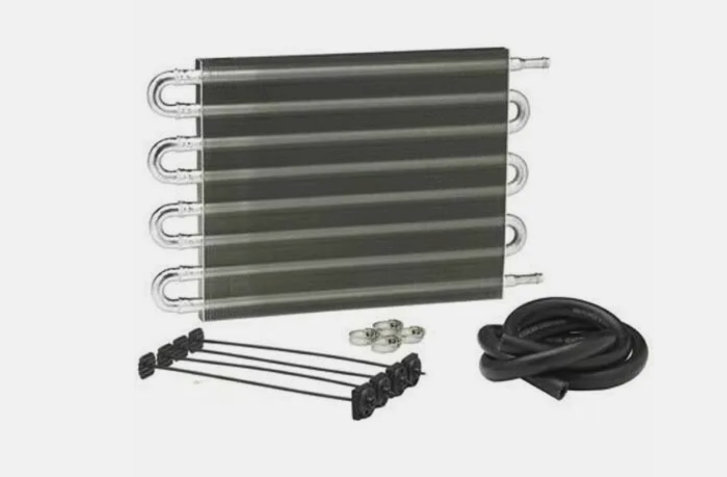

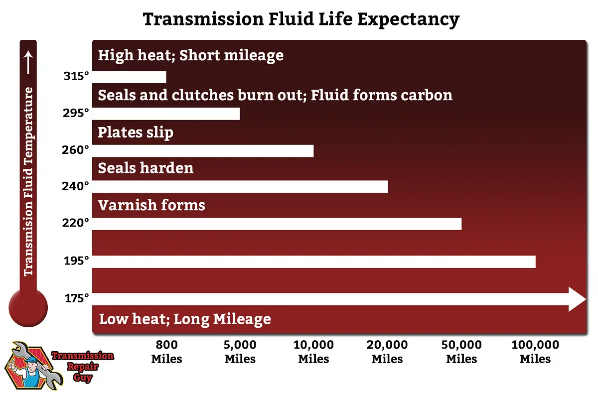

I have bypassed the radiator's transmission cooler altogether in the 03 Honda Odyssey for probably over 5 years now. Currently at 248K and have never seen temps over 180 all year round. Using a temp gun at the cooler for measurement. The slight bump click when putting into gear at start up is gone and so has the slight slip in the lower gears from time to time. The fluid still looks clean without any smell.
When warmed to operating temp the transfluid will be about the same as the radiator so around 170 - 180. With the auxiliary cooler in front of the radiator and ac condenser it will always see ambient and even on a hot day at 100 so it's quite a difference from 170-180. Heat is the enemy of the transmission.
Same unit in the 03 Odyssey.

Since the problem is heat related I would say get a cooler ASAP in order to potentially prolong the transmission and from further damage. I believe the upper is the return line from the radiator to the transmission. You can either cut that line and insert brass barbed connectors with the same inside diameter of the line and install the cooler in front of the condenser or you can just remove the line at the transmission. If there is a difference in shifts from the reduced heat do a complete flush.
To be honest the reason I bypassed the Honda radiator was my friend had a bent unit delivered for his Odyssey so Amazon provided another. The radiator in my Odyssey from eBay lasted a year or two so i decided to try his bent unit not knowing how long I had with the Odyssey. The radiator's aluminum threads of the trans-cooler stripped easily so after much research decided it was okay to bypass it. Can't believe it has been running great for so long.
The reason for having it at the discharge line of the radiator is during the summer it will be as hot as the coolant so you want the fluid to have the ambient air cool it further before entering the transmission.

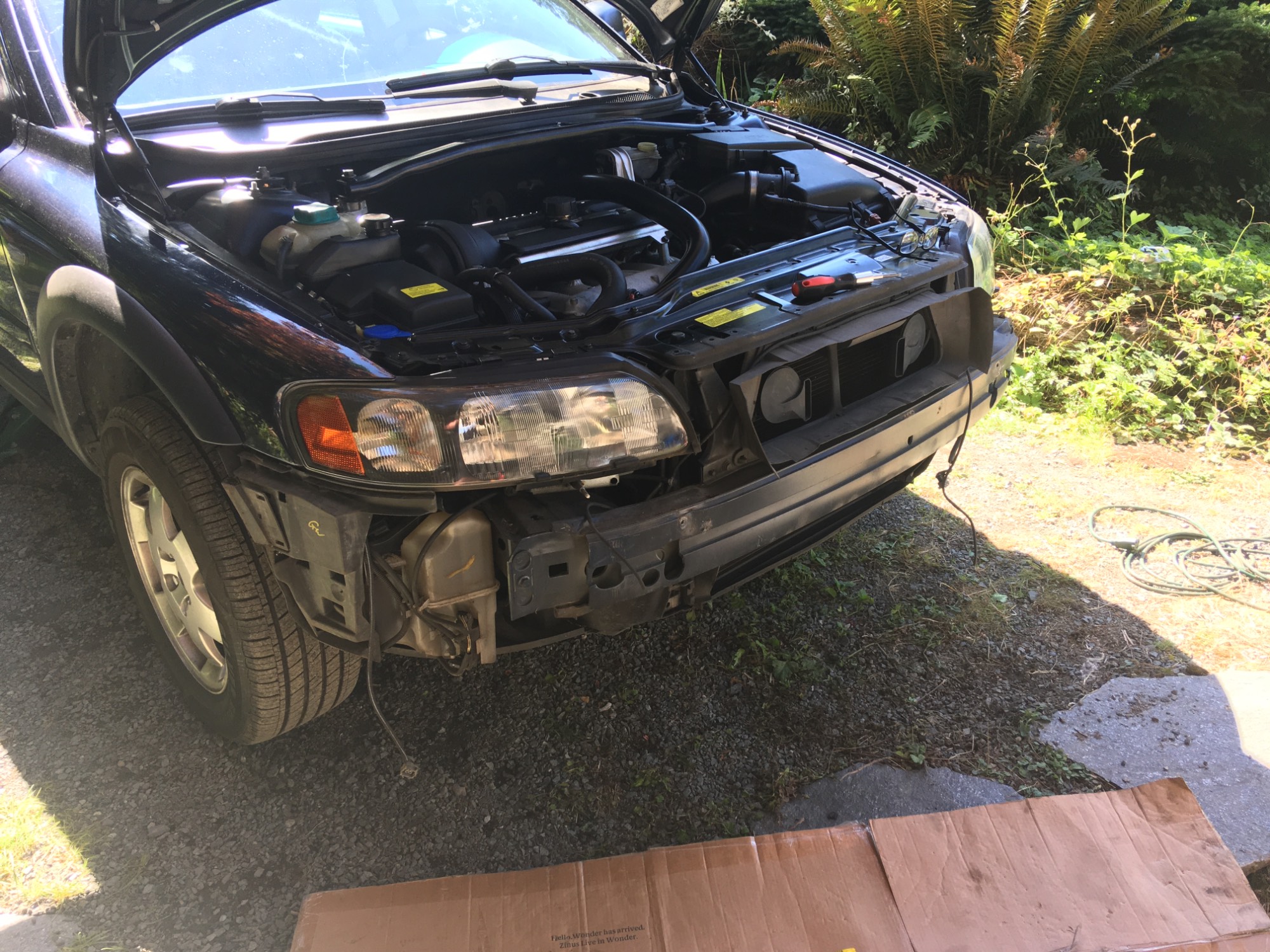

OP, I agree w/him; I have found the complicated brackets unnecessary and the “zip tie” ones adequate. I’ve put a few trans coolers in different vehicles of mine over the years. One being a 2004 XC70. It’s not hard. Do it downstream of the existing cooler as Movolvos said if you go that route.
Honestly though, cooling capacity is unlikely your main problem (though more in these is a good idea). Have you tried addressing the health of the valve body solenoids? I’ve cured ills with them by using Lubegard AT protectant (the red bottle). Amazon has a very good price on the quart bottle right now. The ester oil base will clean the bores and pistons, and condition the seals. This will improve response and line pressure. As an added bonus, the ester oil will improve heat transfer in the unit and drop temps (just a bit, not a lot - I’ve actually tested this with external temp gauges in a GM transmission). Normally I would start with a more aggressive, very short-term cleaning method and then swap all the fluid out at once. But if you’ve done several drain/fills, you may want to skip that and just let the ester oil work a little more slowly for you.
If you put in a cooler, it’s pretty easy. The hardest part is only getting the bumper cover off; this was when I put the cooler in the XC. From here you have space to insert the cooler and access to the existing cooler lines to splice into them.
