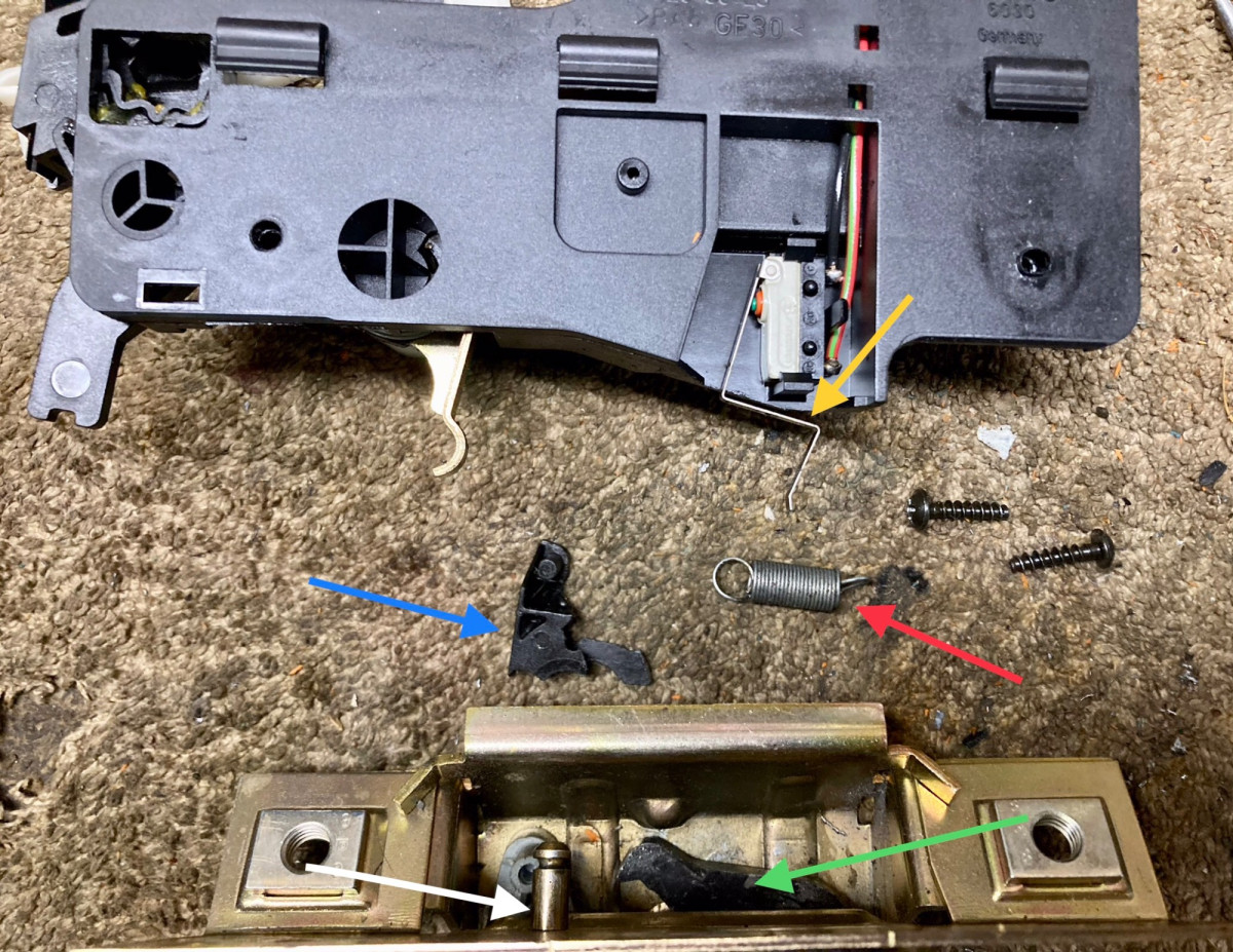

My hatch open light has been coming on a (long) while and I am finally sorting that. New latches are running $250 to $300 now so I was motivated to research it and see if it was repairable. Looks like it is.
Inside I found the plastic surround (blue arrow) that closes the microswitch (yellow arrow) all fractured and loose, as well as the return spring (Red arrow). It looks to me like if I epoxy weld it back in the right place (latch, green arrow), and re-attach the spring, I’ll be good. I am thinking the spring goes from the latch plastic surround (blue arrow) to the alloy anchor post (white arrow).
- anyone know precisely where to reattach that surround and the spring?
Who here has been inside a late P80 8628197 9203955 hatch latch? Latchectomy in progress… Topic is solved

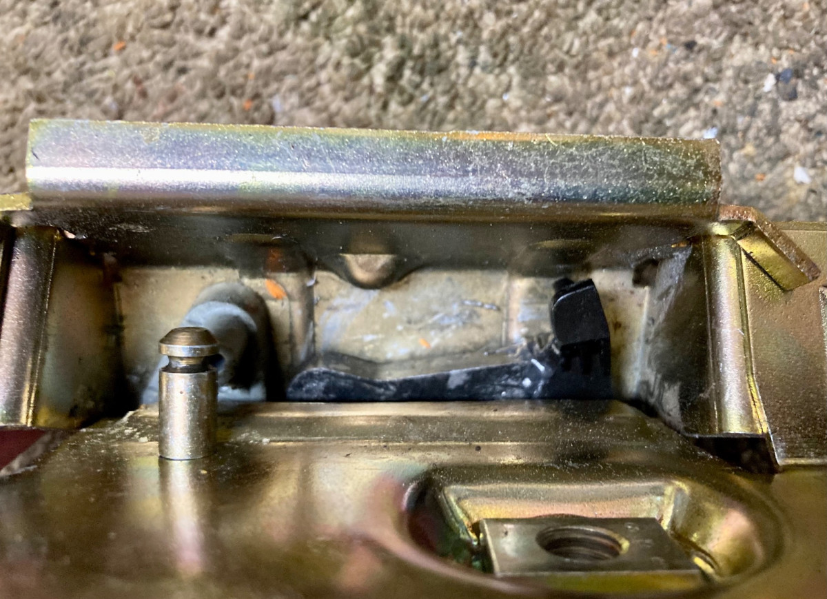

Actually, I think I’ve got it.
I found this post at SS where someone did this before and helpfully documented it.
https://www.swedespeed.com/threads/v70 ... st-7907521
I JB welded the spring post piece on that corner of the latch; it fit correctly, and should reliably depress the microswitch lever once assembled. We’ll let that set-up overnight and then hopefully I’ll be good, and not out $250 for this silly issue.

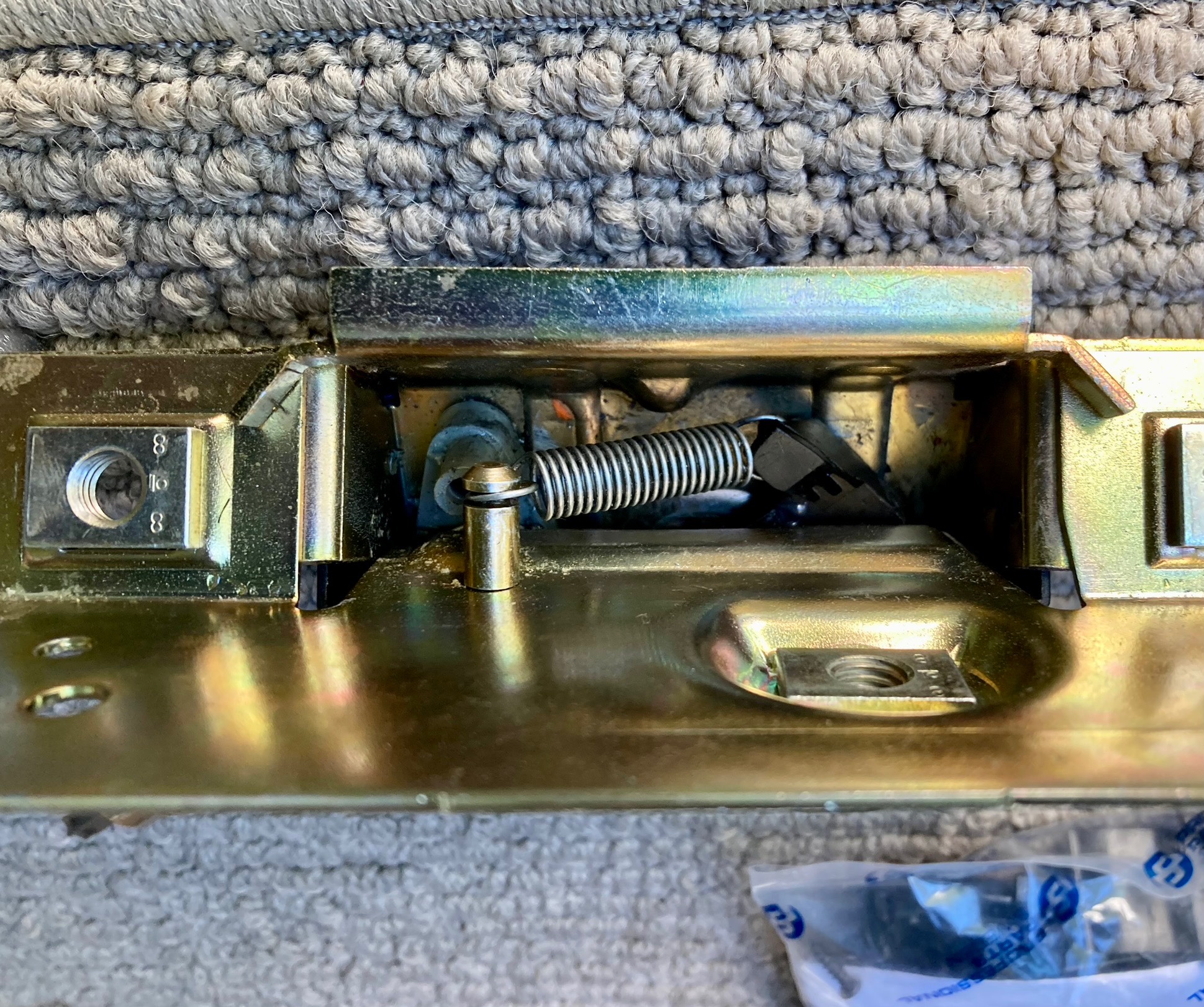

Success.
Re-attaching that tab as pictured fixed the warning light, it trips the microswitch correctly now.
The latch hook return spring goes to that tab. All back together and working well. Now. This was a much easier fix than I anticipated. If you do this repair one thing I would suggest is to use proper JB Weld and not a cheaper epoxy - there is a difference. I keep the HF cheap stuff around for small tasks, but not something like this where I am loathe to want to go back in and do it again.
Here’s the complete assembly.
