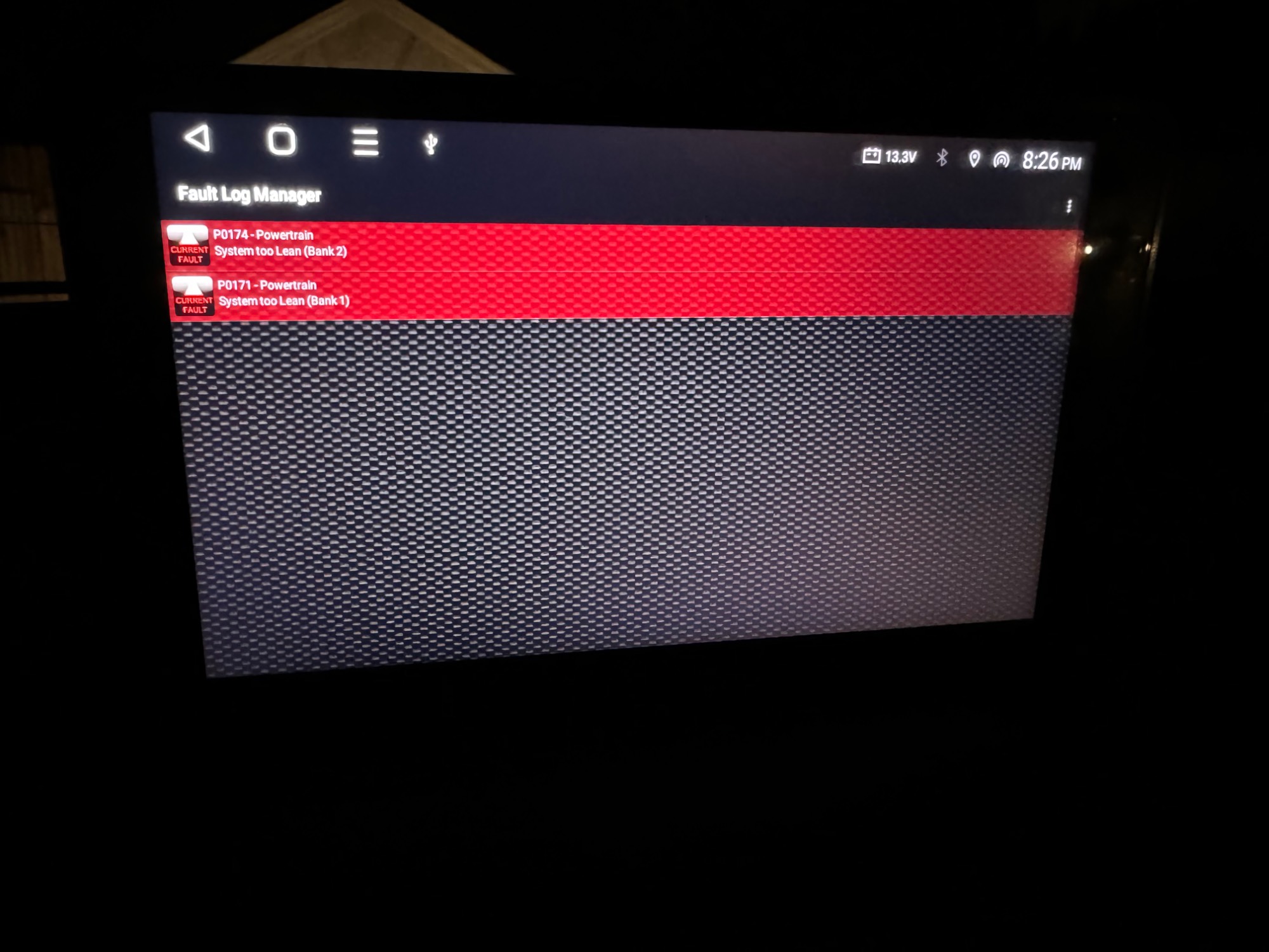

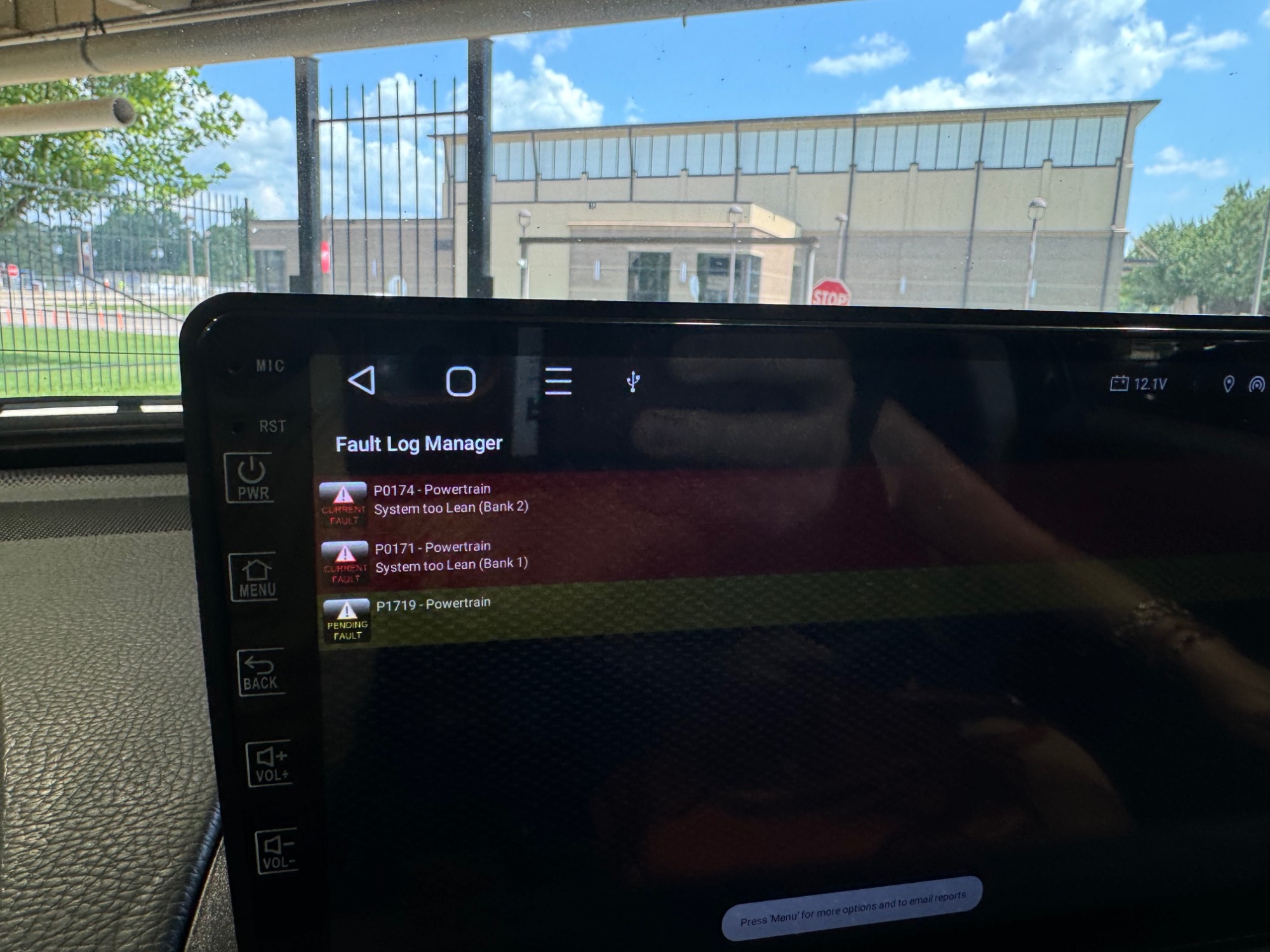

Codes
Codes

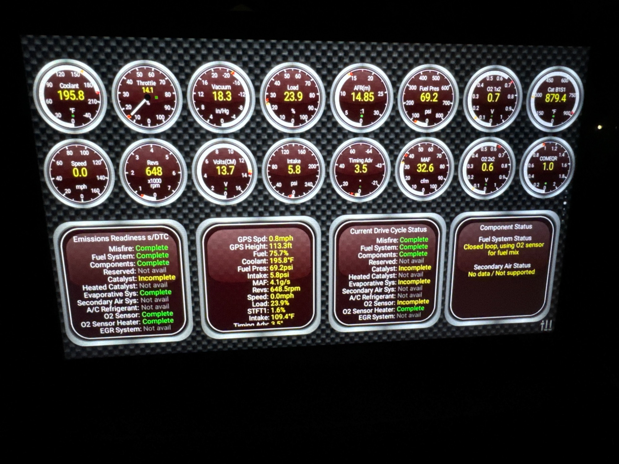

I’m not sure if this could help but here are the engine stats (see photo). If there is a trend or an item not in the cluster you would like to see to help eliminate some of the possible problems let me know and I’ll have the radio pull the data for you.

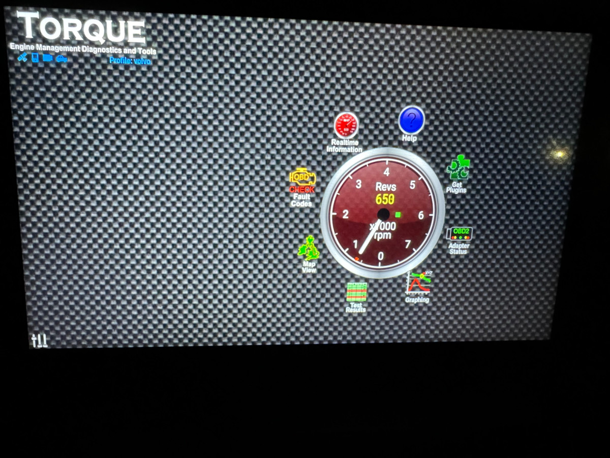

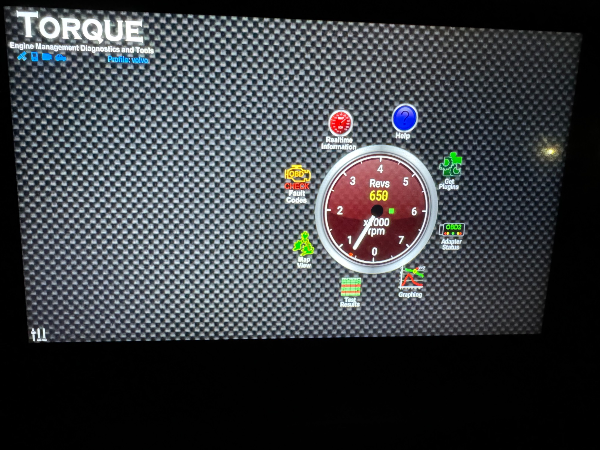

Oh here are my options (see image) for trending etc. Also I just checked and P1719 is not there anymore just the lean bank 1&2 and they are now in red but the car is running as smooth as it was new.
