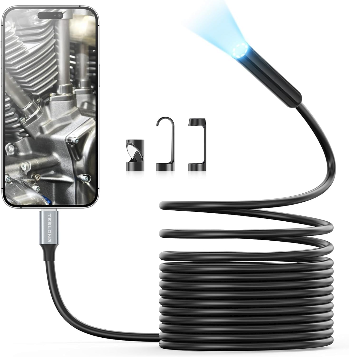

Perhaps something like this Endoscope Light would help with the visuals if you intend to have a look at the oil pickup screen?
Borescope Camera with Light, Teslong USB C Snake Endoscope Inspection Camera with 8 LEDs
https://www.amazon.com/Endoscope-Boresc ... 114&sr=8-8
