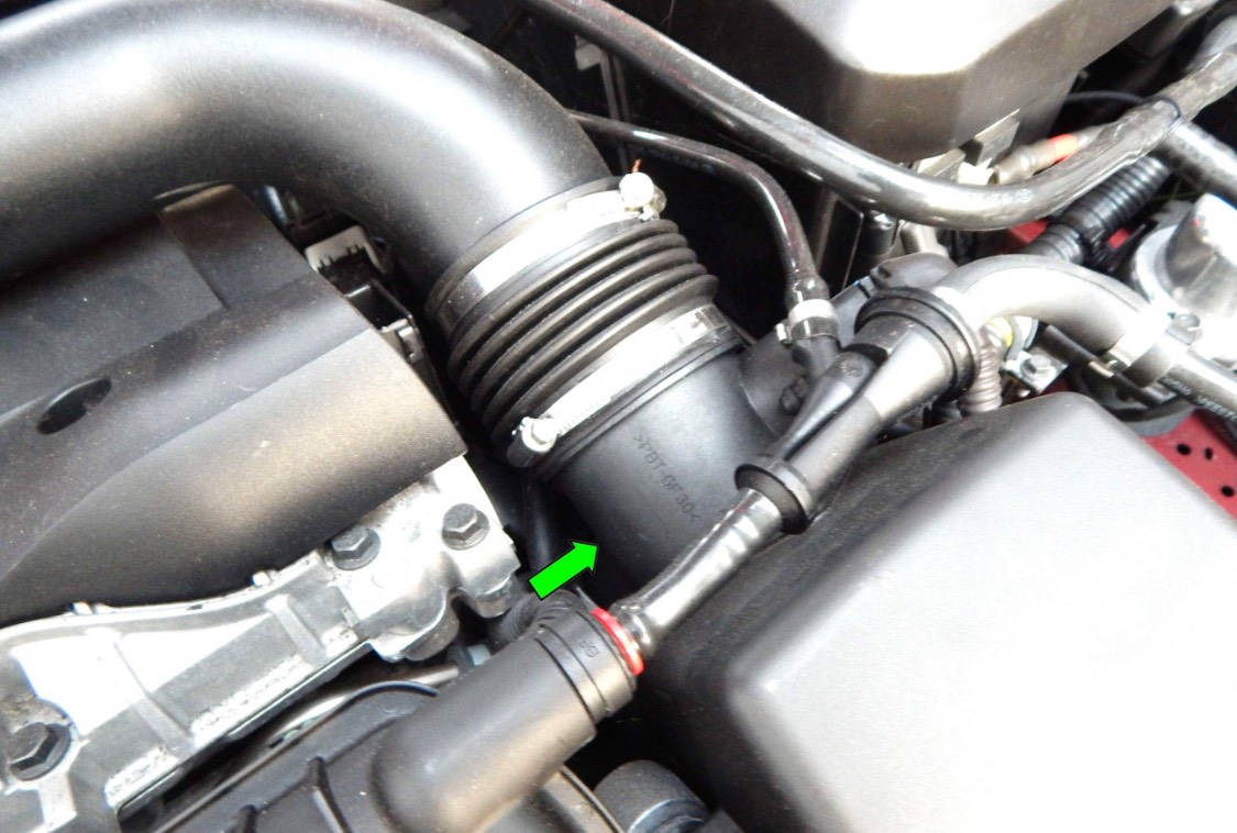

Your C70 will have the same 2.5 turbo as the C30, S40 and V50 of that era if it helps you search YouTube videos.
If you follow air flow into the engine it’ll be right after the air filter housing here:
