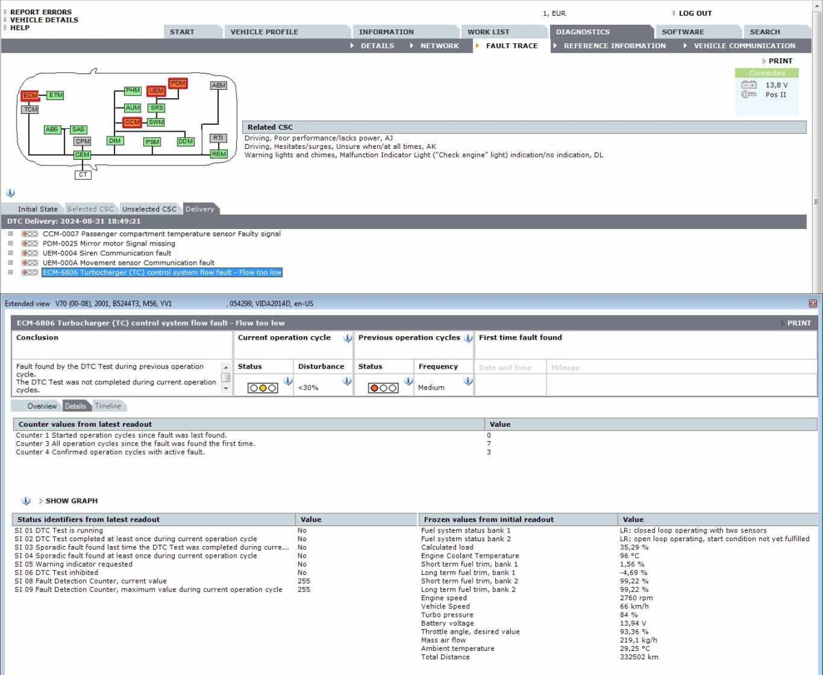

The car feels low on power, likely due to the ECM-6806 error, but that’s not my main concern. The longer the car sits, the harder it is to start. After sitting for a week, it wouldn’t start at all, not even a misfire. I tried push-starting it three times, but the engine wouldn’t catch. Eventually, it started when I turned the key. The wires and hoses under the hood look intact with no visible cracks. The wiring harness going to the coils is in bad shape; the plastic sheathing has deteriorated, leaving some wires exposed, though the engine runs smoothly without any noticeable issues like fluctuating RPMs.
Where should I look? Is there anything I should check with VIDA to track down the problem?

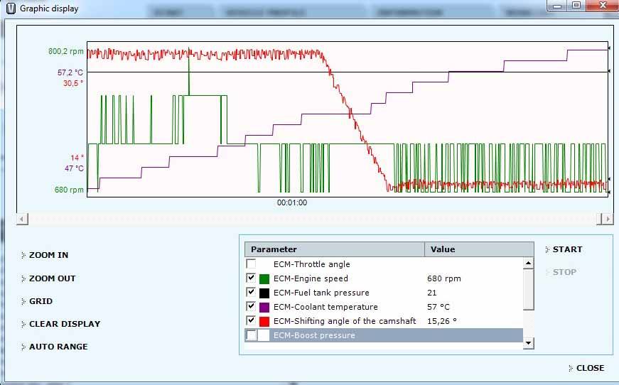

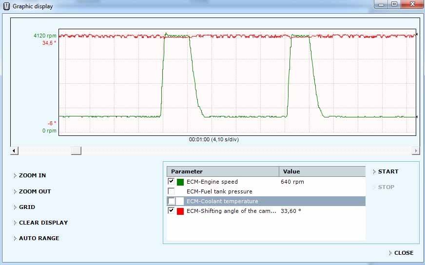

I replaced the VVT sensor. Which of these operation graphs looks correct, 1, 2 or 3? I’ll check tomorrow morning to see if it helped.
  • 1.
  • 2. (without 4000 rpm)
  • 3.

The ETC is working correctly; I checked it with a multimeter, and it shows the proper values. Replacing the VVT valve caused an incorrect reading for adaptation camshaft opening. I'll try another sensor, but this time I'll disconnect the battery terminal before replacing it.
