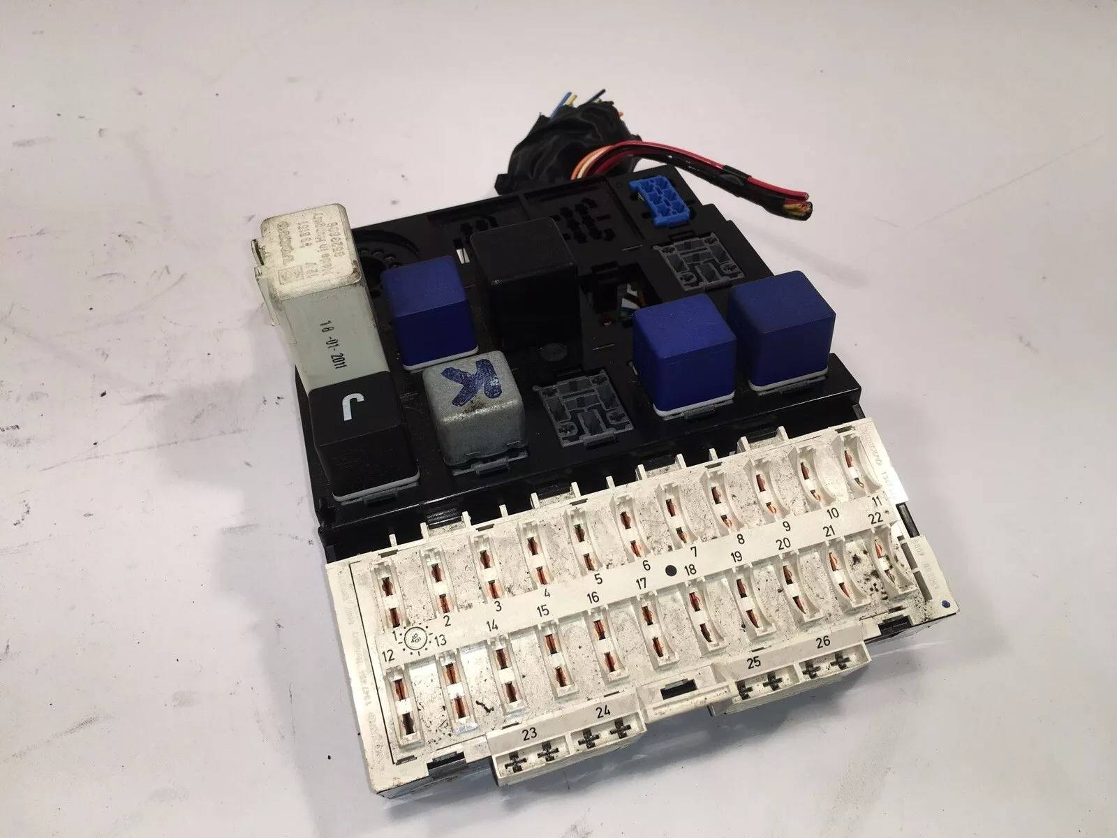

WTB 745 fuse panel (eBay find, entire harness) Topic is solved
- foggydogg
- Posts: 2948
- Joined: 17 October 2009
- Has thanked: 83 times
- Been thanked: 402 times
'86 Turbo. Recent arrival, thought it needed a fuel pump relay, found this Surprise instead.
I'll try to do a search on a year range, this one is a keeper ( I think ) so I'd rather not do a workaround.

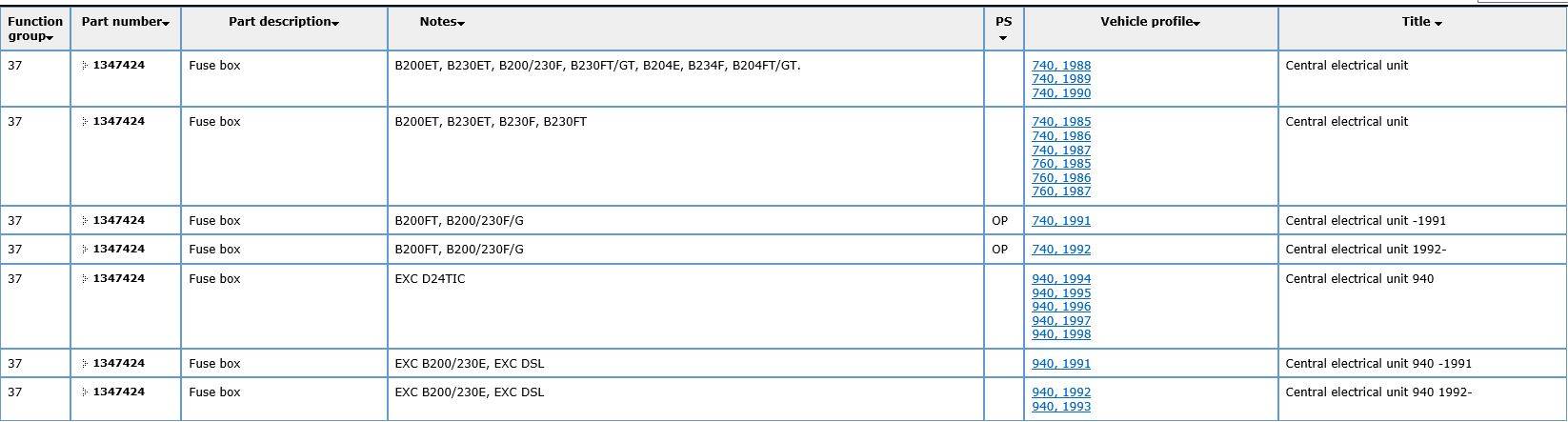

Do you think turbo if different from non turbo? I should have good fuse block for non turbo 1990 745.
lrock
- Posts: 122
- Joined: 26 August 2022
- Year and Model: 2001 v70 xc
- Location: pennsylvania
- Has thanked: 9 times
- Been thanked: 37 times
they use the same fusebox 1347424volvolugnut wrote: ↑07 Nov 2024, 17:26 Do you think turbo if different from non turbo? I should have good fuse block for non turbo 1990 745.

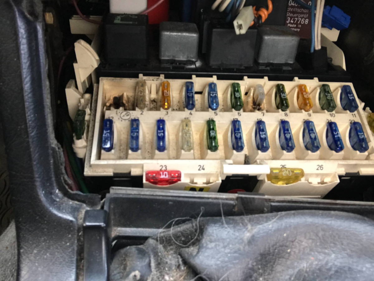

Where is the fuse box hidden? I bought the 745 for parts and am not familiar with it. Is it in driver side foot well?
I need to find it and see if mine is in better condition than yours.
- foggydogg
- Posts: 2948
On this one it's hidden behind the ash tray/cigar lighter; pulling the ash tray exposes the panel, the lighter has to come out to see the relays behind it.volvolugnut wrote: ↑07 Nov 2024, 19:27 Where is the fuse box hidden? I bought the 745 for parts and am not familiar with it. Is it in driver side foot well?
On the '90 760 I got stuck with it's behind a plastic cover on the end of the drivers' side dash.

The relay stuff appears to be intact, and everything else on the car seems to work. It even ran, which is a mystery, but I presume the fuse had enough of a tenuous grip on what was left of the socket to fire the pump relay.volvolugnut wrote: ↑08 Nov 2024, 10:24 I will try to look at in the next couple days. It is raining today and car is at another location.
Do you need the relays?
I don't want to take it apart outside, so I haven't dug any deeper.
The trick to getting the cigar lighter part out is the small square trim piece around the lighter; it pops off exposing two screws ( mine had a non-intuitive aftermarket radio installed, many surprises in that area.)

This is what it looks like in the wild,
Found one on eBay - but it's in England, and I don't think Dr. Abscate is on a parts run this trip.
