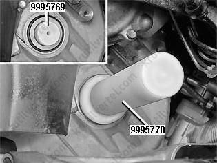

Per Volvo dealer, when installing RH axle seal, their techs use...9995769 and 9995770 tools.
Not sure what 9995769 is (it might be a faked axle shaft so the drift can slide into it, just a guess), but 9995770 is definitely the seal drift tool.
I will make my own tool and report back later...
