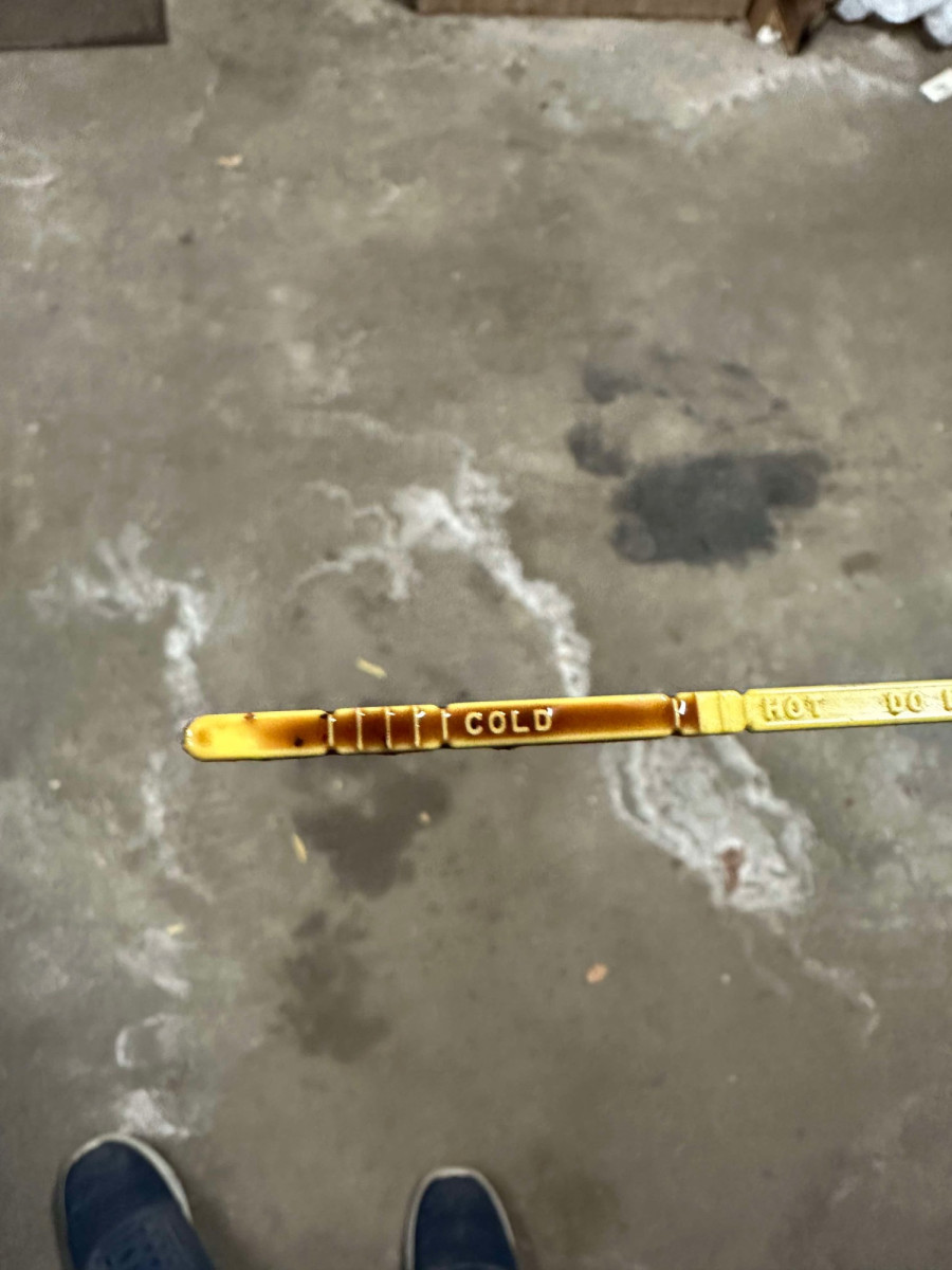

Hi all,
Looking for some insights. I'm currently about to pull the trigger on a 2007 V70 2.4 base. He originally had it listed for $4500 but will come to $4000. The car is a two owner vehicle and has decent service history. My only hang-up is that it has 228k miles on it and the transmission fluid is original. I would be traveling a few hours to pick it up so I can't drive it. The owner assures me it shifts perfectly without any issues. He sent a picture of the dipstick with the fluid on it and said it does not smell burnt. Looks brown with a touch of red.
If I purchase I will drain and refill three times to make sure the fluid is fresh from this point forward.
With this info are my fears warranted? Thank you all.

That fluid does not look good to me.
Suggestions:
Drive about 100 miles between drain and fills to reduce the shock of introducing clean fluids and allow the new detergents to clean the transmission.
Do about seven drain and fill cycles.
Use the best trans fluid you can afford, like Volvo or Toyota.
Suggestions:

I was watching a video earlier from a guy called the Car Wizard. He was covering a 2001 Chevy 1500 truck.
Part of what he was covering was transmission servicing and the fact he will not touch a trans service on one of those with over 200,000km.
The reason behind that was the only thing keeping the auto trans going was all the clutch particles in the oil. Replacing all the oil at higher mileages removes all those particles which were effectively friction adders to the work clutches. Removing those the clutches immediately would start to slip.
So this is a coin toss, and what volvolugnut suggests is definitely the way to go if you go ahead with the purchase. But I would not pay that price for the car in this circumstance.
Good Luck!
Good Luck!

Thank you both for your wisdom and advice. I'm going to listen to you (and my gut) and pass on it. One of the cleaner examples I have seen so it was tempting, but it's not worth taking a $4,000 risk.
