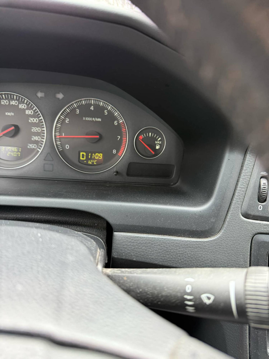

I live in Canada where the temperature the past week has been consistent snow, flurries and an average temp of -12C. I would turn on my car and let it warm up for about 5mins. The real issue starts when I'm driving. Sometimes when the anti-skid activates, whether I am sliding through turns or just regular wheel spin after a stop, my fuel gauge drops to empty and I lose my brake lights. The rear lower running lights, turn signals, and reverse lights still work, but my top brake lights and third brake light in the spoiler don't work.
I have already checked all my fuses, the brake light shunts and relays. This issue is intermittent and comes and goes. No error codes on the dash. In my 2004 model, I do not have the button to disable the DTSC on my center console (unfortunately). Everything will return to normal after a couple minutes of driving. Any Ideas anyone? Thanks for all the help!
My 2004 Volvo V70
My 2004 Volvo V70
The fuel gauge magically going to 0 while wheel spinning after a stop
