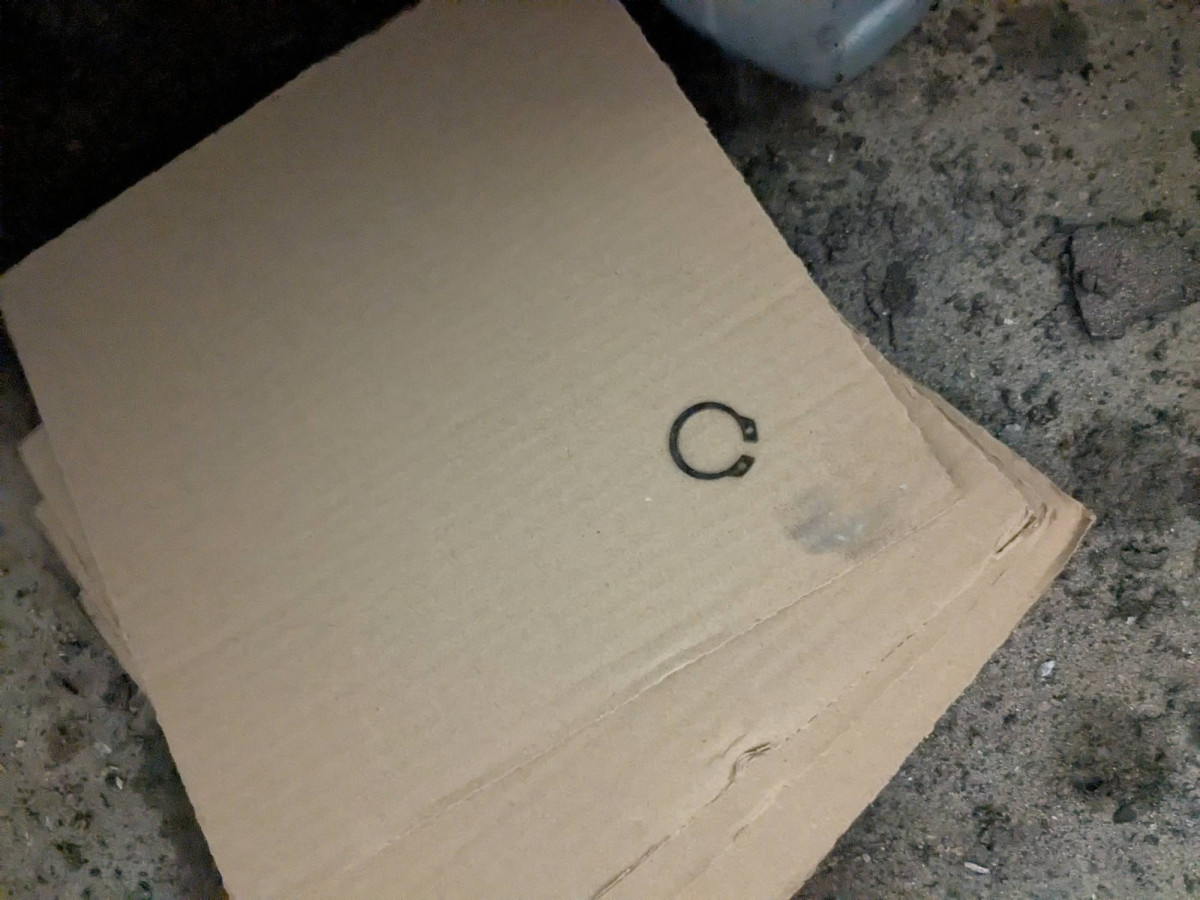

While hammering, a lock ring fell off some part of the rear axle/hub/shock etc. Thoughts on where it fell from?
