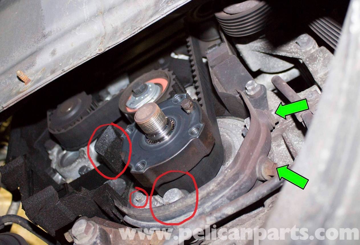

On my 99XC70, I did the twist and slide method. It wasn't easy especially since it was my first time doing it. It seemed counterintuitive but when I inserted the belt, the ribs were facing out as I was trying to slide the belt up the gap. What helped was knowing were the pinch points are. Take a look at this photo and imagine the obstructions as you're trying to wrestle the belt in there. Of course, you need to remove the guard first.

That’s the RN engine above where it is near impossible with the harmonic balancer on.
